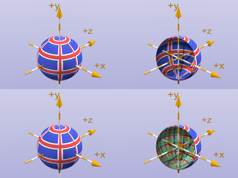

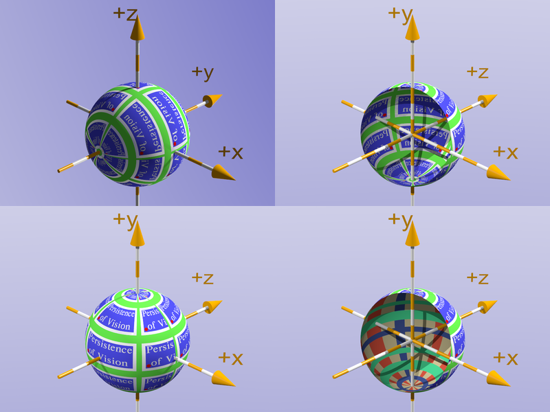

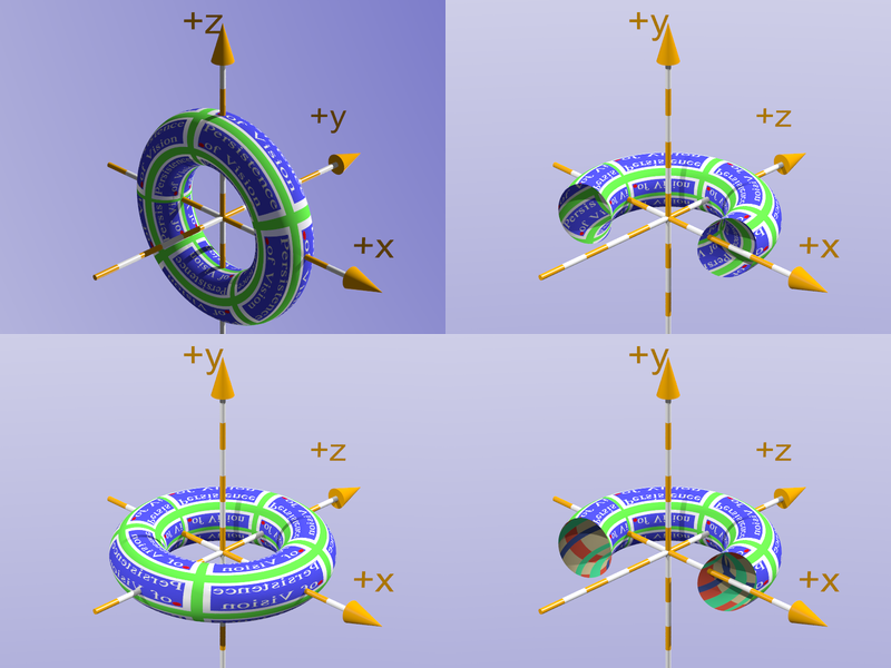

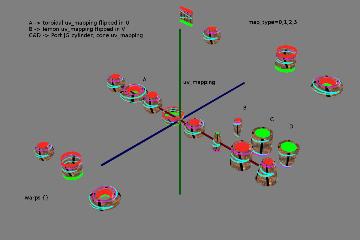

In working to port Jérôme's new cylinder and cone uv_mapping to the
3.7.1 master branch, I found the mapping to be upside-down (V flipped)
to what I expected.
I decided to look at all(1) the uv_mapping, map_type image mapping and
warp based mapping to see where things stood. I found the torus
uv_mapping flipped left-right (U flipped) and the just added lemon also
flipped in V but everything else having a consistent orientation. See
the attached figure.
A github pull request #131 has been submitted for Jérôme's cone and
cylinder uv_mapping except flipped to the usual V orientation and as
shown in the figure.
I'll work on updates & pull requests to align the lemon (B) and torus
(A) uv_mapping, but I'll wait a day or two should there be other opinions.
Bill P.
(1) - Except the box/cubic mapping.
Download 'mappings.jpg' (110 KB)
Preview of image 'mappings.jpg'
From: Le Forgeron

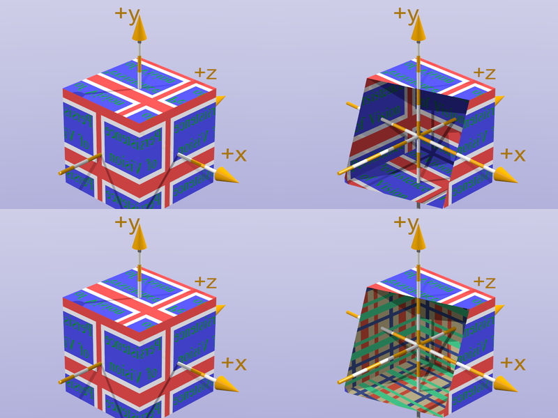

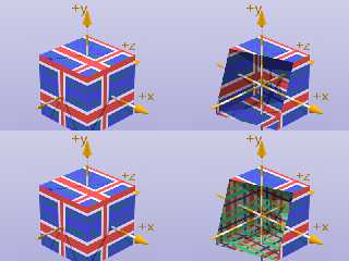

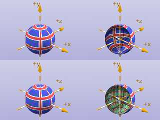

You should also have a look at box uv_mapping... it's strange too.
You can read it from the inside.
I will investigate each object uv_mapping of hgpovray later, and might
change it (in term of flipping).
Target: being able to read the text on an image. The same image, on all
objects
Download 'refimgobject_sphere.png' (533 KB) Download 'refimgobject_box.png' (729 KB) Download 'environment.inc.txt' (4 KB) Download 'clipped_oriented.pov.txt' (3 KB)
Preview of image 'refimgobject_sphere.png'
Preview of image 'refimgobject_box.png'

From: William F Pokorny
Subject: Re: Some existing uv_mapping flipped. Porting Cylinder, coneuv_mapping.
Date: 26 Oct 2016 11:43:58
Message: <5810cf3e$1@news.povray.org>
On 10/25/2016 12:55 PM, Le_Forgeron wrote:
> objects
Yes, I ignored that mapping for being textures by face at least in terms
of the cubic pattern(1) and I've always thought of the box uv/warp
{cubic} mapping more in terms of what is needed for each pyramidal
mapping of a face looking toward the origin. In other words I think
about this mapping as if we have multiple sub-uv maps per box face.
That said, we could I think, get to where an image/pattern as viewed  on
a plane would map more naturally onto the box as if wrapped in U like
other patterns.
I'd say we take starting and ending mid face on the +X face out of
consideration, but keep the idea of the map starting/ending on the +X
face to better match our other maps. Are you then thinking of folding
from +x backward for Y top/bottom using a map something like this?
Ymax
Xmax Zmax Xmin Zmin
Ymin
Suppose a significant amount box-uv/warp{cubic} mapping in scenes. Add
an alternate box mapping? What is the complexity of another box mapping
compared to mirroring in U(x) the pattern/image prior to
box-uv_mapping/warp {cubic}...
Aside: I've used stand alone scripts & more recently a couple
user_defined cameras for creating box uv/warp{ cubic } image maps(2).
Bill P.
(1) - I admit I've never used the cubic pattern other than by side
effect in someone's scene file.
(2) - Partly aiming for flat image_map interpolation that works better
through the box/cubic folds on the open edges of the mapping.

Ok, current state of hgpovray:
(did I forget any object ?)
left handed
bicubic_patch
lathe bezier (start +x, go +z)
lathe cubic (start +x, go +z)
lathe linear (start +x, go +z)
lathe quadratic (start +x, go +z)
sor (start +x, go +z)
sphere (start +x, go +z)
sphere_sweep (b )
sphere_sweep (cubic)
sphere_sweep (linear)
right handed
box (wrapping)
cone (start +x, go +y)
problem
cylinder (right handed, start +x, go -y)
lemon (right handed, start +x, go -y)
ovus (right handed, start +x, go +z, bottom ?)
torus (right handed, start -x, go +z)
strange (interior/exterior)
parametric (left handed, strange)
prism bezier (strange)
prism cubic (strange)
prism linear (strange)
prism quadratic (strange)
mesh (strange)
not mapped, but no problem
blob
disc
isosurface
julia_fractal
plane
polygon
polynomial
smooth_triangle
superellipsoid
text
triangle
height_field
The historical uv-mapping of the torus is not similar to the sphere, in
regard to the starting axis and handness.
The sphere_sweep is extending the u axis along the sweep, similar to the
torus along the major circle, so should be kept.
the bottom face of prism is not the correct texture for interior vs
exterior (compared to similar topological object like sphere)
(And hg-povray already got a correction for text object on that)

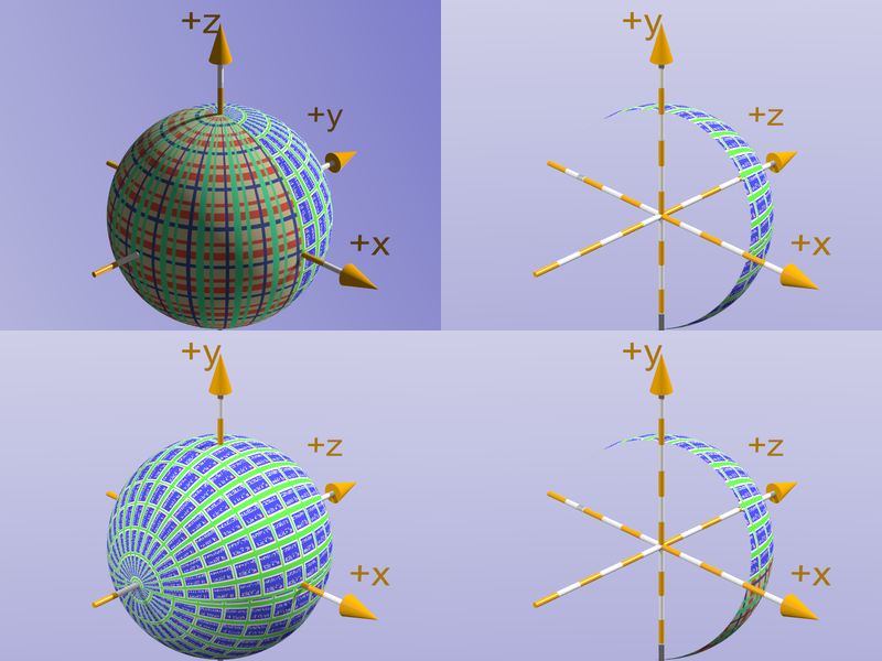

The mesh & parametric are screwed:
* cannot be predicted for interior vs exterior
* parametric with a continuous surface changes interior & exterior in middle
* parametric are not reporting all intersections and hole appears when
clipped or intersected
Download 'refimgobject_parametric.png' (747 KB) Download 'refimgobject_sphere.png' (669 KB) Download 'refimgobject_torus.png' (634 KB)
Preview of image 'refimgobject_parametric.png'
Preview of image 'refimgobject_torus.png'
