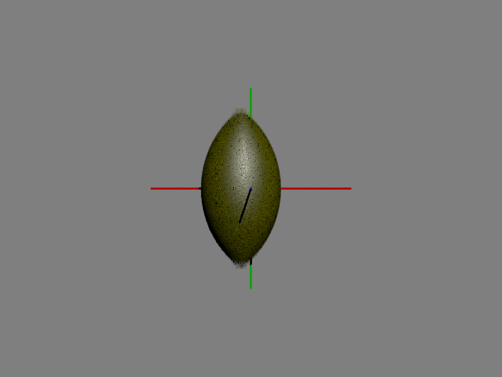

Running your scene with my current development povr code, and without
sturm(a), I get the attached a result.
Bill P.
(a) - With sturm on I get a tiny nub on the ends bringing the height to
to about where the left and right shapes are. Without it it 'looks' like
the shape is a little more rounded at the ends than your equivalents.
Might be there is still some other numerical stuff going on... It's not
the easiest shape for the solvers.

On 3/11/23 23:47, William F Pokorny wrote:
> It's not the easiest shape for the solvers.
Ah, and you are using an orthographic camera. This often the worst case
ray set up for the solvers. Other shapes like the sphere_sweep have
similar issues with the orthographic camera. Your' also positioning well
away it looks too.
If I step an ortho camera back just -2 in z and code as the lemon:
#declare r = 1;
#declare R = 0.6;
#declare Y = sqrt ( r*r - R*R );
lemon {
   <0, -Y, 0>, 0, <0, Y, 0>, 0, r
   texture {pigment {rgb <0.2, 0.2,0>} finish {specular 0.4}}
   sturm
   translate <-.1,0,-.1>
I get the attached image.
The ray length matters in that the longer it travels the more the
accuracy of the ray->surface equation degrades in accuracy. The equation
has to represent all those useless potential landing steps on the way to
the shapes surface and this burns up the floating point accuracy.
That bit was my painful discovery discussed in the previously referenced
github issue. I have a solution for best possible floating point
hardware accuracy, but the implementation is not trivial...
Bill P.

On to the trivial solution.
Spindle torus, did you say?
"The merge and intersection spindle modes have long existed with the f_torus,
but via value arguments."
Well, they've long existed for the regular torus primitive too.
Which I had discovered, and therefore "knew", but forgot.
http://news.povray.org/povray.binaries.misc/message/%3C604613ed%241%40news.povray.org%3E/#%3C604613ed%241%40news.povray
.org%3E
https://wiki.povray.org/content/Reference:Torus
and so, adding
torus {R, r intersection texture {pigment {rgb z} finish {specular 0.4}}
translate x*2*r}
gives me just what I was looking for.
"Oh, POV-Ray developers, you understand everything!"  :)

My only experience using orthographic & angle was first setting up a
perspective view of solver test cases - where the camera needs be a
significant distance away with smaller angles. Then I'd flip perspective
to orthographic to get the, much harder for ray->surface equations and
solver, ortho rays as another test case. For me all I did was flip the
camera types... I've got no experience with more.
Where the documentation says:
"Note: The length of direction is irrelevant unless angle is used." is
true only in an abstract sense. While not the direction vector length,
the actual length of the ray in that direction absolutely matters with
respect to how well many shapes work.
If I take my earlier Camera01z set up and change the location to be:
location <0,0,-2*1e3>
I get the attached image of the same identical scene. The ray length
went from ~2 to ~2000.
Bill P.

I'm thinking some about this and unsure how to do it in any general way
that would not often raise false alarms.
I'll write more about accuracy stuff here so folks are not left too
'depressed' about higher order inbuilt shapes like the lemon. ;-)
Attached is another image with three shapes left to right where the
orthographic camera is again pulled back about -2000 from the origin
where the shapes sit. In fact even -2e6 is no problem.
The middle and right shapes are an isosurface, f_torus 'intersect'
spindle and on the right is the torus 'intersect' spindle. A good
question is why do these shapes seem to be immune to the camera set back
(to the long ray length)?
The answer is both shapes have low order container shapes which are in
fact the first intersection. The isosurface shape uses either a box or a
sphere(a) which users specify as the container. The torus internally
creates a bounding sphere which is the first intersection(a).
On the left is again the lemon, but now it works! It does because I did
this:
union {
     box { -1,1 pigment {rgbt <0,0,0,1>} } // <--- low order bounding(a)
     lemon {
     //sturm
     translate <-.7,0,-.1>
Bill P.
(a) - This kind of outer bounding certainly helps and is often a decent
work-around, but it is not a general solution. For example, when the
shapes themselves are large (big interior) - as the ray->surface
equation and solvers see the shape. Or where the type of csg forces the
from camera intersections.
The union, clear, first shape bounding can also introduce issues /
artefacts with other shapes in the scene because that invisible surface
exists in the scene.
Aside: An attractive argument for representing all shapes with low
order, mesh approximations is those low order (simpler) ray->surface
equations tolerate MUCH longer ray to surface distances on cpu float
hardware.
Download 'behmmisotorusspindle.png' (77 KB)
Preview of image 'behmmisotorusspindle.png'
