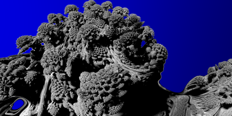

See below code from my GPU mandelbulb renderer that calculates the
distance function at a point, if it's any help:

I don't pretend at all to have derived the distance equation, or even
understand how/why it works (or even have coded it correctly). But I did
get stuck in a similar situation to you when writing my GPU-based
isosurface renderer, and found the solution so thought I'd share. It
seems to work ok (see attached) so I stuck with it without
investigating/optimising further.
