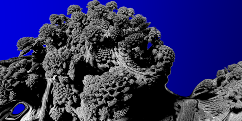

I don't pretend at all to have derived the distance equation, or even
understand how/why it works (or even have coded it correctly). But I did
get stuck in a similar situation to you when writing my GPU-based
isosurface renderer, and found the solution so thought I'd share. It
seems to work ok (see attached) so I stuck with it without
investigating/optimising further.

Looking at your very nice result and inspecting your code I think that you have
implemented the formula properly.
And I learned that one can post images to this group. Despite the fact that the
web front end states "You may not post attachments to this newsgroups". How did
you achieve this, Thunderbird?
