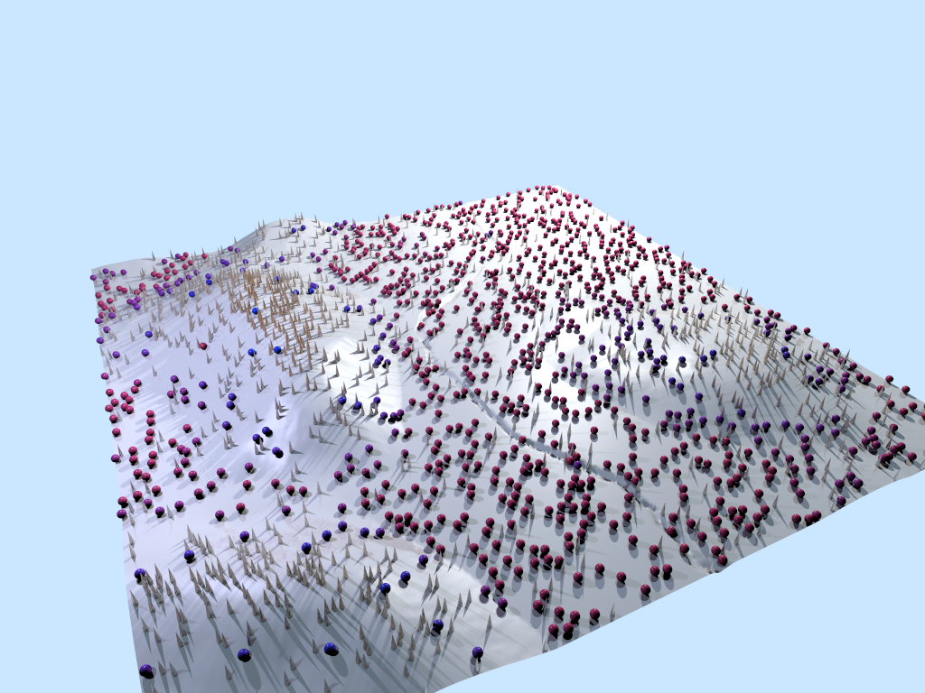

From: Mike Horvath
Subject: Re: Need a script to randomly scatter objects vertically
Date: 21 May 2021 04:02:41
Message: <60a76921@news.povray.org>
This version generates a heightmap from the original vertex data, that
is then fed into the main script. I think I made some small tweaks to
the probability functions too. I am pretty happy with the results.
Mike
Download 'clutter_005.zip' (1673 KB) Download 'makescene.png' (650 KB)

Date: 21 May 2021 08:06:59
Message: <60a7a263@news.povray.org>
Op 21-5-2021 om 10:02 schreef Mike Horvath:
This looks very good!
From: Mike Horvath
Date: 25 May 2021 13:44:55
Message: <60ad3797$1@news.povray.org>
Thanks! Jonathan Rafael Ghiglia created an awesome script!
Mike

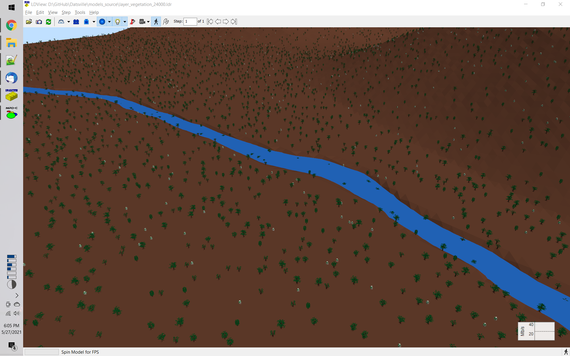

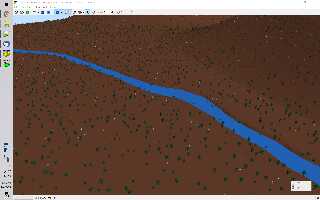

From: Mike Horvath
Date: 27 May 2021 18:09:41
Message: <60b018a5@news.povray.org>
Screenshot after importing the generated coordinates into LDraw.
Mike
Download 'ldview_screenshot_024.fs.png' (792 KB)
Preview of image 'ldview_screenshot_024.fs.png'
