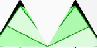

Your right! Thanks for the help. I was trying to rotate from the center
of the box contanting the triangle.
I now use the more percise .5*tan(radian(30)) for the y adjust.
Also I had the y componet added to the whole function:
Fnc=function(x,y,z,Ang){Fna((x-.50)*cos(Ang)+(y-.433)*sin(Ang)+.50,
                      -(x-.50)*sin(Ang)+(y-.433)*cos(Ang),1)+.433};
                                                         |    This
                                                     Should be here
But now that's taken care of, I get a nice little cracks. (picture attached)
Have fun!
