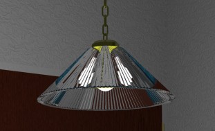

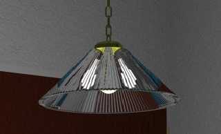

Hi all.  I took a quick look at the code fragments here and have wondered if
anyone has seen the same thing I have.
In the code, it appears that there is a bounding object for just about every
single difference object.  On top of that, what does the bounding object
consist of?  A simple box, sphere or something more complex?  I guess it
would help to see the actual code.  But the thought I have is it looks like
there is about as many bounding objects as there are primitives.  If this is
the case, here goes:
In the case of bounding, more bounds is not a good thing.  If your checking
a high number of bounding objects, the speed difference, between that and
just checking if you've hit the object itself, is lost.  I had a similar
problem with a simple lamp (a small part of the scene is attached).  It's
not a recursive object by any means, but it's simply a cone shape cut with
another cone offset and then about 210 long boxes to cut out ribs.  The
texture is 95% transparent with an IOR about 1.25.  The only light source in
the scene is in the lamp.  Cutting the shapes into the lamp shade drove the
rendering time up from 4 hours to about 21 days!
What I found in my case was this (I THINK my analysis is right, if not say
so!! ;)  CSG's are automatically bounded by POV by default. This meant that
whenever a ray hit the bounding box the ray would be checked against every
primitive inside the box. In my case that's 212 objects, plus an IOR.  This
meant that I had to come up with a better bounding scheme.
Putting a bounding object around every box that cut a rib would not
eliminate the problem because it would just be checking 210 bounding boxes.
No speed gain there.  The solution was to:
        - Turn off POV's automatic bounding.
        - NOT bound the entire shade in a box
                there is a light in it and all rays will hit it anyway!
        - Group a bunch of adjacent ribs together with a union and then
bound that union with a box.
In my lamp there are 210 ribs in 10 groups of 21.  This way a ray will be
checked against a maximum of 10 bounding boxes and then a maximum of 23
primitives (not counting IOR of course!)  The tracing time went from 21 to
5.5 days.

bounding object is then tested for intersections with ALL the objects making
up the CSG object.  If nested CSG objects making up the object are bounded,
however, POV-Ray tests the ray against the bounds for the nested objects
before deciding which component objects to check for intersections with the
ray.  This is why your multiple bounding objects in the picture will cause
it to render faster.  POV-Ray is very good at automatically generating the
needed bounding box hierarchy for unions, but sometimes has trouble with
intersections or differences, which is why user bounding of these objects
sometimes speeds things up.
Hope this clarifies things.
Mark

On Wed, 11 Aug 1999 11:34:31 -0400, "Dave Kreskowiak"
>5.5 days.
  Hi, Dave. Interesting read. Reminded me of a simple poker chip I made
(code is long gone) and now I wonder how it would've looked using a glass
texture.
  OT, thanks for the nice lampshade image. You might consider posting images
in the povray.binaries.images group and then pointing us in that direction
with your post. We'll look there. It just helps a bit to keep some
smattering of organization when, three months down the road, we scratch our
heads trying to remember where we saw this beautiful crystal lampshade.
Thanks much.
Alan
