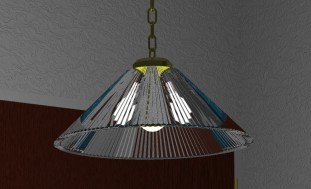

  I have a scene rendering that has been going now for 24 hours. It has
several levels of recursion and has deeply nested CSG operations. To
decrease the rendering time I added manual bounding to the differencing
objects. This gave me a decent increase of rendering time at 1 level of
recursion when I was testing to see if manual bounding would help.
  However since I bumped the recursion level up to a depth of 5 my
render time has decreased to a point of being unacceptable and I am
likely to stop my current session and just give up on it. I calculate
at it's current rendering rate of 4 hours per line with 412 lines to
go it will take 69 days to finish. My question then is should I turn
automatic bounding off when manual bounding has been used in the scene
file or will the manual bounding simply override any automatic bounding
that would normally occur ?
  In my current bounding scheme I have the objects that are subtracting
from the original shape bounded individually and I have also bounded the
shape that is being differenced. Another question would be is when to bound
a shape in an operation for optimum performance. There are often several
ways of adding bounding and I am not sure when or where it should be
applied. Will manual bounding at the wrong place hurt the process when
a certain number of csg operations if reached as opposed to being an aid
in a simple operation ?
 I would be more than happy to post the source for anyone willing to look
at it but it is a bit lengthy to add to this post without first seeing an
interest in it.
A skeleton example of the bounding scheme I am currently using is:
// the cutting objects
#declare Diff_shape =
intersection {
      object { obj1 }
      object { obj2 }
  bounded_by {
      object { obj3 }
// bound the cutting shape
#declare Diff_Shape_bound = object { Diff_Shape }
// The shape being cut
#declare Diff_Obj = object { obj4 }
// A bounding shape for the shape being cut
#declare Diff_Obj_Bound = object { Diff_Obj }
Then I have a complicated recursive while loop to difference the Diff_obj.
// The differencing operation
#declare Final_Shape =
difference {
Loop stuff
    object { Diff_Obj }
     union {
bounded_by {
    object { Diff_Shape_bound }
#end loop stuff      }
// And finaly bound the entire object after the difference operation.
    object { Final_Shape
bounded_by {
    object { Diff_Obj_Bound }
Is this complicating things overly much ? It really seemed to help when I used
lower recursion depths but when going higher it has basicaly stalled out.

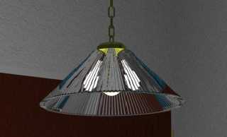

Hi all.  I took a quick look at the code fragments here and have wondered if
anyone has seen the same thing I have.
In the code, it appears that there is a bounding object for just about every
single difference object.  On top of that, what does the bounding object
consist of?  A simple box, sphere or something more complex?  I guess it
would help to see the actual code.  But the thought I have is it looks like
there is about as many bounding objects as there are primitives.  If this is
the case, here goes:
In the case of bounding, more bounds is not a good thing.  If your checking
a high number of bounding objects, the speed difference, between that and
just checking if you've hit the object itself, is lost.  I had a similar
problem with a simple lamp (a small part of the scene is attached).  It's
not a recursive object by any means, but it's simply a cone shape cut with
another cone offset and then about 210 long boxes to cut out ribs.  The
texture is 95% transparent with an IOR about 1.25.  The only light source in
the scene is in the lamp.  Cutting the shapes into the lamp shade drove the
rendering time up from 4 hours to about 21 days!
What I found in my case was this (I THINK my analysis is right, if not say
so!! ;)  CSG's are automatically bounded by POV by default. This meant that
whenever a ray hit the bounding box the ray would be checked against every
primitive inside the box. In my case that's 212 objects, plus an IOR.  This
meant that I had to come up with a better bounding scheme.
Putting a bounding object around every box that cut a rib would not
eliminate the problem because it would just be checking 210 bounding boxes.
No speed gain there.  The solution was to:
        - Turn off POV's automatic bounding.
        - NOT bound the entire shade in a box
                there is a light in it and all rays will hit it anyway!
        - Group a bunch of adjacent ribs together with a union and then
bound that union with a box.
In my lamp there are 210 ribs in 10 groups of 21.  This way a ray will be
checked against a maximum of 10 bounding boxes and then a maximum of 23
primitives (not counting IOR of course!)  The tracing time went from 21 to
5.5 days.
