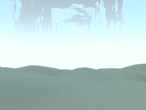

Attached is a small picture which shows what happened when I tried to create
clouds using media. I get a box with  texture mapped onto the outside of it
...is this correct because I expected to find the box filled with the media.
If this is the correct behaviour can anyone suggest how I can get the effect
I want?
Mick

Could we see some code? It is hard to tell what is wrong without seeing
it.
Also, the image should have been posted to povray.binaries.images, and
just referred to in a message here.
Chris Huff

#declare Col = 0.01;
#declare K = color_map {[0 rgb 0][.2 rgb 1][.5 rgb .7][1 rgb 1]}
box {-<50000,0,500>,<50000,100000,1000000>
pigment {rgbf 1}
    interior {
        media {
            scattering {2, rgb Col extinction 1.5}
                    method 3
                    jitter 0.0
                    intervals 1
                    samples 3,3  file://was .9
                    aa_level 3  file://was 4
                    aa_threshold .1
            absorption rgb Col/5
            file://emission .005
            density {
            boxed
            octaves 9
            lambda 2.3
            omega.575
            turbulence 3
            scale 155000
                color_map {K}
            hollow
            translate y*4000
#end
fog {distance 950 rgbf <7,9,10,.25>/7.5 fog_type 2 fog_offset 200 fog_alt 1
turbulence .75}
> turbulence .75}
Have you tried it with the fog turned off. I have had problems in the past
with fog interfering with a media container and the media inside. Problem
is that fog will enter a hollow container and I know of no way around this
problem.
I can't test your code right now as I am working on something else at
the moment.
Wishing you Seasons Greetings, A Merry Christmas, and A Happy New Year !

Those dimensions are huge. Are you sure you need a box this big?
I think the problem is the line "samples 3, 3". All the samples end up
being taken at the edges of the box instead of the middle, so you see
the box shape instead of the media shape. Try increasing the number of
samples by a lot.
And remember that you can change the order of the turbulence transform
relative to the other transforms by enclosing it in a warp {...}
statement. This might be useful.
Chris Huff
e-mail: chr### [at] yahoocom

It looks like you need more samples and add some jitter.
Ingo

Oh, and also start with a unit-sized box, and scale/translate it to what
you want, and try without the fog. And with large uninterrupted areas,
put transparent partitions to divide up the media intervals. Don't
forget to increase max_trace_level for this.
Chris Huff
