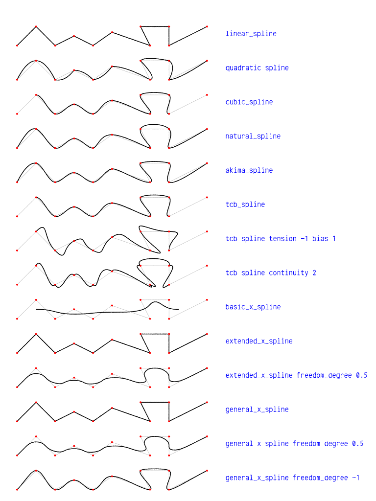

Change your spline, get a x spline (basic, general or extended) or a tcb
spline and adjust some parameter with the damage level.
Download 'splines_ref.png' (72 KB)
Preview of image 'splines_ref.png'

Hmm. Tcb and General X Spline do both look real interesting. Now to hunt
down formula on them I can bloody understand. lol

You might get some code in the sources of megapov. (have a look at
sources/patches/patches.h )
Attached is a document about x splines.
Download 'xsplines.10.1.1.44.5770.pdf' (283 KB)

Think I might have found something that will work. Just need to run
things the same as I did in my code, which only handles 4 points at a
time, so I could, in principle, change points as needed, like if the
thing got called some place else, while wandering.
