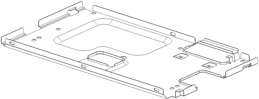

From: scott
Subject: Re: My toy
Date: 3 Mar 2009 04:56:21
Message: <49acfec5@news.povray.org>
> Some pretty insane technical drawings happening in there! ;-)
> (I wonder how they do that BTW. Must be quite a challenge to draw
> something that complex...)
You don't draw it by hand, the CAD software will draw it based on the 3D CAD
data.  You simply set the view mode to wireframe with hidden edges,
orthographic projection etc and then save as a PNG at whatever resolution
you desire.  Takes about 30 seconds, see attached.
Actually making the 3D CAD data is not really a challenge, the software is
designed with drawing things like this in mind, so there are lots and lots
of features to make your life easy :-)
Download 'image1.png' (19 KB)
Preview of image 'image1.png'
From: Invisible
Subject: Re: My toy
Date: 3 Mar 2009 05:12:51
Message: <49ad02a3$1@news.povray.org>
Well, not unless you're *insane* at least... ;-)
> CAD data.  You simply set the view mode to wireframe with hidden edges,
> resolution you desire.  Takes about 30 seconds, see attached.
So... is something like this drawn from the real manufacturing data that
the plant uses? Or do they build specialised models simplified for
display purposes?
> is designed with drawing things like this in mind, so there are lots and

scott wrote:
> see attached.
That's pretty mental, by the way. But what the hell *is* it??
Also... how do you make something like that? It looks like you'd either
have to mould it, or take a sheet of metal, bend it around a bit, cut
windows and drill holes in it...
