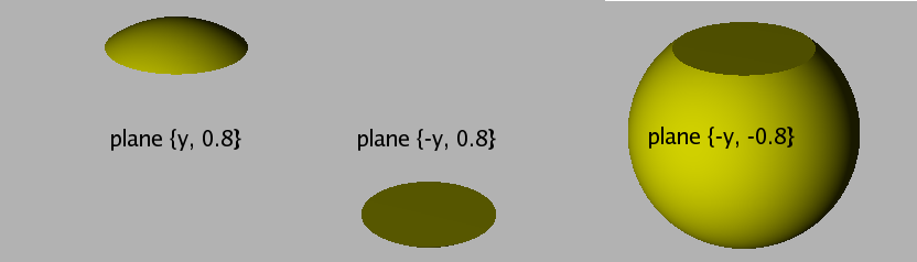

The key here is that, for CSG, the "inside" of a plane is the side
_opposite_ the normal.  Also, the second parameter in the plane is the
distance from the origin _in the direction of_ the normal.  (Plus, as
others here have pointed out, be sure to use the commas in these
expressions.)  IOW:
      difference {
         sphere { 0, 1 }
         plane { y, 0.8 }
         texture { Whatever }
gives you the top "cap" of the sphere, and plane { -y, 0.8 } gives the
same "cap" but from the bottom of the sphere.  What you're looking for
is plane { -y, -0.8 }.  See the attached illustration.
Hope this clarifies things.    :-)
      -=- Larry -=-
Download 'diff.png' (19 KB)
Preview of image 'diff.png'
