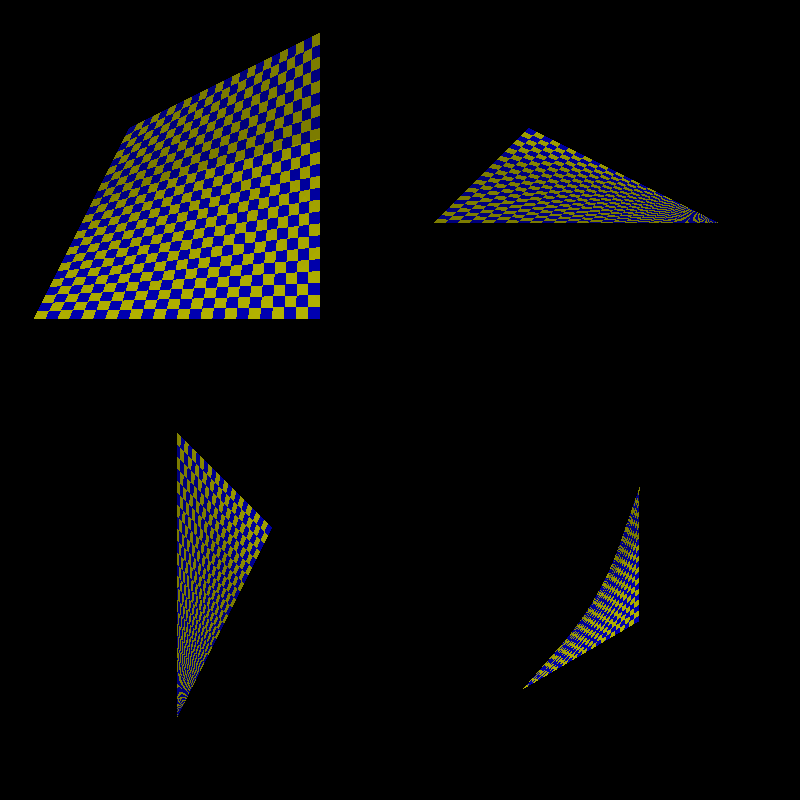

Ok, then I have a simpler solution, but not without my extension:
a Nurbs of size 2 , hence also of order 2.
Nurbs points need a weight (fourth coordinate) but it's easy to use the
same weight (1) for all 4 3D points.
The perimeter is A-B-D-C-A, update for your own 4 points.
#declare A =<0, 0, 0, 1>;
#declare B =<3, 0, 0, 1>;
#declare C =<0, 3, 0, 1>;
#declare D =<2, 2, 1, 1>;
#declare UVMeshableObject = nurbs { 2, 2, 2, 2
  0, 0, 1, 1
  0, 0, 1, 1
  A B
  C D
#declare Texture = texture { checker texture { pigment { color blue 1 }
} texture { pigment { color rgb <1,1,0> } } }
#include "NurbsMesh.inc"
#declare UResolution = 32;
#declare VResolution = 32;
mesh {
     UVMeshable( UVMeshableObject, UResolution, VResolution )
     texture { uv_mapping Texture scale <1/24, 1/24, 1> }
Download 'four.png' (42 KB)
Preview of image 'four.png'

fillet between two surfaces if they were meshes.  Maybe that's a way to go.
And now that I've gotten this far (only 1/2 a cup of coffee in, folks!) maybe we
can just blob together two isosurface planes.
*And now, just writing that about the tube - one should be able to take a box,
and align a face of it with 3 of the points, and then just slide it over so that
another face is coincident with the 4th.  Then you could use an inverse rounded
box.
From: Bald Eagle
Subject: Re: plane through 4 points
Date: 1 Jun 2019 20:25:00
Message: <web.5cf316ed57960f354eec112d0@news.povray.org>
maybe we
Yep, that works.  It's not plug-and-play level, but it works for the simple
points that I started with.  I'll play a bit more and post in pbi.
