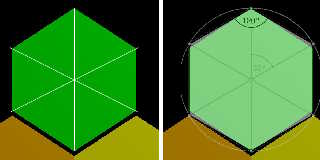

From: Kenneth
Subject: Re: Precision problems?
Date: 26 Jan 2024 12:30:00
Message: <web.65b3eba7284cb76f9b4924336e066e29@news.povray.org>
"Cousin Ricky" <rickysttATyahooDOTcom> wrote:
> Ilya Razmanov <ily### [at] gmailcom> wrote:
> > I'm out of ideas regarding the cause of it. Any inspiration?
> The geometry of the hexagons is off.
Yes, that was my guess--although, I didn't know exactly why, so I started
measuring the render visually. The white lines connecting the points should be
equal lengths but are not.
I also superimposed a hexagon diagram from Wikipedia; it shows that the internal
angles are off a bit.
Download 'hexagon_examples_kw.jpg' (60 KB)
Preview of image 'hexagon_examples_kw.jpg'

From: kurtz le pirate
Date: 26 Jan 2024 12:54:18
Message: <65b3f1ca$1@news.povray.org>
>> I have a weird problems with some prisms. Please see the file attached,
>> it's tiny example. As you can see, both hexagonal prisms and their
>> translations are calculated using school math; moreover, when it comes
>> to irrational floats, the same values are used whenever possible via
>> declaring the variable, so it have no choice but match. Still, there is
>> a gap between objects in vertical direction.
> The geometry of the hexagons is off.  Replacing all occurrences of 0.25 with
> revsqrtof3/2 will fix it.
Yes, som error in yours points.
Assuming that the first point of the prism is good : <-0.5,0.25>
We can easily calculate the radius of the center containing the hexagon
sqrt(-0.50*-0.50 + 0.25*0.25) = 0.559017 = r
Calculating all the points gives :
< 0.0000,  0.5590>
< 0.4841,  0.2795>
< 0.4841, -0.2795>
< 0.0000, -0.5590>
<-0.4841, -0.2795>
<-0.4841,  0.2795>
with :
x = r*sin(radians(a));
z = r*cos(radians(a));
'a' is the angle : 0, 60, 120, 180, 240, 300
Drawing these points near your prism give the attached image where the
different positions of the points are clearly visible.
Hope that help
