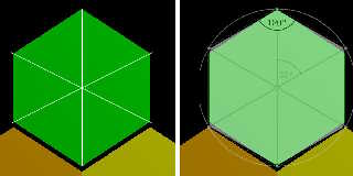

Yes, that was my guess--although, I didn't know exactly why, so I started
measuring the render visually. The white lines connecting the points should be
equal lengths but are not.
I also superimposed a hexagon diagram from Wikipedia; it shows that the internal
angles are off a bit.
Download 'hexagon_examples_kw.jpg' (60 KB)

Thanks for illustration. As "Cousin Ricky" explained, I messed internal
and external diameters in some cases. That is, the values were correct
but these were correct values of *another* variable. How foolish of me.
Ilya.
