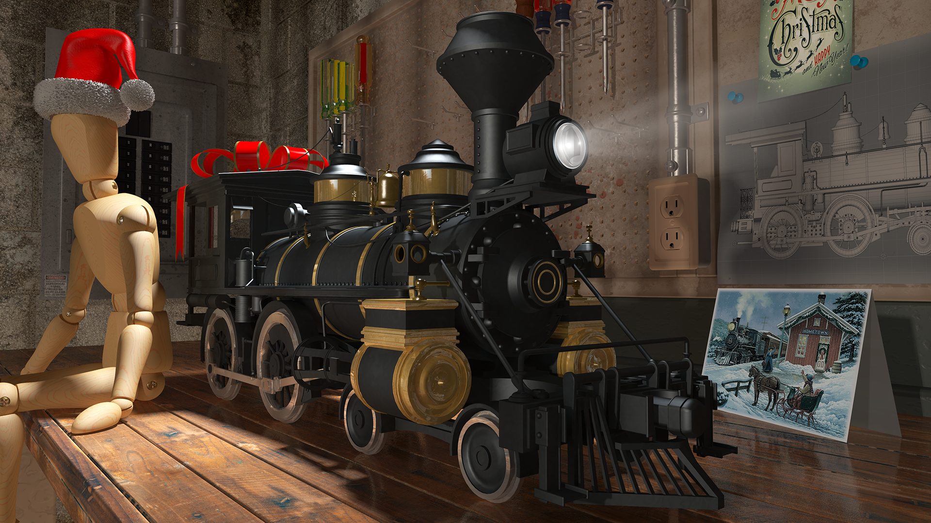

Updated train on workbench. Added Santa hat on mannequin, ribbon/bow on train,
and a few Christmas cards. Getting close on this one. May tweak the view angle a
bit.
Miller.
Download 'workbench_train_02.png' (3004 KB)
Preview of image 'workbench_train_02.png'
From: Cousin Ricky
Subject: Re: workbench_train_02.png
Date: 29 Nov 2023 08:10:00
Message: <web.656736ea6e5f46b960e0cc3d949c357d@news.povray.org>
> bit.
> Miller.
The textures of the metal trimmings on the locomotive look milky.  I suggest
lowering the diffuse and ambient values in the finish.
From: Mike Miller
Date: 29 Nov 2023 09:25:00
Message: <web.656748b26e5f46b9896a9a9adabc9342@news.povray.org>
> > bit.
> > Miller.
Thanks...I'll take a look at that.

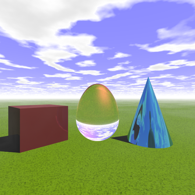

I probably made a mistake somewhere, but I have a problem with this. The
object looses its shadow in my code (see the egg in attached image).
This is the code used for the egg finish:
ovus { 1.00, 0.65
   pigment {rgb <0.4, 0.9, 0.4>}
   pigment {rgbt <0.9, 0.1, 0.1, 0.99>} //varnish coating!
   finish {
     metallic
     diffuse 0.0
     specular 0.80
     roughness 1/20
     reflection {0.90 fresnel metallic}
   interior {ior 1.5}
   scale 0.5
   translate <0, 0.5, 0>
} // end of ovus --------------------------------------
specular / roughness can be left out without visible changes btw.
Thanks for any light on this!

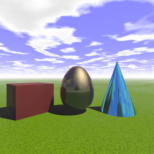

Date: 7 Dec 2023 03:42:35
Message: <6571857b@news.povray.org>
Op 7-12-2023 om 09:37 schreef Thomas de Groot:
Not entirely true. Better leave those in place for the varnish (see image)
Download 'am_metallic finish.png' (297 KB)
Preview of image 'am_metallic finish.png'

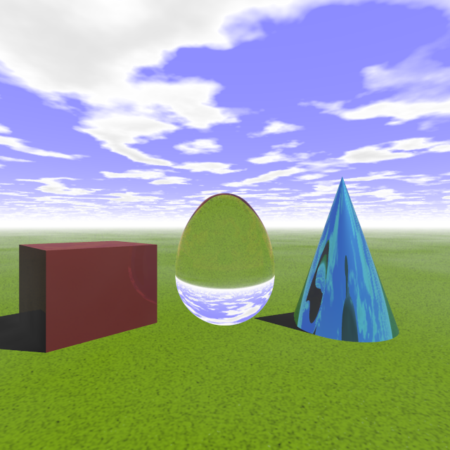

From: Cousin Ricky
Date: 7 Dec 2023 08:20:00
Message: <web.6571c65b6e5f46b960e0cc3d949c357d@news.povray.org>
> Op 29-11-2023 om 16:04 schreef Alain Martel:
> > If the metal is to have a varnish coat, add a second mostly to fully
> > transparent pigment layer above the metallic one. Add an interior
> > statement for the IOR : interior{ ior 1.5 } And use the fresnel
> > attribute : reflection{ 1 fresnel }.
> > That way, at high angle, you'll see almost only the metallic surface,
> > but, at grazing angles, you get the fresnel reflection dominating.
> > Tried that and compared with actual metals, brass actually, coated with
> > a varnish, and the result matched my physical samples.
> ovus { 1.00, 0.65
>    finish {
>      metallic
>      diffuse 0.0
>      specular 0.80
>      roughness 1/20
>    interior {ior 1.5}
>    scale 0.5
Try it this way:
ovus { 1.00, 0.65
   texture {
      finish {
         metallic
         diffuse 0.0
         ambient 0.0
         specular 0.80
         roughness 1/20
         reflection {0.90 metallic}
   texture {
      finish {
         reflection {0.90 fresnel}
   interior {ior 1.5}
   scale 0.5
Date: 7 Dec 2023 08:50:56
Message: <6571cdc0@news.povray.org>
Op 7-12-2023 om 14:19 schreef Cousin Ricky:
> Try it this way:
> ovus { 1.00, 0.65
>     texture {
>        finish {
>           metallic
>           diffuse 0.0
>           ambient 0.0
>           specular 0.80
>           roughness 1/20
>     texture {
>        finish {
>     interior {ior 1.5}
>     scale 0.5
Aaa...! Of course. Thanks so much!
The coating is improved with specular, roughness and metallic added.
Download 'am_metallic finish.png' (284 KB)
