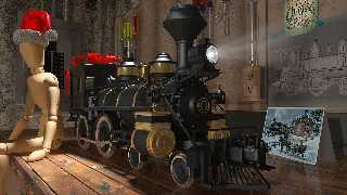

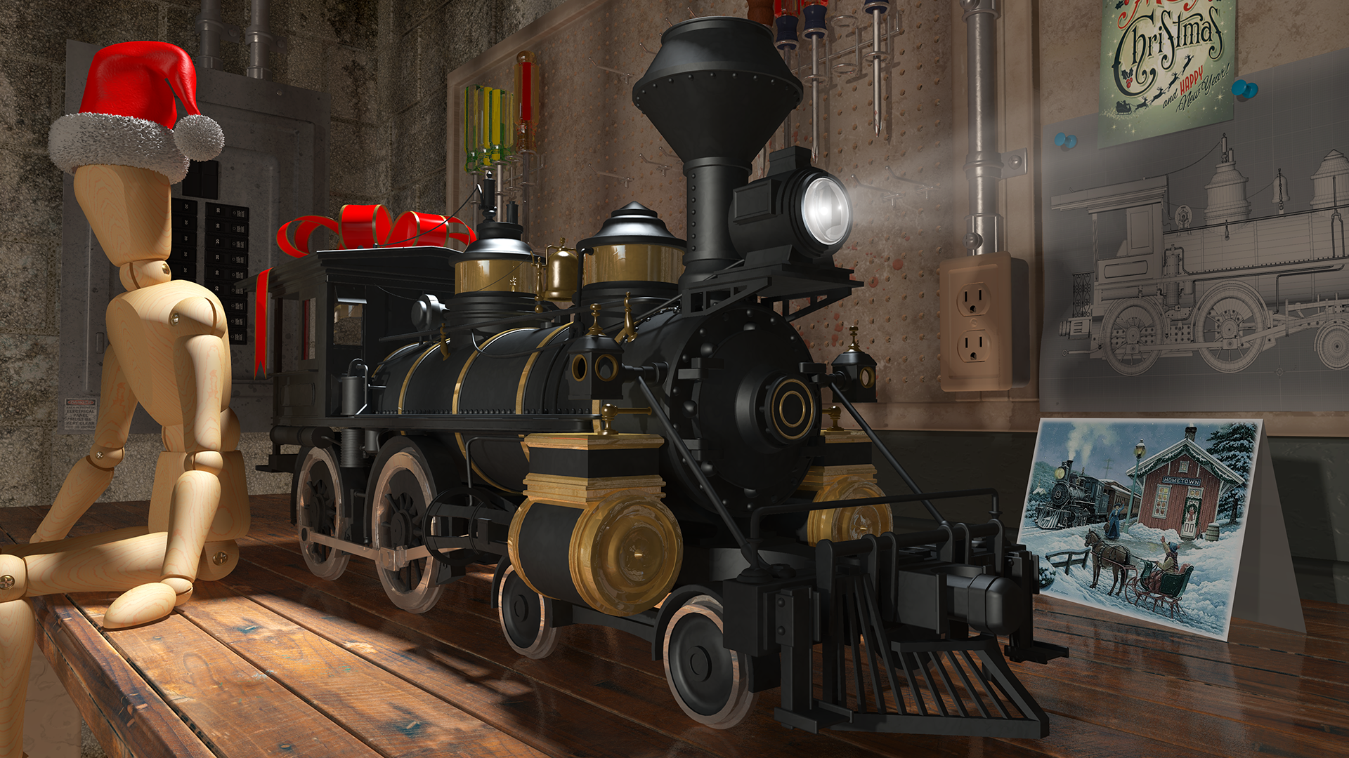

Updated train on workbench. Added Santa hat on mannequin, ribbon/bow on train,
and a few Christmas cards. Getting close on this one. May tweak the view angle a
bit.
Miller.

The textures of the metal trimmings on the locomotive look milky.  I suggest
lowering the diffuse and ambient values in the finish.

From: Alain Martel
Subject: Re: workbench_train_02.png
Date: 29 Nov 2023 10:04:36
Message: <65675304@news.povray.org>
Le 2023-11-29 à 09:20, Mike Miller a écrit :
> "Cousin Ricky" <rickysttATyahooDOTcom> wrote:
>>> bit.
>>> Miller.
> Thanks...I'll take a look at that.
> Usually, a metallic finish should have an ambient of zero, or a very
small value for a very dull surface.
Then, a diffuse should be less than 0.3. 0.3 for the dullest finish,
down to zero for the very shiny.
Use reflection with the metallic attribute.
The finishes in metals.inc and golds.inc are totally wrong. They have
insane ambient values. They where made to look good in an empty scene
with nothing but black to reflect.
If the metal is to have a varnish coat, add a second mostly to fully
transparent pigment layer above the metallic one. Add an interior
statement for the IOR : interior{ ior 1.5 } And use the fresnel
attribute : reflection{ 1 fresnel }.
That way, at high angle, you'll see almost only the metallic surface,
but, at grazing angles, you get the fresnel reflection dominating.
Tried that and compared with actual metals, brass actually, coated with
a varnish, and the result matched my physical samples.

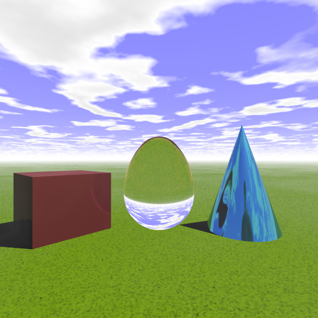

I probably made a mistake somewhere, but I have a problem with this. The
object looses its shadow in my code (see the egg in attached image).
This is the code used for the egg finish:
ovus { 1.00, 0.65
   pigment {rgb <0.4, 0.9, 0.4>}
   pigment {rgbt <0.9, 0.1, 0.1, 0.99>} //varnish coating!
   finish {
     metallic
     diffuse 0.0
     specular 0.80
     roughness 1/20
     reflection {0.90 fresnel metallic}
   interior {ior 1.5}
   scale 0.5
   translate <0, 0.5, 0>
} // end of ovus --------------------------------------
specular / roughness can be left out without visible changes btw.
Thanks for any light on this!

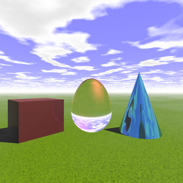

Op 7-12-2023 om 09:37 schreef Thomas de Groot:
Not entirely true. Better leave those in place for the varnish (see image)

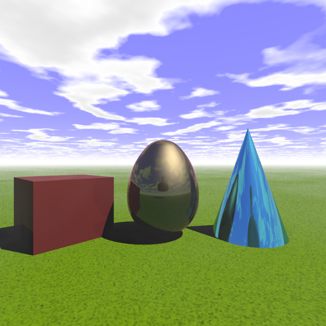

Try it this way:
ovus { 1.00, 0.65
   texture {
      finish {
         metallic
         diffuse 0.0
         ambient 0.0
         specular 0.80
         roughness 1/20
         reflection {0.90 metallic}
   texture {
      finish {
         reflection {0.90 fresnel}
   interior {ior 1.5}
   scale 0.5

Op 7-12-2023 om 14:19 schreef Cousin Ricky:
> Try it this way:
> ovus { 1.00, 0.65
>     texture {
>        finish {
>           metallic
>           diffuse 0.0
>           ambient 0.0
>           specular 0.80
>           roughness 1/20
>     texture {
>        finish {
>     interior {ior 1.5}
>     scale 0.5
Aaa...! Of course. Thanks so much!
The coating is improved with specular, roughness and metallic added.

shorthand update trick, ignores any defined interior_texture{} without a
peep.
Well, on digging into the code recently with the idea of fixing that
long-standing oversight in yuqk, I found there are additional criteria
related to the type of pattern / special patterns in play too as to
whether the short hand texture aspect updates work - even for texture{}.
So... I'm now toying with the idea of making all shorthand updates,
parse errors in yuqk and suggesting this for v4.0 too. Essentially, yuqk
would be forcing the texture{} block specification(s), always, as a path
to consistent overall behavior.
This idea is easier for me to swallow because I tend to assign finish{},
normal{}, pigment{} (and interior{}) blocks to IDs before using them in
texture{} or material{} blocks - also assigned to IDs - prior to use
with objects. In other words, I already often code in this style. I do
it because it makes modifications easier - but, it also avoids some of
the subtle shifts / inconsistencies in parsing behavior which happen
today with the texture shorthand / aspect update methods.
Aside: As an additional plus, forcing texture{} block(s) would enable
eventual simplifications in the parsing code. This, rather than
extending already complicated code to support interior_texture{}
shorthand / aspect updates.
Thoughts / comments?
Bill P.
