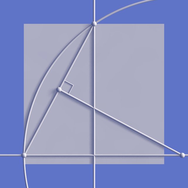

And here's an image showcasing the underlying geometry behind all this.
Basically: for any given window width and arch height, find an appropriate
circle to describe the arch.
> > > gothic/medieval window macro
> I've wound up deriving that solution from scratch about a dozen times     :D
> Nice macro.
> - BW
Isn't that just the way? So many times I've worked on a problem only to discover
that I had already solved it before, yet I somehow forgot! I think this was the
first time I figured out this particular problem, and the solution had me
stymied for a bit too long... but I had fun the whole time ^_^
Btw, what were you using this kind of geometry for?
Sam
From: Samuel B
Subject: Re: Gothic cathedral window generator
Date: 18 Jul 2023 18:05:00
Message: <web.64b70c5a37209b7ff8c47d526e741498@news.povray.org>
> Op 18-7-2023 om 02:27 schreef Samuel B.:
> > Here's a piece of gothitecture I cooked up the last couple of days. [...]
> Aaah! I love this! Can it do the typically English 4-centered arch? I
> have been trying to write a macro lately but did not get very far.
> Thomas
Thanks, Thomas!
Just looked up the 4-centered arch, and no, it cannot make those. This macro
only produces arches with single circular segments, while the 4-centered arch
seems to require at least two. Or worse, it uses some sort of curve not composed
entirely of circles. I'll look further into it though, and possibly make a
separate macro.
I've love to make a single all-purpose macro to cover everything, but there
seems to be as many window/arch variations as there are stars in the sky. (Ok,
that's a bit hyperbolic, but with all the extra details architects used, there
are a lot of designs out there.)
Sam
