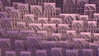

Hi,
Here's a piece of gothitecture I cooked up the last couple of days. It's a
generic gothic/medieval window macro. Nothing too involved. The glass beveling
is a simple surface normal, and everything else is just good old, traditional
CSG.
Macro incoming...
Sam
Download 'gothicarchb6m_43s.jpg' (348 KB)
Preview of image 'gothicarchb6m_43s.jpg'

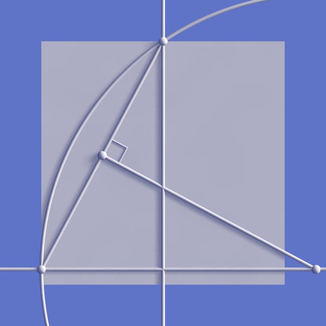

And here's an image showcasing the underlying geometry behind all this.
Basically: for any given window width and arch height, find an appropriate
circle to describe the arch.
Download 'gothicarchgeom.jpg' (22 KB)
Preview of image 'gothicarchgeom.jpg'

I've wound up deriving that solution from scratch about a dozen times     :D
Nice macro.

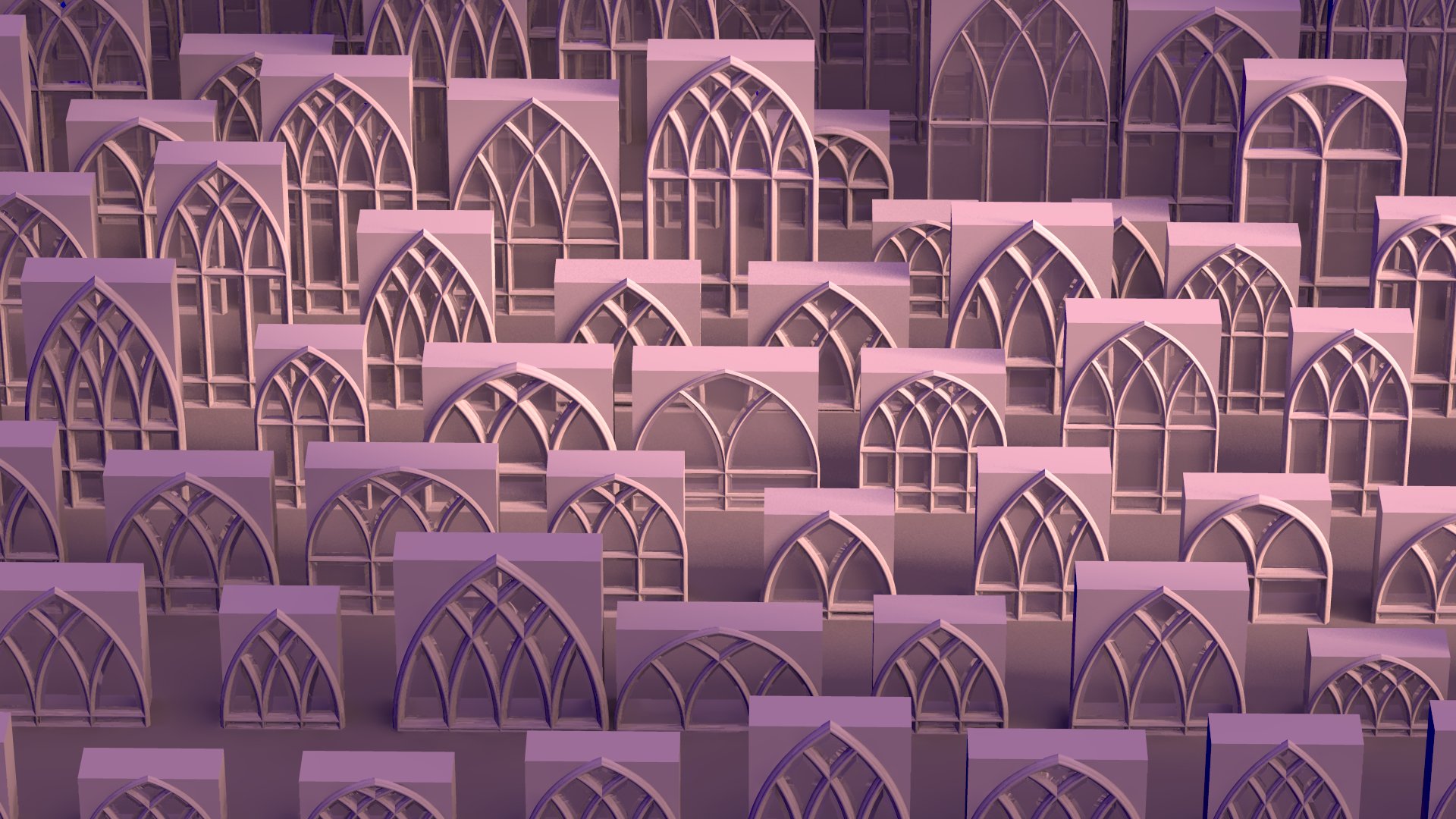

Aaah! I love this! Can it do the typically English 4-centered arch? I
have been trying to write a macro lately but did not get very far.
> Nice macro.
> - BW
Isn't that just the way? So many times I've worked on a problem only to discover
that I had already solved it before, yet I somehow forgot! I think this was the
first time I figured out this particular problem, and the solution had me
stymied for a bit too long... but I had fun the whole time ^_^
Btw, what were you using this kind of geometry for?
Sam

> Op 18-7-2023 om 02:27 schreef Samuel B.:
> > Here's a piece of gothitecture I cooked up the last couple of days. [...]
> Thomas
Thanks, Thomas!
Just looked up the 4-centered arch, and no, it cannot make those. This macro
only produces arches with single circular segments, while the 4-centered arch
seems to require at least two. Or worse, it uses some sort of curve not composed
entirely of circles. I'll look further into it though, and possibly make a
separate macro.
I've love to make a single all-purpose macro to cover everything, but there
seems to be as many window/arch variations as there are stars in the sky. (Ok,
that's a bit hyperbolic, but with all the extra details architects used, there
are a lot of designs out there.)
Sam
