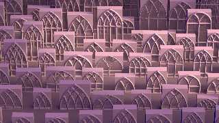

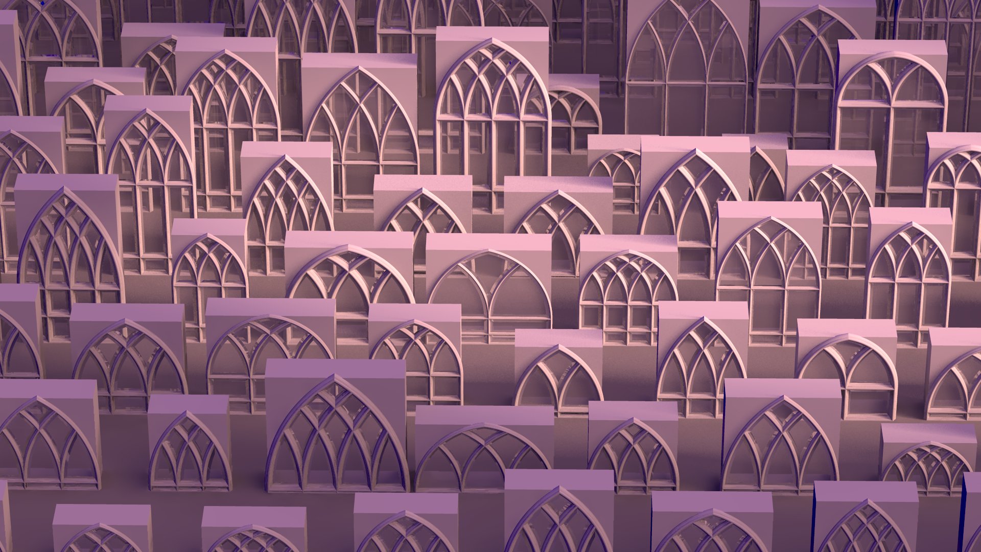

Here's a piece of gothitecture I cooked up the last couple of days. It's a
generic gothic/medieval window macro. Nothing too involved. The glass beveling
is a simple surface normal, and everything else is just good old, traditional
CSG.
Macro incoming...
Sam

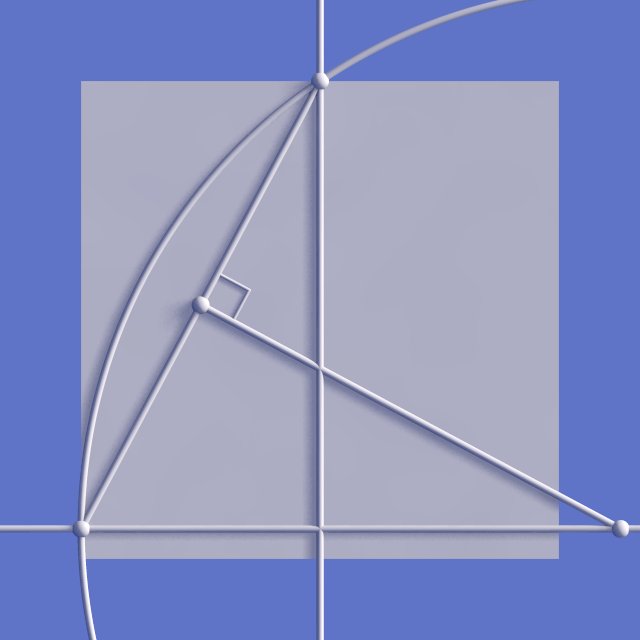

And here's an image showcasing the underlying geometry behind all this.
Basically: for any given window width and arch height, find an appropriate
circle to describe the arch.
> I've wound up deriving that solution from scratch about a dozen times     :D
> Nice macro.
> - BW
Isn't that just the way? So many times I've worked on a problem only to discover
that I had already solved it before, yet I somehow forgot! I think this was the
first time I figured out this particular problem, and the solution had me
stymied for a bit too long... but I had fun the whole time ^_^
