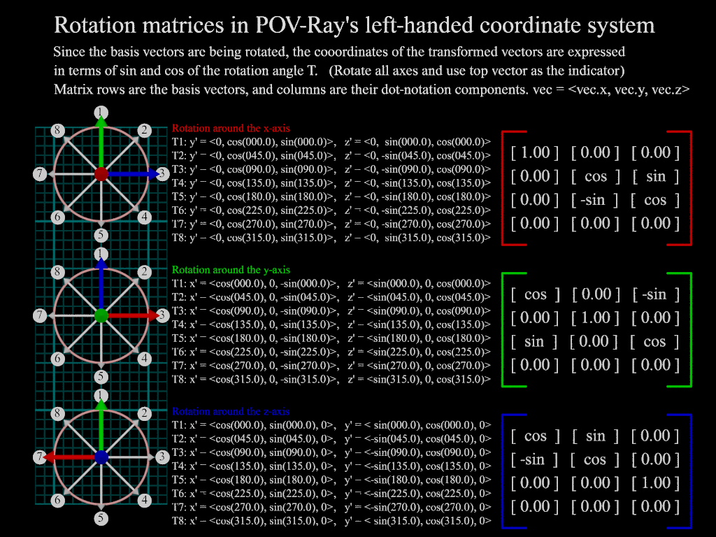

I had the unexpected "opportunity" to review some old code I've had on the
back-burner as a refresher and to look for any errors, and I spotted some errors
in some of the matrix transforms I was using to create some vectors.
Since we use a left-handed coordinate system, and rotation matrices can be a bit
confusing - especially at first - I made a sketch, and then decided it ought to
be added to the collection of documentation diagrams I'm making.
There may be some additional graphics on this specific topics if I find the time
amidst all the other stuff.
As far as I can tell there was no explicit mention of using the formulas of the
transformed basis vectors in isosurface variable substitution on either Mike
Williams' site or Friedrich Lohmueller's.  Though they do appear in POV-Ray's
online documentation.
http://www.povray.org/documentation/view/3.7.1/73/
Rotate
Note: these rotation substitutions work like normal POV-rotations: they already
compensate for the inverse working
rotate around X
: replace "y" with "z*sin(radians(Angle)) + y*cos(radians(Angle))"
: replace "z" with "z*cos(radians(Angle)) - y*sin(radians(Angle))"
rotate around Y
: replace "x" with "x*cos(radians(Angle)) - z*sin(radians(Angle))"
: replace "z" with "x*sin(radians(Angle)) + z*cos(radians(Angle))"
rotate around Z
: replace "x" with "x*cos(radians(Angle)) + y*sin(radians(Angle))"
: replace "y" with "-x*sin(radians(Angle)) + y*cos(radians(Angle)) "
  rotate z*75   gives:
  P(x*cos(radians(75)) + y*sin(radians(75)),
    -x*sin(radians(75)) + y*cos(radians(75)), z)
Anyway,
Here is a supplementary illustration - it could probably use some polishing.
Download 'rotationmatrices.png' (296 KB)
Preview of image 'rotationmatrices.png'

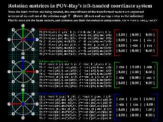

Nice illustration.
To improve it I suggest that you remove the decimals. This will give you some
more space and make it easier to read.
I also suggest that you insert a note to the reader that POV-Ray's trigonometric
functions use radians, not degrees as in you basis vector lists.
Further; some of the equal signs have become minus signs. Could this be caused
by some scaling of the image ?
Tor Olav

"Tor Olav Kristensen" <tor### [at] TOBEREMOVEDgmailcom> wrote:
> Nice illustration.
Thank you, Sir.
Yes, I was waffling on that - too many, too few...   hard to judge.
It's always tough to try to squeeze a lot of information into a limited space.
There's a weird 3-fold aspect to the way the vectors are represented in the
matrices that I'm trying to capture, but unsure what the best way to go about it
is.   Each row is an x, y, z basis vector.   Each column of that row is an x, y,
z vector component.  And then the final transform is the "sumproduct" for all of
the columns - the x' vector is x.x + y.x + z.x + w.x
So I left all of that criss-crossing out for now. ;)
IIRC, it's an antialiasing thing.  I noticed it, but let it slide, hoping for
more feedback before I revised the entire thing.   Maybe I'll see if I can find
a bold font to replace 'timrom' with.
Or maybe I'll just scale the font in the y-direction a little bit to thicken the
horizontal lines.

> // +am3 +a0.001 +ac0.99 +r4
I tried that, but even that wasn't good enough to make the "=" fully visible.
scaling along y by 1.2 improved matters, but then I just switched over to Times
New Roman Bold and kept the scaling as well.
Changed the angles to radians.
Slight color changes on the tori.
I didn't feel like going full utf8 to get a proper pi character - yet.
Download 'rotationmatrices.png' (416 KB)
> > trigonometric functions use radians, not degrees as in you[r] basis
> > vector lists.
> I will keep that in mind.  I have one or two other "documentation illustrations"
> in mind.
I usually like to use trig functions in degrees rather than radians-- just
easier to visualize for me. "math.inc" has some simple little 'converter'
functions, sind() and cosd()
So in your diagram, for example...
T5: y'= <0,cosd(180), sind(180>
But for your matrix illustrations, I don't know if they should be used (since I
don't know enough about matrix math).
    like,  -sind  instead of  -sin  ??
I was playing around with some things the other day, writing my function
document,  and noticed that we don't need "math.inc" anymore - at least not in
3.8.   :)
I just put sin and cos because everyone everywhere knows what that is and I
would hope that most people would assume that it's implied that there's a
degrees - to - radians conversion...   But "matrix math" is no different than
"spreadsheet math" or pencil and paper math or chalkboard math....   it's just a
way of laying things out so that the values in the places are operated on by the
appropriate values in the places of other matrices.  Or that the formulas for
things like determinants are using the right values.   No magic.
It's just an organizational thing to make the notation compact.
Just think about it as: array {Vec.x, Vec.y, Vec.z} and then make a 2D array
with 2 or 3 more vectors....
