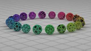

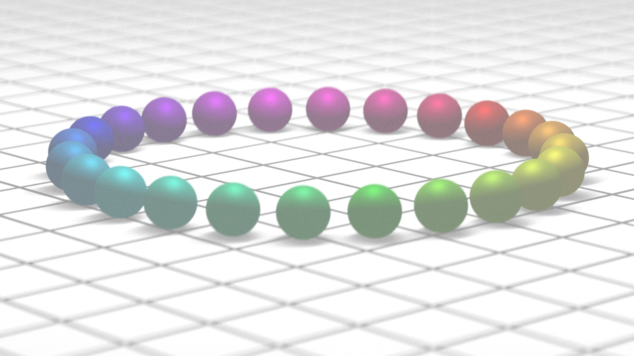

Hi,
After many years of coding, the realistic finish has never been my best point.
Wow could I fix the unrealistic finish of these spheres?
The more I look at them, the more "fake" they look on the image.
I can't find the right combination of ambient, radiance and brilliance.
Regards
B. Gimeno
pd, the source for the Red Sphere
            texture {
              pigment { Red
              finish { specular .5
                       metallic
                       ambient .2
                       diffuse .5
Download 'btfh2.png' (703 KB)
Preview of image 'btfh2.png'

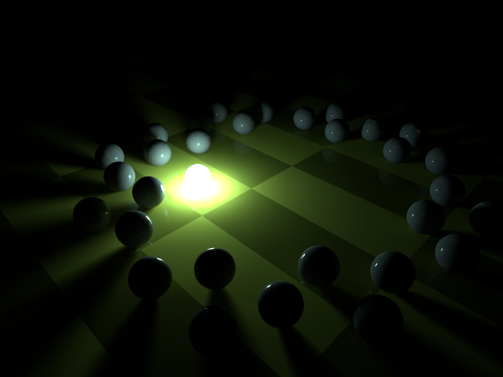

From: And
Subject: Re: Any advice on lighting?
Date: 25 Nov 2017 00:35:01
Message: <web.5a1900064b15f6efa6394f050@news.povray.org>
"B. Gimeno" <nomail@nomail> wrote:
> Hi,
> Regards
> B. Gimeno
>             texture {
>               pigment { Red
>                        metallic
>                        ambient .2
>                        diffuse .5
I post an image for your reference,
sphere{
<0,0.14,0.3>, 0.14
    texture{
        pigment{rgb<0.19,0.18,0.19>}
        finish{ambient 0 diffuse 1 brilliance 1.5 reflection {0.01,0.2 falloff
3}}
Download 'finish test2 6.png' (236 KB)
Preview of image 'finish test2 6.png'

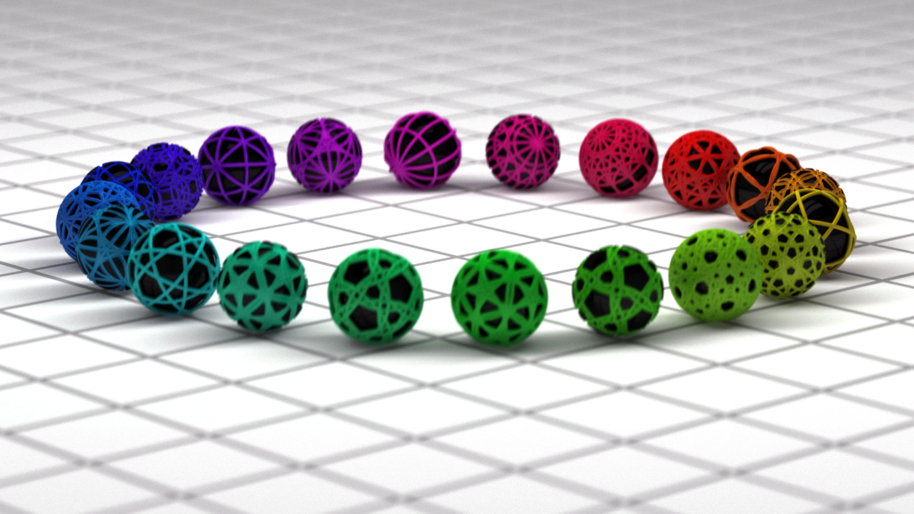

From: B  Gimeno
Date: 1 Dec 2017 04:35:01
Message: <web.5a21222c4b15f6efc95fc4120@news.povray.org>
Thank you very much for the advice, I have been experimenting and forcing the
code to optimize results with high parameters of radiosity and blurring. I'm not
entirely happy, but the smoke coming out of the processor tells me this is all
you can do before I call 911.
I leave two images of the final result. One of them with levels and curves
adjusted with photoshop, which for my taste improves the result remarkably and
comes closer to what I would like it to look like. The scene was designed as a
scenario to test a rewrite of an old macro of mine to generate pseudo-toroidal
objects with many, (too many) parameters. The tests soon got out of hand and the
final finishing adjustments took control of the scene before I realized it. I
have used another simple macro that I also wrote to generate something similar
to spheres instead of the simple balls of origin. This one has no name, and soon
I will publish the code of the whole scene for your delight.
I've been testing subsurface too. I got strange artifacts and ended up
deactivating it because I thought it would not improve the scene as it was
planned.
any other suggestion, criticism or comment is always welcome,
a greeting
B. Gymene
Download 'finalrender.png' (869 KB)
Preview of image 'finalrender.png'

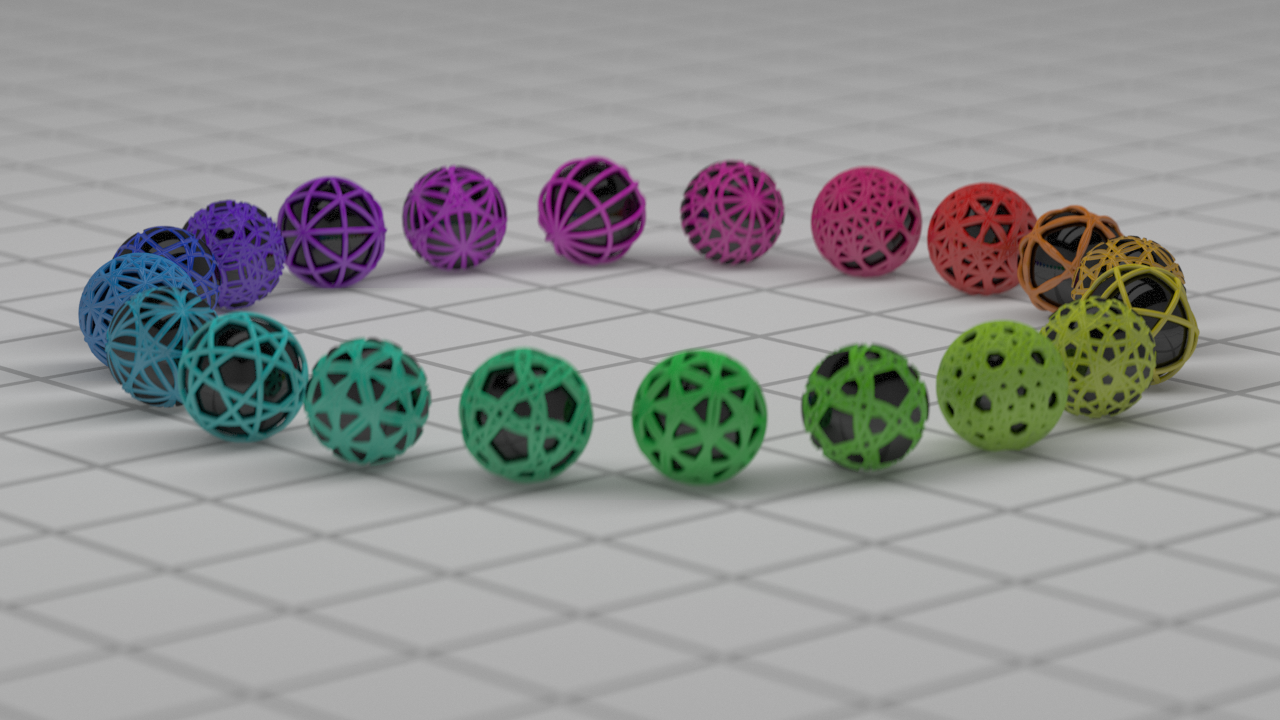

From: B  Gimeno
Date: 1 Dec 2017 04:40:02
Message: <web.5a2122f94b15f6efc95fc4120@news.povray.org>
and the photoshopped one
Download 'editedrender.png' (1026 KB)
Preview of image 'editedrender.png'
From: And
Date: 1 Dec 2017 07:00:01
Message: <web.5a2143d34b15f6ef7e12b7e70@news.povray.org>
> planned.
> a greeting
> B. Gymene
beautiful spheres.
From: B  Gimeno
Date: 1 Dec 2017 08:25:01
Message: <web.5a2157fd4b15f6efc95fc4120@news.povray.org>
I have just noticed that the edited version almost completely eliminates the
reflection of the spheres. And this makes me think that when you want a
realistic version of a scene you're actually asking for a retouched version of
reality, just as advertising photography has taught us.

From: clipka
Date: 1 Dec 2017 11:04:07
Message: <5a217d77$1@news.povray.org>
Am 01.12.2017 um 14:24 schrieb B. Gimeno:
Not me. I'm going for the unedited version.
Maybe it's a matter of having a calibrated display. Maybe it's personal
taste.
