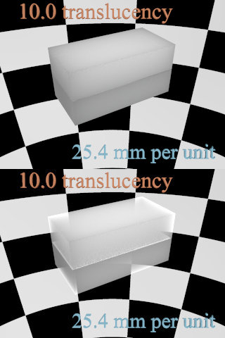

Branching off of the message by Clipka in the animations group at:
http://news.povray.org/58516d06%241%40news.povray.org
As was suggested in the thread there, to only set mm_per_unit and leave that
alone, I was only able to get a similar appearance from subsurface scattering by
using a translucency of <10,10,10>. This is without knowing of a typical range
for it, and which I can only consider a rather large value. Mainly because of a
tendency to go transparent at such high numbers.
Wanted to demonstrate here how ior affects SSLT, somewhat masking my
insufficient result while attempting to duplicate the real world experiment
(shown at link within initial message above).
Thanks for any further input or observations about using SSLT. Everything I've
done with it is trial and error, and although I do try to set mm_per_unit to
each scene scale I often fail unless tweaking that to be a less or more.
Download 'wax_sslt-ior.jpg' (45 KB)
Preview of image 'wax_sslt-ior.jpg'

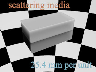

Thought I would try scattering media in an attempt to find how it differs from
subsurface scattering.
Found that all (using method 3 defaults) media scattering types, except 5 with
some change to eccentricity, do not cause the kind of light/dark (or top/bottom,
lit/unlit) differences if all else is the same.
This image shows the scattering type 5 with eccentricity 0, upper block of wax,
and eccentricity 0.2 for the lower.
Might be common knowledge but I wasn't sure yet about potential characteristics
of media to mimic SSLT, without special adjustments or trickery like changing
parameters of separate instances. Maybe I'm learning something. :)
Download 'wax_media08.jpg' (17 KB)
Preview of image 'wax_media08.jpg'

The lower set of wax, were it slightly blue, would most closely resemble
silica aerogel to my eye.
Very nice either way, what were the textures used for these if you don't
mind my asking?
Ian

Can't answer till late tonight I'm away from home.  The media is thick anyway,
but what makes them look opaque mostly seems to be the refraction.

Sorry, slipped my mind. I had tried all the other media scattering types, some
multiplied by 3 not just 2, but deleted as I changed them. Here it is:
/* testing for correct wax SSLT properties */
//cmd:-kfi1 -kff50 -sf8 -ef8 +am2 +a0.2 +fj
#version 3.7;
#declare SSLT=no;
#declare MM=25.4;//*clock;//4;  /* mm_per_unit */
#declare ST=10;//8+12*clock;//1.5; /* translucency */
global_settings{assumed_gamma 1.0
 ambient_light 1
 radiosity {
  #if(SSLT=yes)
  subsurface on
  #end
  media on
 #if(SSLT=yes)
 subsurface{
  samples 500,50
 #end
 mm_per_unit MM}
light_source{-z*99,1 rotate <60,-15,0>}
light_source{-z*9,<0.75,0.9,1>
 spotlight point_at 0 radius 6 falloff 10
 rotate 90*y}
camera{location -z*9 look_at -y/2 angle 50
 rotate <30,30,0>}
sphere{0,1 hollow pigment{
 uv_mapping checker rgb 0 rgb 1 scale 0.05}
 //function{abs(y)} // room
 //color_map{[0 rgb 0][1 rgb 1]} scale 2 translate -y}
 scale 111}
box{-1,1 hollow scale <2,0.5,1> translate y*0.511
 // upper wax block
 pigment{rgbf 0.99} finish{brilliance 2
 diffuse albedo 0.8,0.2
 specular 0.1 roughness 0.1
 //subsurface{translucency ST}
 interior{ior 1.445
  media{emission 0 absorption 0
   scattering{5,<1,1,1>*2 eccentricity 0}
   density {rgb<1,1,1>*2}
box{-1,1 hollow off scale <1.95,0.01,0.95>
 // foil sheet between wax blocks
 pigment{rgb 0.1} finish{diffuse 0.1
 specular 0.9 roughness 0.01
 reflection{0.5}
box{-1,1 hollow scale <2,0.5,1> translate -y*0.511
 // lower wax block
 interior{ior 1.445
   scattering{5,<1,1,1>*2 eccentricity 0.2}
text{ttf "times", concat(str(MM,-2,1)," mm per unit"),0.1,0
 pigment {rgb <0.4,0.8,1>}
 scale <0.75,0.75,0.75>
 rotate <30,30,0>
 translate <-2.25,-2.5,-1>
#if(SSLT=yes)
text{ttf "times", concat(str(ST,-2,1)," translucency"),0.1,0
 no_shadow
 pigment {rgb <1,0.4,0.2>}
 scale <0.5,0.5,0.5>
 rotate <30,30,0>
 translate <-3,2.75,-1>
#else
text{ttf "times","scattering media",0.1,0
 no_shadow
 scale <0.5,0.5,0.5>
 rotate <30,30,0>
#end
