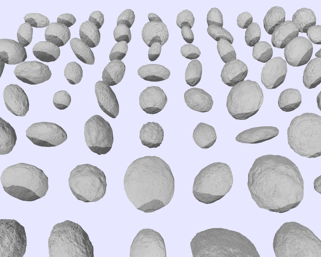

See post in PBAU: Isosurface Rocks, using a single iso; could use a bit of help
Don't worry, the output will get way better in every way before I release the
macro pack for the rocks and bricks/floors.
Changing the container object to be some blobs might do it, otherwise I'll need
to work on some mesh based perturbation macro...which I don't want to do, so I
hope other methods will work. ;-)

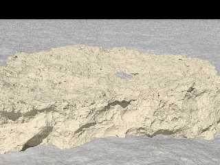

Here is a rock of type [1,2] which would be useful for solidified lava flows, or
other non-rock things, sitting on a subdued IsoTerrain.

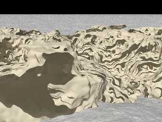

Type [0,1].
Note all these are scaled up to see the details, usually, for blocks, you
wouldn't make them like this, but for terrain elements you might.

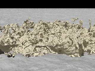

Type [2,3]
I will leave the rest for an image where I loop through the currently available
options in various combinations.

Those wavy dark features look suspiciously like isosurface artifacts.  Are you
sure your max_gradient is high enough?

Oh it certainly isn't. :)
I will need to play with that value a bit.
Thanks!

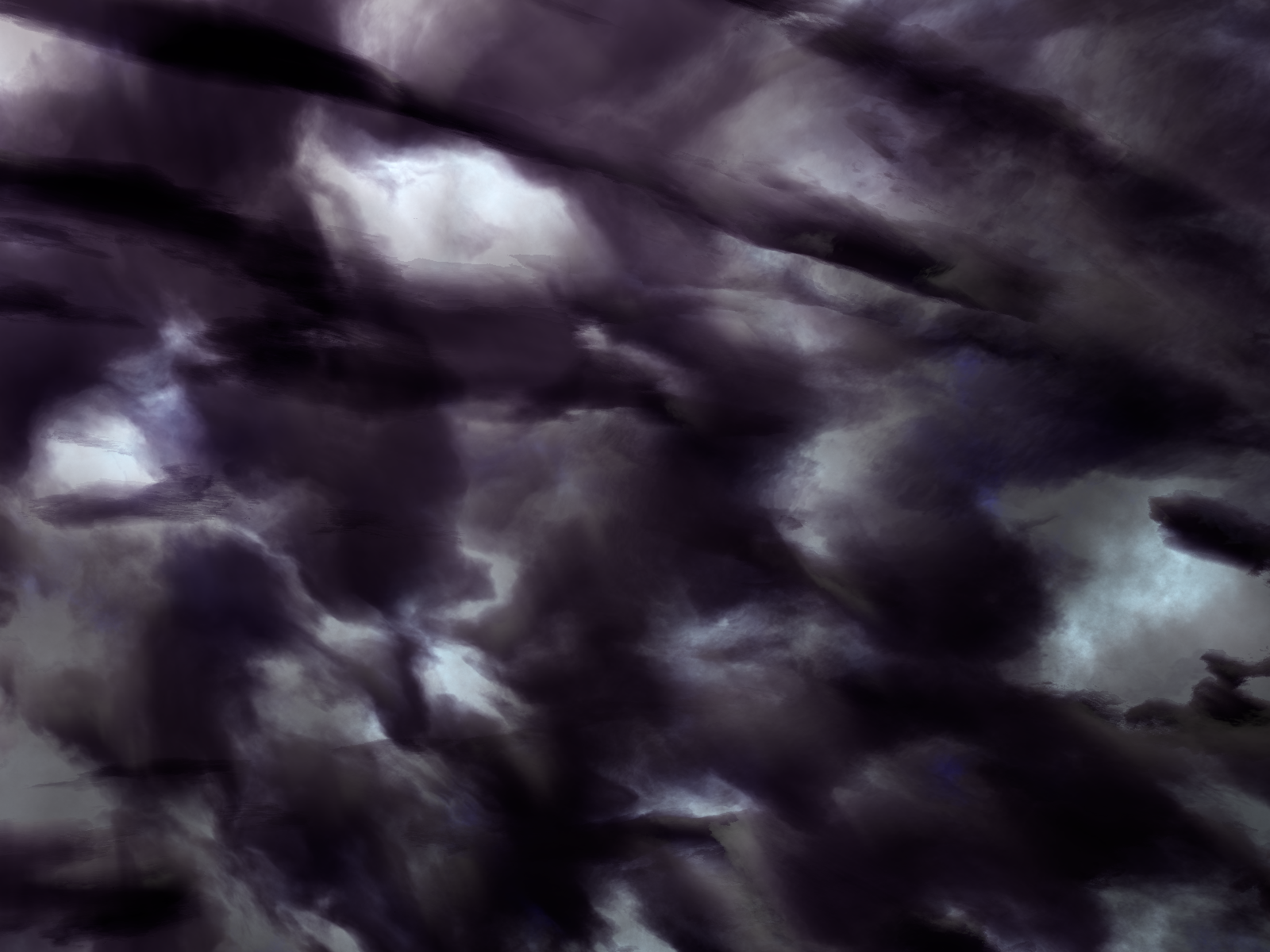

Here is an "angry" media sky output from the Sky macro.
I will post the other settings as I get them where I want them to be.
Ian

Cecil B. DeMille worthy!

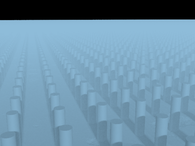

The Fog is being a little weird, because Media without a container is only
visible when looking at the plane below it, and it vanishes above the horizon.
?! Weeeird. Very counterintuitive.
Any idea why this is, and how to fix it? Is the only choice to bound the media?
I am guessing that this is because it is not reasonable to calculate media for
an infinite space, but I could be wrong.

You are correct on this point. Media sampling can only be computed
between two deffined points. When you reatch the background, the far
point is undefined, making the computation impossible.
Solution : Place a background plane behond the scene. Make it no_image,
no_shadow, no_refection and no_radiosity.
