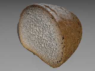

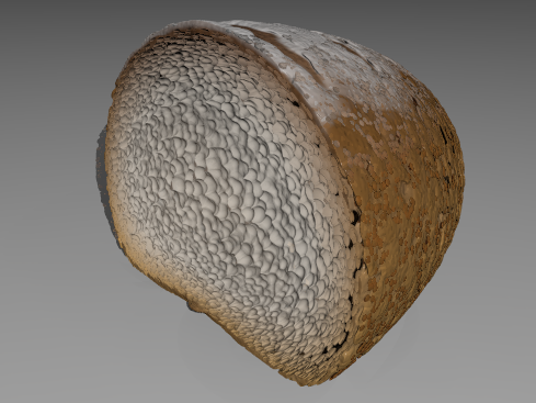

After cloth simulation, another element of my next image, a bread loaf. The
crust please me enough, but I'll work a little more on the bread.
Comments welcome.

WOW.
That's looking fantastic  :)
Add a Swiss-cheese texture to the bread to give it the usual porosity, and maybe
use some sort of isosurface or heavily distorted cubes to do the cut bread
surface to give it that jagged crumbly texture.   A few loose crumbs on the
plane would add to the realism.
Really excellent work - that must have taken a long time to code and get the
textures just right.
Yes, that's the point that doesn't please me the most, I wish to improve it.
> and maybe
I thought about it too, but it may take me too much time (I want the whole image
to be completed this month). And anyway this may be not that visible in the
final image, this bread is not the 'main character' ;-)
> Comments welcome.
The crust look prety convincing.
It that bread is seen from a distance,maybe partly obscured by other
objects, it can be qualified as good enough. It's not good enough for a
closeup.
For the interior, you should use an isosurface using the crackle pattern.

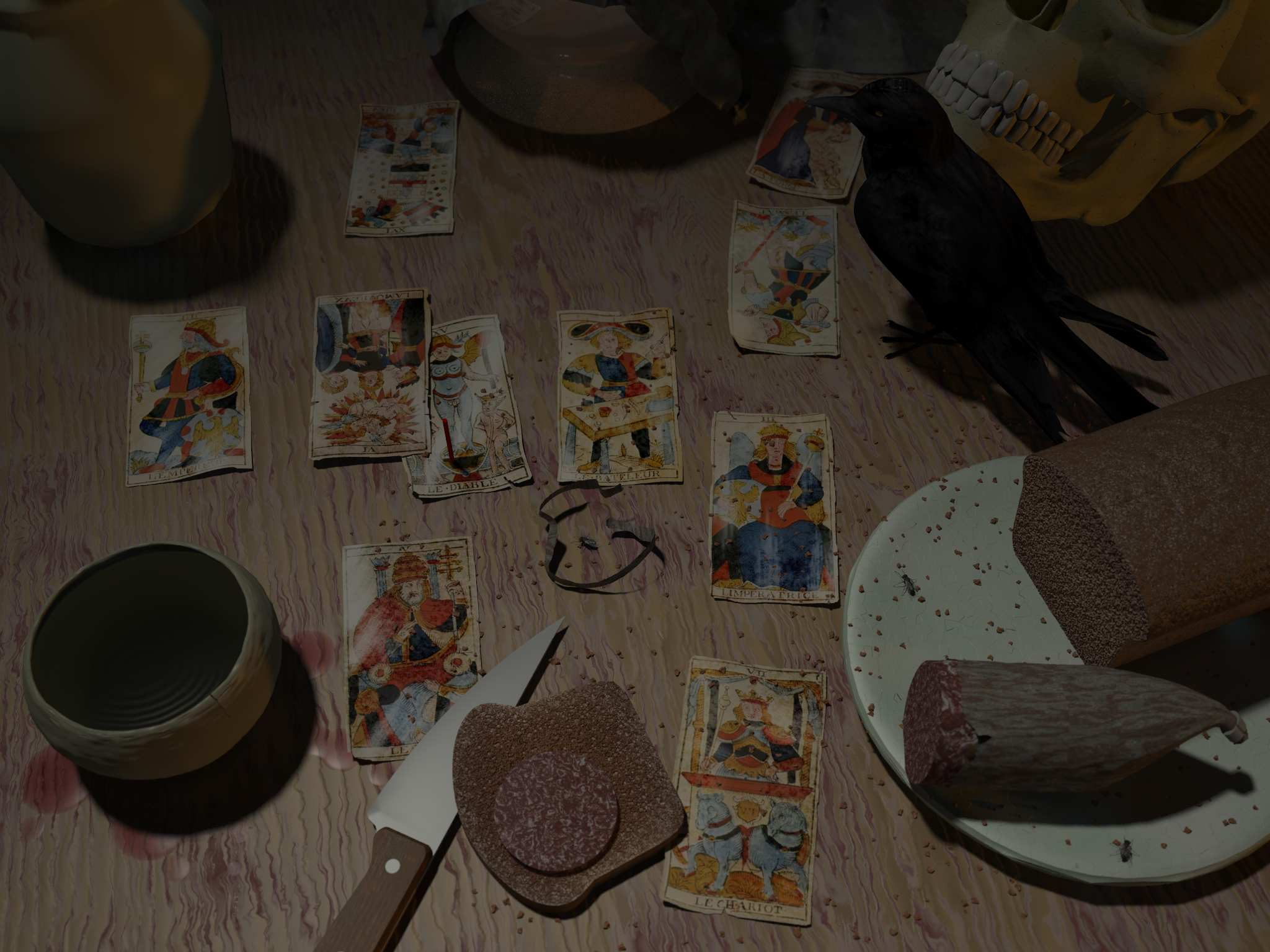

Reminds me of my image back in 2009: Vanitas. I seem to remember that
the bread was not created by me. I shall try to dig up the code.
Download 'vanitas_final.png' (3571 KB)
Preview of image 'vanitas_final.png'
Subject: Re: Bread
Date: 4 Mar 2016 03:01:05
Message: <56d940c1$1@news.povray.org>
It is an image_map used as a height_field. Created by StephenS for a
Moray tribute back in 2003. I don't think that is the way you want to go?
