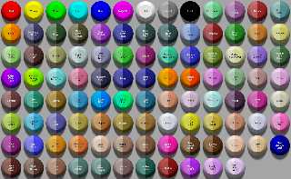

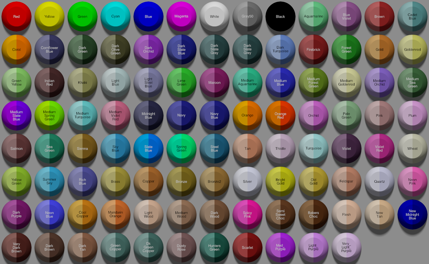

About 2 years ago, I wrote a scene to plot the stock colors in a 3-D HSL
structure, just to get an idea of how they were distributed.  After seeing all
the colors at once, labeled, it occurred to me:  What if the colors were
assigned using gamma 2.2 or sRGB?  After all, I had gotten the sense that
assumed_gamma was a fairly new feature at the time I discovered POV-Ray, and it
would seem reasonable that the colors were not assigned with linear rendering in
mind.
I have used assumed_gamma 1 in nearly all of my scenes since the day after I
downloaded POV-Ray.  Literally.  (I checked.)  It's just something I don't even
think about.  I re-rendered the scene with gamma 2.2, and the color assignments
made a lot more sense.
The other day, I wrote a scene to display the two versions of the stock colors
side-by-side.  (Most of the grays are omitted.)  The scene uses assumed_gamma 1.
 The left half of each test object uses the color straight from colors.inc.  On
the right half, the sRGB transfer function is applied.
Having solved this mystery, colors.inc is still not off the hook.  Coral, to me,
is not a synonym for orange.  The Pink looks more like puce.  SlateBlue and
MediumSlateBlue look far brighter than any slate I've witnessed, and I don't
know what "steel blue" even means.  (Steel looks a neutral to warm gray to me.)
Worst of all, the color named "Flesh" is /totally/ unrealistic.  DarkWood is
much closer to the flesh color over most of my body, with my palms and soles
between MediumWood and Feldspar depending on the computer monitor, the position
of my hand, and the temperature of the room.
P.S. The timing with A.D.B.'s post is pure coincidence.
Download 'linear_v_srgb.png' (595 KB)
Preview of image 'linear_v_srgb.png'

In this second render, the diffuse and ambient values were boosted to the
saturation threshold.
The scene file is posted in povray.binaries.scene-files.
Download 'linear_v_srgb-max.png' (620 KB)
Preview of image 'linear_v_srgb-max.png'
Good job - I think this highlights the problems with having the
incorrect gamma very nicely. If you do happen to use the "wrong" gamma,
as some people do for artistic purposes, you can often manually "fix"
areas of light and shade by adjusting the scene lighting. However, your
picture shows this very nicely, having the wrong gamma actually gives
you the wrong hue for most colours, and this can't be fixed by messing
about with the brightness of the finish or the lights.
Luckily this has all been fixed in POV now, this would have (and did)
cause several huge threads a couple of years ago :-)
