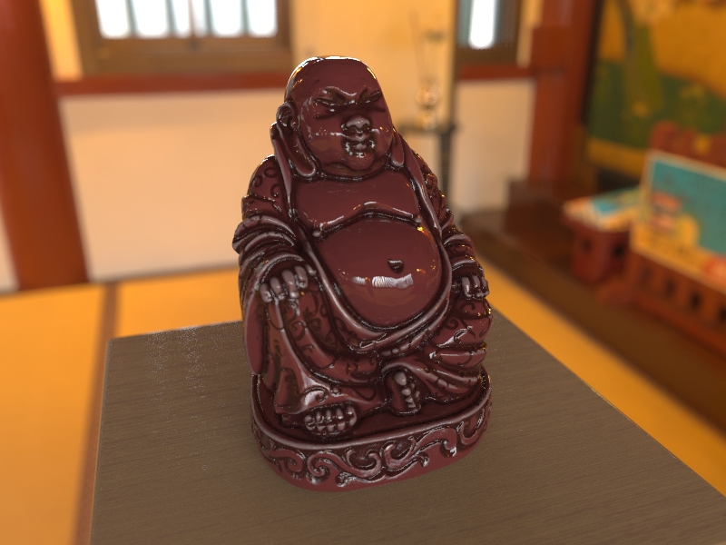

A high quality example of what I've been able to do with my crevice macro.  This
has two runs on it, one for the dark crevices, and one for the light ridges.  I
used a sampling resolution of 600, the parse time on my current machine was
9minutes (including ~4secs to load mesh, +15secs to calculate light dome.)
Render time was ~32minutes including focal blur and 16 3x3 area lights.
-tgq

Outstanding!
I started playing with your revised macro a little while ago - this is very
inspirational :)
www.McGregorFineArt.com

yep I agree ... I got going fairly quickly, doesn't look like too much
of a learning curve to get the tuning correct, the comments pretty much
spell it all out ... nice job Trevor!

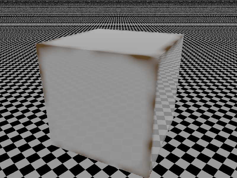

Good tip, I actually used that method for my testing.
The reason I made the slight usage change was so that the results could be
manipulated.  For example combine with a bozo pattern or other to make the edge
wear intermittent rather than continuos.  See the attached image.
Coincidentally, running this example enabled me to find an error in the way it
was handling faces with vertical (<0,+/-1,0>) normals.  I have corrected it and
posted a revised version.  Thanks!
-tgq

Download 'creviceexample2.jpg' (389 KB)
Preview of image 'creviceexample2.jpg'
