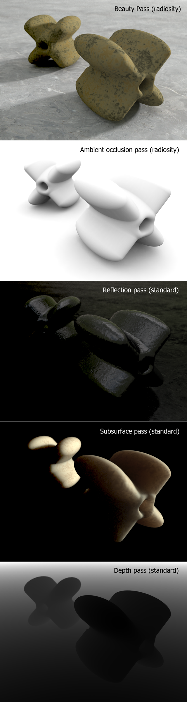

As a test I re-rendered my SSLT dragon using 4 separate render passes: beauty
(radiosity), ambient occlusion (radiosity), reflection (standard lighting), and
subsurface (standard lighting, and FAST). After all four frames were rendered
the second scene file auto-composited the various render passes using some
simple SDL macros over a few more animation frames. The entire process took only
50 minutes versus 17.5 hours! And the end result is virtually identical to the
"brute-force" render that took ~18 times longer. This method also provides the
flexibility to re-adjust lighting, reflections, etc. without re-rendering the
shot, just by changing a few parameters in the compositing macros. Take *that*
Pixar!

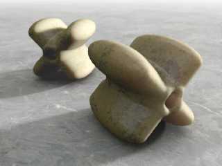

So, here's an example shot of the "blob with negative strength" from the
pvengine64 "Insert" menu, using five separate render passes. After I clean up my
code a bit I'll make it available; I'm pretty excited about this, so I'm also
planning to write a how-to for the wiki. Comments, thoughts, etc. regarding this
technique are greatly appreciated.

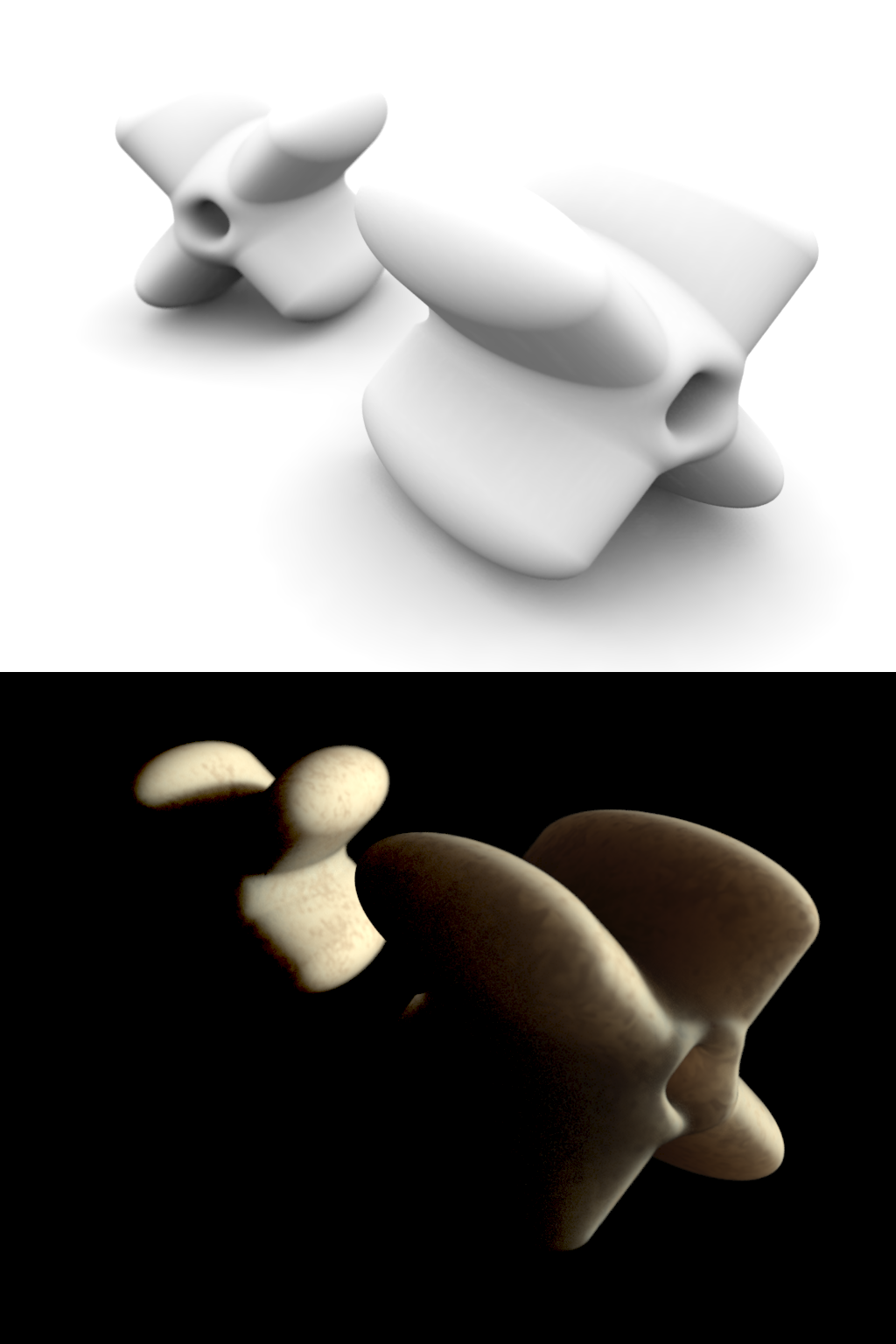

And here are full-size versions of the ambient occlusion (radiosity) and SSLT
(standard) passes...
www.McGregorFineArt.com
Download 'blobrenderpasses_ao_sslt.png' (338 KB)
Preview of image 'blobrenderpasses_ao_sslt.png'

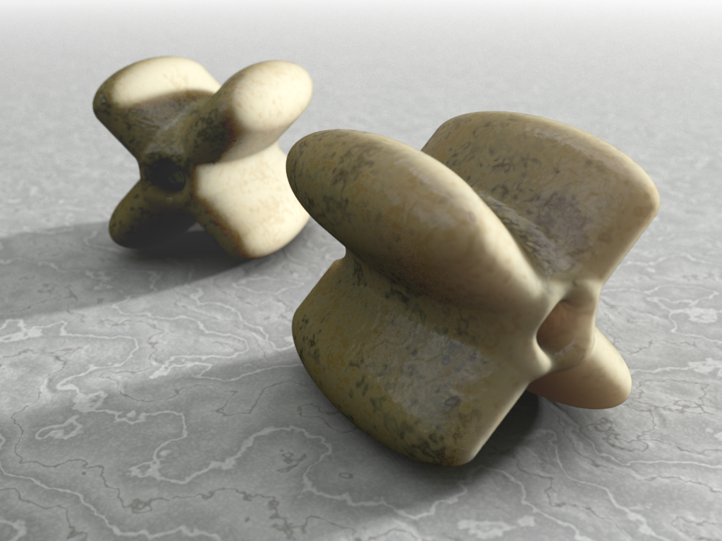

And here's the final SDL composite :)
Download 'ssltmultipasscomposite5.png' (3387 KB)
Preview of image 'ssltmultipasscomposite5.png'

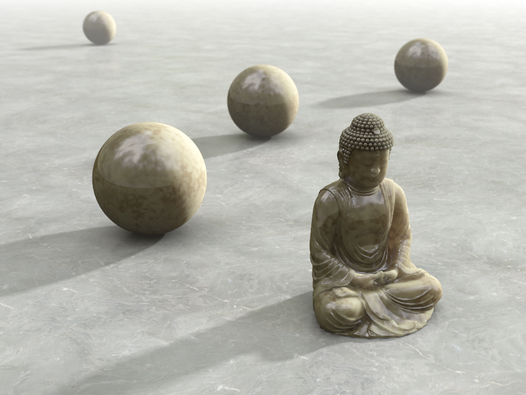

Here's a similar test using Buddha and some balls, AO and SSLT.
Download 'buddha_balls_ao_sslt.png' (321 KB)
Preview of image 'buddha_balls_ao_sslt.png'
From: Robert McGregor
Subject: Re: Multi-pass rendering and compositing in POV-Ray
Date: 8 Mar 2011 23:50:02
Message: <web.4d7706126b0cef9b94d713cc0@news.povray.org>
And here's the Buddha Balls final comp

Here's a version with no image maps or HDR - completely SDL procedural.
I only needed to re-render the beauty and reflection passes, then run the
composite animation again. Perfect for gigs where the picky art director keeps
changing his mind about some little details like ground texture...
Download 'multipasscomposite5.png' (3659 KB)
Preview of image 'multipasscomposite5.png'
