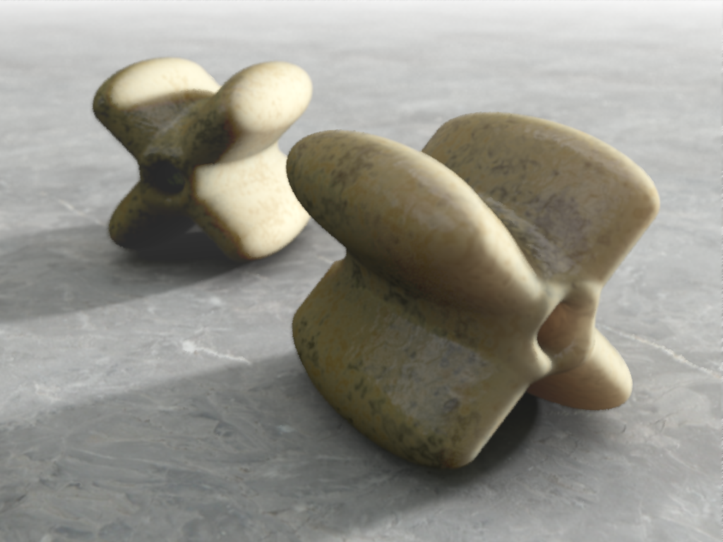

After struggling with *REALLY* slow SSLT w/Radiosity renders for the last couple
of weeks I thought I'd wait until RC4 to try anything more with it. But I was
wrong; wrong-thinking about the entire issue, that is.
Christoph has provided us with this /amazing/ new feature, but subsurface with
radiosity almost seems like a brute force approach in its slowness (yes, due to
the many SSLT samples stacked upon many radiosity samples, with all the
mega-math, area lights, focal blur, etc., it's inevitably going to be slow).
Using radiosity my SSLT dragon scene took 17.5 hours to render; with standard
lighting it took about 45 minutes (and the scene really looks pretty awful
/without/ the radiosity). I'm a radiosity junkie, most scenes just look better
with it.
The guys from Mental Images and Autodesk can't be /that/ much smarter than we
are, right? So how do the high-end packages render stuff so fast?? Multiple
render passes composited on the fly, that's how!
I started thinking how cool it would be for POV-Ray to have all the benefits of
radiosity and global illumination right alongside the speed of standard ray
traced lighting (for say, subsurface and reflections) in a single shot, just
like Maya or 3DS Max using different "shaders;" to have the ability to render
multiple passes using different lighting models and composite them directly
within POV-Ray into a final seamless shot!
Some of you will recall that a couple of years ago I implemented a basic ambient
occlusion setup that adds additional realism to my shots (okay, that's "fake"
realism, but it's good enough for ILM, so...) via a multiple-render-pass
w/SDL-compositing approach. Well, I spent a few hours modifying my macros and
scene switches and set up two POV scenes in my file queue; one for rendering
multiple passes via animation frames, and one for compositing them via animation
frames. And this technique stays within IRTC and TC-RTC guidelines too :)
As a test I re-rendered my SSLT dragon using 4 separate render passes: beauty
(radiosity), ambient occlusion (radiosity), reflection (standard lighting), and
subsurface (standard lighting, and FAST). After all four frames were rendered
the second scene file auto-composited the various render passes using some
simple SDL macros over a few more animation frames. The entire process took only
50 minutes versus 17.5 hours! And the end result is virtually identical to the
"brute-force" render that took ~18 times longer. This method also provides the
flexibility to re-adjust lighting, reflections, etc. without re-rendering the
shot, just by changing a few parameters in the compositing macros. Take *that*
Pixar!

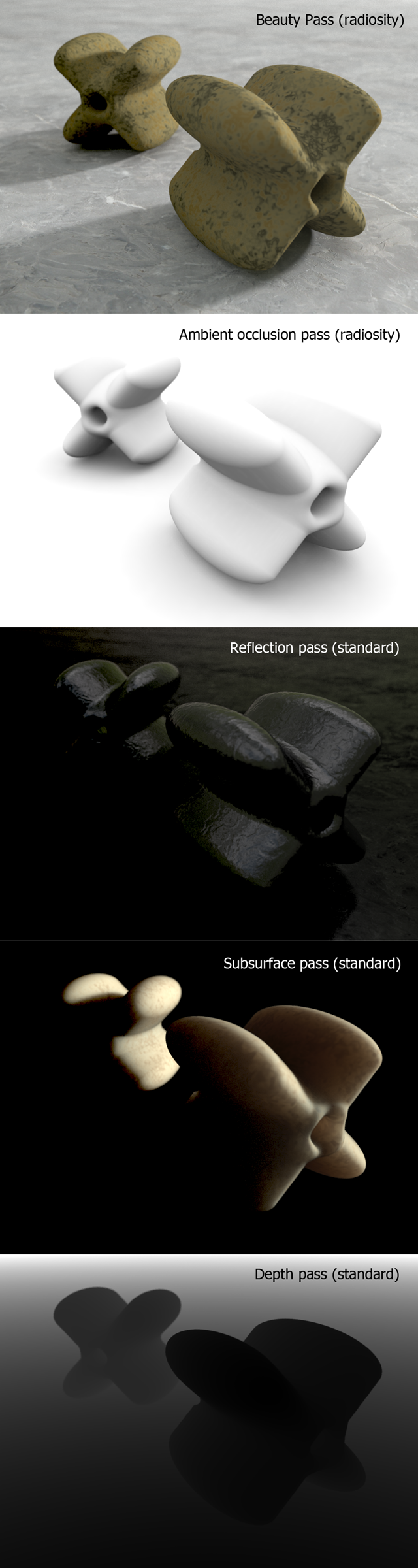

So, here's an example shot of the "blob with negative strength" from the
pvengine64 "Insert" menu, using five separate render passes. After I clean up my
code a bit I'll make it available; I'm pretty excited about this, so I'm also
planning to write a how-to for the wiki. Comments, thoughts, etc. regarding this
technique are greatly appreciated.
Cheers,
Rob
www.McGregorFineArt.com
Download 'blobrenderpasses.png' (811 KB)
Preview of image 'blobrenderpasses.png'

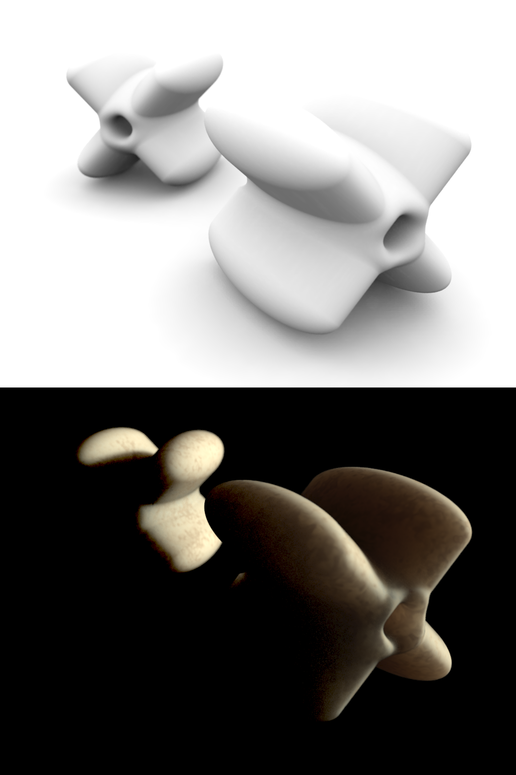

And here are full-size versions of the ambient occlusion (radiosity) and SSLT
(standard) passes...
Download 'blobrenderpasses_ao_sslt.png' (338 KB)
Preview of image 'blobrenderpasses_ao_sslt.png'

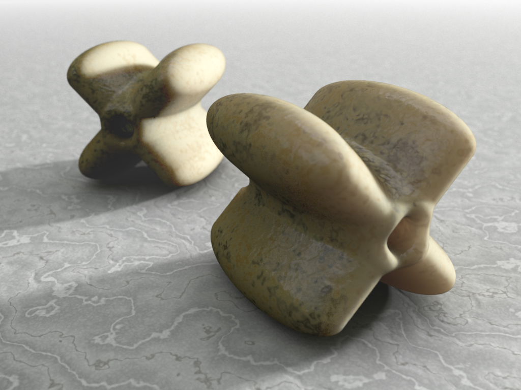

And here's the final SDL composite :)
Download 'ssltmultipasscomposite5.png' (3387 KB)
Preview of image 'ssltmultipasscomposite5.png'

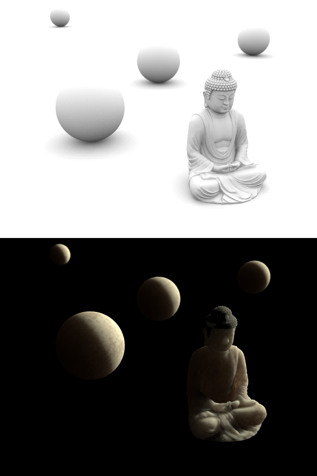

Here's a similar test using Buddha and some balls, AO and SSLT.
Download 'buddha_balls_ao_sslt.png' (321 KB)
Preview of image 'buddha_balls_ao_sslt.png'

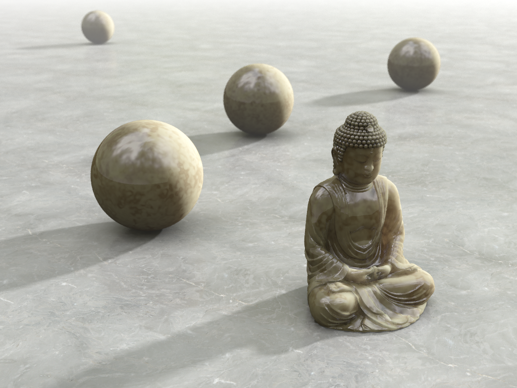

And here's the Buddha Balls final comp
Download 'ssltmultipasscomposite5.png' (998 KB)

Here's a version with no image maps or HDR - completely SDL procedural.
I only needed to re-render the beauty and reflection passes, then run the
composite animation again. Perfect for gigs where the picky art director keeps
changing his mind about some little details like ground texture...
Download 'multipasscomposite5.png' (3659 KB)
Preview of image 'multipasscomposite5.png'
