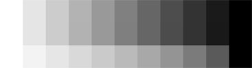

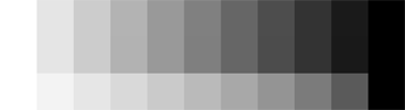

This is an example of my problems with gamma in 3.7. It's a composite of three
images.
The top is a straight-forward gradient in 10% increments done in Photoshop.
The 2nd is the test scene done with default settings in 3.6 (Display_Gamma =
2.2, no assumed_gamma).
The last is the same scene with defaults in 3.7 (Display_Gamma/File_Gamma = 2.2,
no color correction).
What one would expect to be a smooth, linear gradient, becomes in 3.7 a
parabolic curve, heavily skewed to white.
The histograms look something like this.
3.6
1                                                           0
3.7
1                                                           0
//+W1100 +H100

From: Stephen Klebs
Subject: Re: More Gamma Again
Date: 30 Nov 2010 08:50:00
Message: <web.4cf4feffa2356450fc413f510@news.povray.org>
Download 'gradient_10_pov.jpg' (26 KB)
Preview of image 'gradient_10_pov.jpg'

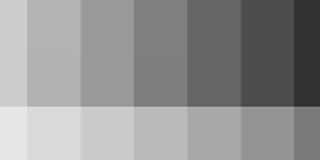

From: Stephen Klebs
Date: 30 Nov 2010 09:05:01
Message: <web.4cf50360a2356450fc413f510@news.povray.org>
Download 'gradient_10_pov.png' (4 KB)
Preview of image 'gradient_10_pov.png'
Date: 30 Nov 2010 14:05:38
Message: <4cf54b02@news.povray.org>
On my display, the top two strips looks skewed toward black, with the
two rightmost areas undistinguishable. The bottom strip does appears as
regularly stepped shades, with all shades clearly distinct from is't
neibours.
Also, the JPG and the PNG looks identical.
From: Kenneth
Date: 30 Nov 2010 16:05:00
Message: <web.4cf56644a2356450196b08580@news.povray.org>
That might be due to a slight error with your monitor set-up...and mine. :-)
I've noticed that, when using v3.6.1 and rendering a similar 0-to-100% gray
chart (and using the *old* assumed_gamma of 2.2 or just leaving it out, same
thing) that I get the same 'look' as his top two charts--but I need to carefully
adjust my monitor's gamma-related stuff (brightness and contrast) to get a good
visual separation between those two darkest bands. If my monitor isn't
calibrated properly, those two bands appear identical, same as you.
> neibours.
Yes--but, as the poster says, they are reproducing a 'parabolic' brightness
curve (his words), rather than the *expected*, *visually* linear curve.
("Expected" meaning, simply what he--and I--have been used to seeing in our
previous scenes, using assumed_gamma 2.2 rather than 1.0-- and prior to v3.7's
new gamma changes.)
I'm not saying that any of this is correct or incorrect--just *different* from
3.7. (I surely don't want to get into any late argument about the pros or cons
of the 3.7 gamma changes. ;-)
Ken

What *does* bother me a bit about your 3.7 grayscale test is that it looks
identical (or very similar) to the results when using v3.6.1 and assumed_gamma
1.0.  :-(  Yet if 3.7 is doing what it's supposed to do--and I have no reason to
think otherwise--I guess I'm just going to have to get used to that ;-)
Ken

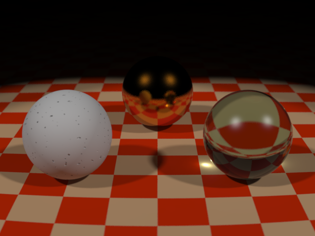

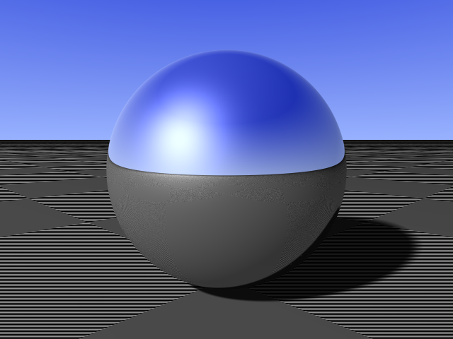

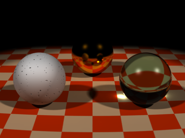

Am 30.11.2010 14:39, schrieb Stephen Klebs:
To be exact, it /does/ become a smooth, linear gradient - but our eyes
prefer a nonlinear one.
And all that is gold does not glitter - here are two scenes rendered
with POV-Ray 3.6 to showcase why we're doing it differently now.
On most displays, image "gammachecker_3.6.png" will show a chrome sphere
on a checkered plane, but there's something wrong here: The checkering
shouldn't be there - the plain grey tiles have a brightness of 0.5,
while the striped tiles have alternating lines of 0.0 black and 1.0
white, so should appear just as bright as the grey if you squint your
eyes; and in indeed both tiles appear to have the same brightness in the
reflection, where anti-aliasing computes the correct result.
Images "test_a.png" and "test_b.png" show virtually the same scene, (a)
using proper gamma handling, and (b) using POV-Ray 3.6 with
assumed_gamma 2.2; colors and finish parameters have been adjusted to
compensate, and even the light sources' brightness has been tweaked to
get the same brightness level, but still the output doesn't look as
convincing - for a reason: For instance, the shadows are unrealistically
deep. That's because when working in gamma 2.2 space, half brightness +
half brightness does /not/ add up to full brightness.
For comparison I also added a third variant of the scene, which uses the
very same values as (b) but with output gamma adjusted. Obviously the
colors in (c) are different (because the values mean something different
than in (b)), but aside from that I think it looks just as convincing as
(a).

From: Stephen Klebs
Date: 30 Nov 2010 21:40:01
Message: <web.4cf5b4c5a2356450fc413f510@news.povray.org>
> neibours.
> Alain
What do you get when you bring them into an image editing program? Look at the
histogram? Just the numbers. Do the pictures that look like smooth gradients
have a LAB or HSB progression of like (0, 0, 10), (0, 0, 20), etc.?

Sounds fine. Your intentions are admirable. Your science is impressive. But I
always seem to hear a lot of uncertainty in your final tone. The system is so
interrelated you obviously appreciate how hard it is to know how it will turn
out. When I tried to reproduce in 3.7 Steve Gower's wonderful "Bucket of
Seashells", however, using every possible gamma/version/ambience whatever I
could think of, I was surprised how dramatically different everything looked.
The smooth beach turned into a pile of large boulders. The light on the water
looked fake and glaringly over exposed. Parts of the seashells lost all their
beautiful gradations and were just black.
