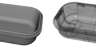

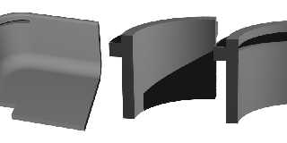

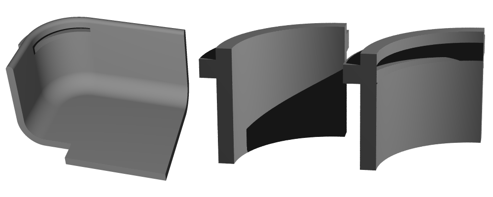

In the following picture;
 the corner of the soon to be glass container,
 useing union,
 useing merge.
The fix for the problem is to change the second tube object to avoid the
co-incident surface.
Why is there a difference between a union and merge in this scene?
Download 'test_csg_merge_union.png' (34 KB)
Preview of image 'test_csg_merge_union.png'
From: clipka
Subject: Re: CSG merge/union test
Date: 12 Jun 2010 13:17:02
Message: <4c13c10e$1@news.povray.org>
Am 12.06.2010 17:33, schrieb StephenS:
Essentially, POV-Ray's "merge" works by ignoring all intersections that
lie inside other CSG members.
Note that this applies to /all/ intersections, including the very first
one. So in case of coincident surfaces, it all boils down to whether
POV-Ray considers the surface of an object to be part of its inside: In
that case, any intersection point on the coincident surface with member
A is considered "inside" member B and vice versa, so both intersection
points are discarded. Add the problem of precision to this, and you know
that you're generally screwed.
For some objects - e.g. cylinders - there's good news: The algorithm to
find an intersection point and the algorithm to test whether a point is
inside go together pretty well, so that the surface of a cylinder seems
to /always/ be considered "outside" the cylinder.
The bad news is that when differencing away a cylinder from some other
object, the surface of the cut-away cylinder is /always/ considered
"outside" the cylinder, and thus "inside" the resulting CSG object. Have
two such CSG difference objects with coinciding surfaces, and you get
the aforementioned problem that the surface of A is considered inside B
and vice versa, and therefore to be discarded in a merge.

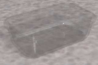

Merge{} is not helping me if I use difference{} inside to make some of the
parts. I can remove some of the internal surfaces, but not all.
Will start to look into lathe{bezier_spline}} and prism{bezier_spline}} with
merge{} holding no other CSG's.
Stephen S
Download 'glass_container_pair.png' (111 KB)
Preview of image 'glass_container_pair.png'

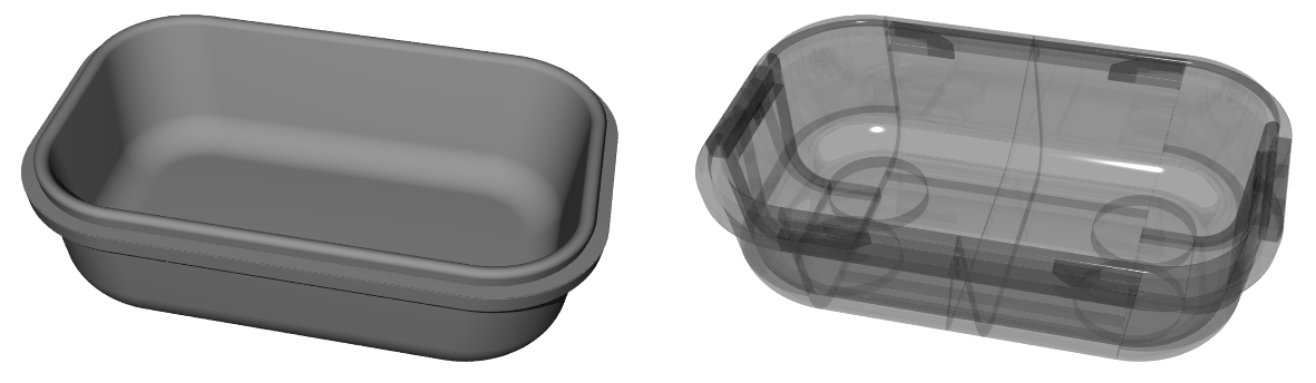

Update;
Some more work to do on the top inside edge, and some text on the bottom.
Will then be ready for the top.
Stephen S
Download 'food_containers_0000.png' (217 KB)
Preview of image 'food_containers_0000.png'
