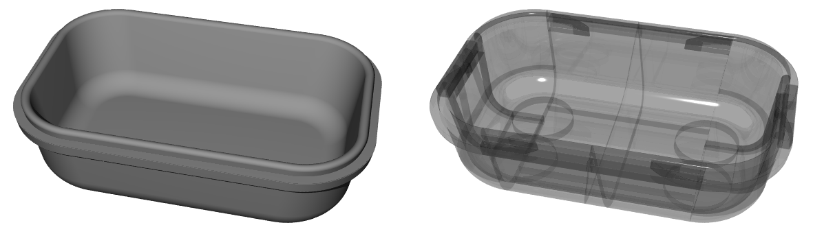

In an attempt to model a glass food container with locking lid, I can across the
following behaviour.
There is a different result when useing merge or union in the following scene,
which I was not expecting. I think it comes down to this setup which contains a
co-incident surface.
intersection {
 merge {        // union
  difference { }
  difference { }
 box { }
Removing the co-incident surface fixes the problem, but why is there a problem
to begin with? Useing a difference{} with two boxes instead of the intersection
did not change the result.

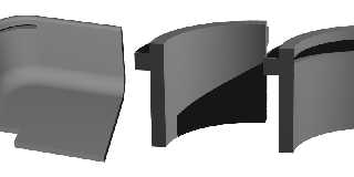

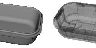

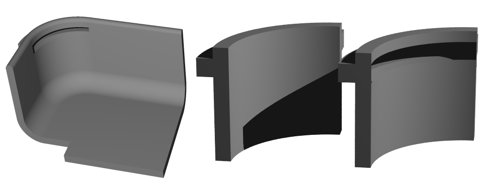

In the following picture;
 the corner of the soon to be glass container,
 useing union,
 useing merge.
The fix for the problem is to change the second tube object to avoid the
Why is there a difference between a union and merge in this scene?

Am 12.06.2010 17:33, schrieb StephenS:
Essentially, POV-Ray's "merge" works by ignoring all intersections that
lie inside other CSG members.
Note that this applies to /all/ intersections, including the very first
one. So in case of coincident surfaces, it all boils down to whether
POV-Ray considers the surface of an object to be part of its inside: In
that case, any intersection point on the coincident surface with member
A is considered "inside" member B and vice versa, so both intersection
points are discarded. Add the problem of precision to this, and you know
that you're generally screwed.
For some objects - e.g. cylinders - there's good news: The algorithm to
find an intersection point and the algorithm to test whether a point is
inside go together pretty well, so that the surface of a cylinder seems
to /always/ be considered "outside" the cylinder.
The bad news is that when differencing away a cylinder from some other
object, the surface of the cut-away cylinder is /always/ considered
"outside" the cylinder, and thus "inside" the resulting CSG object. Have
two such CSG difference objects with coinciding surfaces, and you get
the aforementioned problem that the surface of A is considered inside B
and vice versa, and therefore to be discarded in a merge.

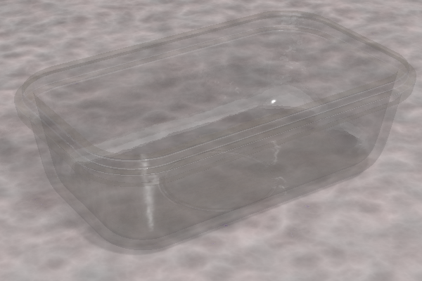

Update;
Some more work to do on the top inside edge, and some text on the bottom.
Will then be ready for the top.
Stephen S
