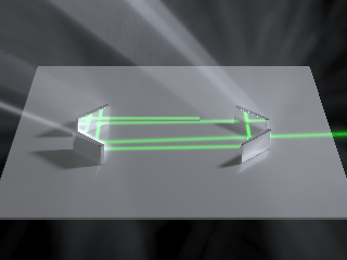

re: Blue Herrin's code:
Subject: Re: Laser Light Source with Photons...
Date: 18 Jul 2008 14:53:33
Message: <4880ae6d$1@news.povray.org>
basically rgbft to reflector
Download 'llasereflect3.png' (4 KB)

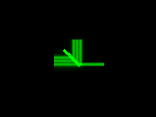

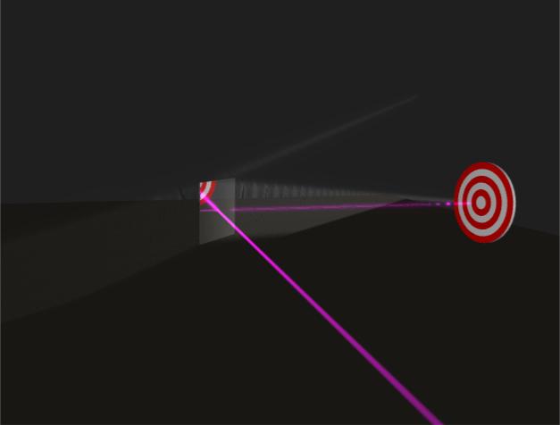

I wonder if another program, not POV, was used here:
http://www.imagico.de/pov/meta/block_neg.jpg
Lighting this scene for shadows inside this media filled sphere presents a
number of problems.
Is there a way?
Download 'lasereflect6.png' (6 KB)
Preview of image 'lasereflect6.png'
From: Jim Holsenback
Subject: Re: blue's code
Date: 21 Jul 2008 09:01:55
Message: <488488c3@news.povray.org>

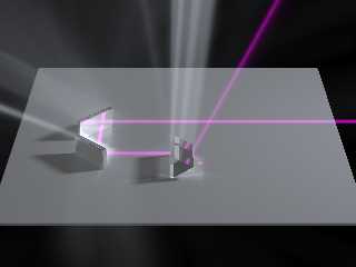

"alphaQuad" <alp### [at] earthlinknet> wrote in message
news:web.4881fcd12dc5bc4e68c5136d0@news.povray.org...
> number of problems.
yes I've seen this as well .... I wanted to throw some light (is there a pun
there?) onto the target so I added another light source (media_interaction
off) then included it in a light_group with the target as the lone member of
that light_group (global_lights off). the target just has pigment no finish
block (reflection is 0 unless otherwise specified right?) yet it looks like
light is indeed making it off the target enough to fire up the media. the
light_group light source is parallel and has point_at set to the center of
the target. pardon the spotty nature of the media, I have samples reduced by
a factor of ten while testing, otherwise it takes about an hour for each
test.
a difficult lighting challenge indeed.
Jim

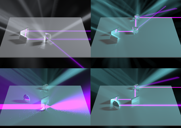

"a difficult lighting challenge indeed" ONLY when you cant think of what to do,
as was my case. I saw "media_interaction off", doh! Seen it before but didnt
think of it. this one in only 20 minutes, no AA.
code available if anyone has computer muscle and wants to play.

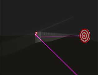

somethings says I need to calc prism reflection angles.
anyone need a prism?
#declare _prism = prism {
linear_sweep
bezier_spline
0.44, //top
0.0, //bottom
12 ,
<0.22,0>,<-0.22,0>,<0.22,0>,<-0.22,0>,
<-0.22,0>,<0.0,0.38106>,<-0.22,0>,<0.0,0.38106>,
<0.0,0.38106>,<0.22,0>,<0.0,0.38106>,<0.22,0>
Download 'lasereflect_02.png' (44 KB)

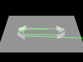

current prism material cuts light by 50%
concave reflectors dont focus, small diameter light at least.
convex lenses focus
Download 'lasereflect03.png' (206 KB)

Thank you.
Concave reflectors focus.
(was a CSG fopah I made)
flat surfaces produce photon flotsam
next image should be sweet, 18% complete and 14 minutes into it, thats good.
(Its the 3 hour renders that make me blue)
