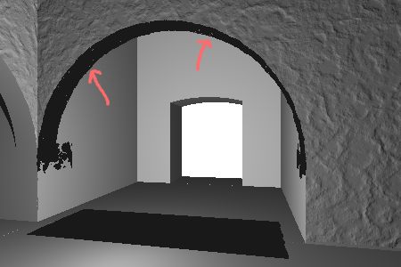

I'm trying to make a room with stucco by subtracting out isosurfaces. As you can
see in this test render, in the room where the camera is located the stucco
renderes as it should. However, the arrows pointing toward the archway show an
area that is subtracted out but is rendering in all black. Anyone encounter
this before with a solution?
Download 'error.jpg' (20 KB)
Preview of image 'error.jpg'

I'm sure you have your reasons for making an entire house from
isosurfaces! I'd like to see how this turns out :)
Could you show us your code, so we can pin down the cause of the black
areas? The solution could be a simple thing, such as raising the
max_gradient.
Sam

I can't help but ask why, why not simply normals?  it's not even a close up...
there's enough issues with coincident surfaces in plain CSG, put isosurfaces to
the mix and you're asking for trouble...

once I had this problem with coincident surfaces. But I can't see any in
your code.

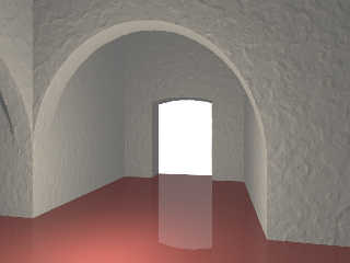

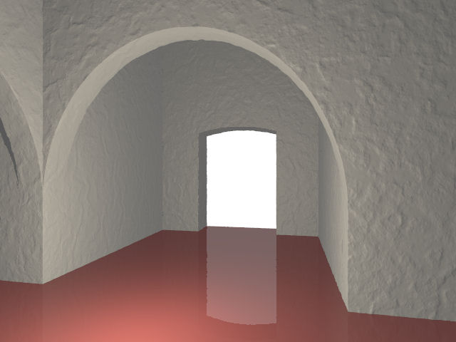

From: Tim Attwood
Subject: Re: Rendering issues
Date: 13 Jan 2008 03:06:56
Message: <4789c6a0@news.povray.org>
> you can
> stucco
> show an
> encounter
Sometimes isosurfaces do that when they are used in
differences. Fortunately you can just put the differences
into the formulas for the isosurfaces...

Download 'iso_room.jpg' (39 KB)
Preview of image 'iso_room.jpg'
