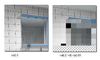

I'm trying to improve aliasing in my small images. The problem is that when
I render at small resolutions (< 800x600) the result always has aliasing in
the thin lines, but when I render at high (> 3000x1500) the problem is
solved.
I've tried with:
Option 1: +a0.1
Option 2: +am2 +r8 +a0.01
And the problem persist in both images (as you can see in attached file).
Render at high resolution and resize is a solution, but I ask:
(In order to don't lose time)
Thanks,
JSR.

It's simple.  At the lower resolution, one pixel will be to one side of
the thin line of grout, and the other pixel will be to the other side of
the thin line of grout.  Both pixels hit the tile instead, and because
they come out with very close rgb values, the renderer sees no reason to
anti-alias further.
At the higher resolution levels, the thin line gets hit at least once by
a pixel, and the aa settings see it through to the right result after that.
Your solutions are:
1.  Set the aa threshold to zero, and the sampling method and depth so
that every primitive gets hit when it is part of any pixel.  This will
make things take longer.
2.  Render at a much higher resolution with no aa at all, and then use
some kind of post-processing to combine each block of pixels into a
final pixel.
3.  Patch POV-Ray so that you can specify a higher level of aa for
certain regions, and lower settings for others.
John

	Those two solutions are equivalent: rendering with a aa threshold
of 0 means that POV will always go to the maximum depth and average
the results, which is more or less equivalent to rendering at a
higher resolution and downscaling.
	The best solution is to combine the two: render at a slightly
higher resolution so that at least one ray will always hit the thin
groves, but with some aa so that the results are refined where
needed. Then downscale in an image processing app. This is more or
less equivalent to being able to specify a minimum aa level (which
AFAIK isn't possible).
		Jerome
