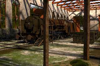

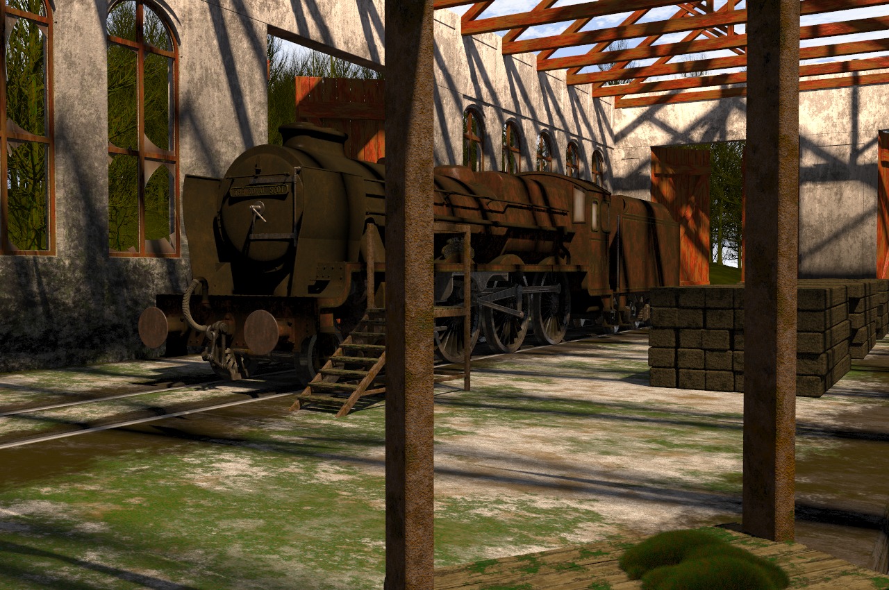

Hi,
This is my entry for the latest IRTC competition. Any comments/critism
welcome, I couldn't seem to get the level of realism I was after, probably
the textures more than anything else. I tried lots of variations but it
still looks very fake. Still I am quite pleased with the outcome. The train
was moslty modelled before the topic was announced I just finished off the
coal truck and a few other touches then had to texture it to make it look
old. (I will restore it later for any concerned train fans..) Everything is
CSG (apart from the trees which are Arbaro), nearly 12,000 lines in total..
Sean

The main thing I have to say is that this is great. :-) I love that engine!
*Very* nice use of CSG. (The broken glass in the windows is nice, too.)
Off the top of my head, the walls could use some more stains. Presumably the
now-roofless shed has been exposed to wind and rain, and this should show.
Come to think of it, some extra twigs and branches spread on the floor
would be nice. If you're a little more ambitious, maybe add some
moss/cobwebs hanging from the ceiling beams?
I'm guessing that the green marbling is supposed to be moss on the ground,
but it doesn't look a whole lot like moss. It might pass for lichen. I
really like the moss clumps in the foreground--maybe spread some more of
those around?
The locomotive could use some better rust textures, but overall you did a
very good job with it. It's mostly the building that needs work, I think.
Overall, I'd say your appraisal is on the mark. Everything is superb except
the textures. :-) It's a very nice image so far--much nicer than most of
mine. ;-)
William

That's pretty much what I wanted to/want to add to the image (hadn't thought
about the cobweb and I have an old scene with a web in it which could be put
to good use there.. Also I did think if I am going to have lots of broken
windows I really need some broken glass on the floor (There aren't many
hooligans who sweep up after throwing stones through your windows)
> those around?
I did try this but the scaling just didn't seem to work well with the moss
which is why I added the foreground object with moss on to get a close
enough look at it. When viewed at low res it just didn't seem to work well.
Also the moss has a lot of mesh objects which was starting to take me to the
limit of my PC's memory (1GB) when using radiosity etc. so as it didn't look
all that great I decided to just stick with the textured effect.
> mine. ;-)
> William
Thanks for the comments. When I started modelling the train I had planned it
to be nicely polished with only minimal amounts of dirt/rust so I guess I
just didn't want to wreck it too much after all my hard work ;-)
I don't think I will have time to add your suggestions before the IRTC
deadline but I will keep on trying to get a bit more realism out of this
scene as I think it should be better.
Sean

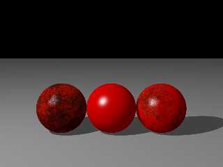

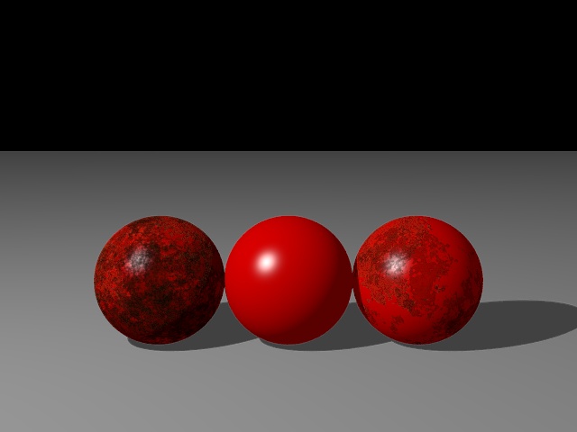

Hi,
The textures are all procedural and I think for this scene are maybe a bit
too overworked. This is one of the aspects I am not too pleased with at the
moment. The full source will be available on the IRTC website to download
but the technique is quite simple.
I just texture an object as it would look if it were new/clean then layer
any number of transparent textures over the top of this (normally using a
wrinkle pattern an with a normal) Adjusting the omega/lambda and sometimes
the wave typw help as well. e.g

#declare plasticTex=texture
        pigment { rgb <1, 0, 0> }
        finish { phong 1 }
plane { y,-5 texture { pigment { rgb 0.5 } } }
sphere { <0, 0, 0> 5
        texture { plasticTex }
        texture { dirt }
        translate <10, 0, 0>
        texture { dirt }
        texture { dirt rotate <20, 30, 100> }
        texture { dirt rotate <60, 130, 20> }
        texture { dirt rotate <200, 30, 300> }
        translate <-10, 0, 0>
produces the image below.
NB: The textures in the train scene are a bit more complicated than this and
use a lot more layers and then a texture_map with a gradient to fade from a
really dirty texture to a cleaner one as it travels up the wall.
Sean
Download 'texdemo.jpg' (34 KB)
Preview of image 'texdemo.jpg'
