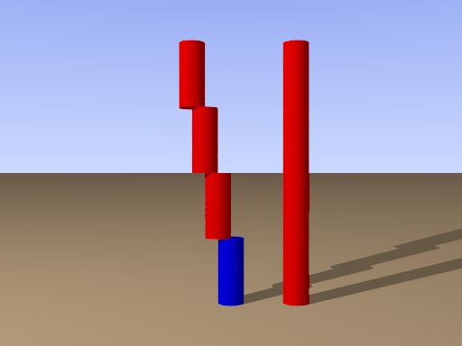

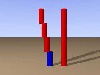

I've posted in the past about learning to create a tree macro all by myself.
 My trouble at this point is to figure out how to attach each block of truck
to each other when shifted out of alignment, a la not a perfectly straight
truck.
If you look at the attached image, you'll see I've got a cylinder broken
into four chunks, along with a solid cylinder next to it.  I want this to
be my trunk.  I'm looking to find out how to properly locate the beginning
and end points of each chunk.  That way, I could properly rotate each chunk
to meet up with the one below it.
Can anyone give me some help?  Thanks!
Download 'new_tree.jpg' (12 KB)
Preview of image 'new_tree.jpg'

If you know the coordinates of each point of the trunk, you don'tneed to
rotate cylinders.  Cylinders do not need to be created vertical. Just
specify the start and end coordinates and you are done.
-tgq

That's exactly my goal, but also the crux of my problem.  How am I going to
track the start and end coordinates?
.... This may become a rather moot point as I find it MUCH quicker to use
POV-Tree.  Nonetheless, I'm really curious about how to do it from scratch
for the learning potential.

Maybe recursion is what you need?  That's my first instinct for anything
that has multiple levels of sub-branches.  (I know for a fact that
recursion works in POV-Ray.)  Are you familiar with that technique?

The edges of the cylinder are going to jut out aren't they?  Maybe a
different shape should be used?  Sphere sweeps perhaps?  Although they
would probably bring the render to a screeching halt.  How about a mesh
object?  Then you can have a macro to define the number of faces around
the trunk (ie an octagon tree or something with a lot more faces to make
it look smooth).  You could could easily connect vertices as the tree
trunk curves, shrinking the radius as the tree goes to the top.  I'm not
entirely sure how to mesh the branch intersections smoothly though (I
guess they could just overlap).  The path of your tree trunk and
branches could be defined with a spline.  Then you'll have a nice
curving shape to start with, and picking start and end points for your
cylinders merely involves evaluating the spline at the spline intervals
you need.
Skip

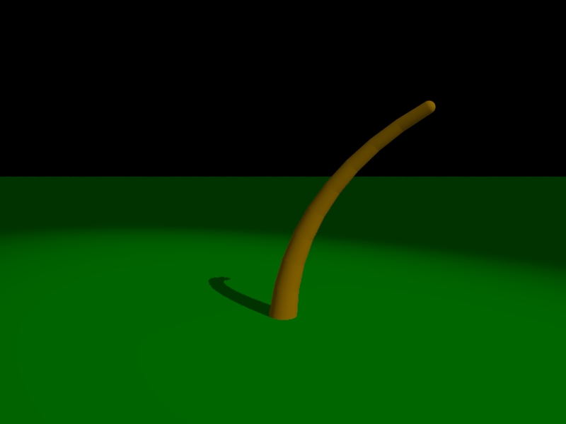

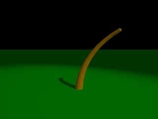

I tackled this same problem a few years back.  My solution was to use a
recursive call.
global_settings {
    assumed_gamma 1
light_source {
    <1000, 1000, 1000>
    color rgb 1
    spotlight
    point_at 0
    radius 1
    falloff 5
camera {
    location <120, 40, 0>
    look_at <0, 30, 0>
plane {
    y, 0
    pigment {
       rgb <0, 0.3, 0>
#macro bloblike (lrad, srad, length)
    union {
       sphere {
       	 0, lrad
       sphere {
       	 <0, length, 0>, srad
       cone {
       	 0, lrad
#end
#macro bloblike_run (number, cnt, lrad, length, bend, twist)
    #local srad = lrad * 0.9;
    #if (number = 1)
       object {
    #else
       union {
	 bloblike_run (number - 1, cnt, srad, length, bend, twist)
       	 object {
	 rotate <bend, twist, 0>
	 #if (number != cnt)
	    translate <0, length, 0>
	 #end
    #end
#end
object {
    bloblike_run (10, 10, 4, 8, 7, 6)
    pigment {
       rgb <0.4, 0.2, 0>
Download 'tree.jpg' (31 KB)
Preview of image 'tree.jpg'

You can use cones, maybe with spheres at the junctions.
If you use sphere_sweep, limit the lenght.
Using mesh is a prety good solution if you have several trees, like some 100's
or more.
Make 1 or 2 close trees with cones or many sphere_sweep. Then, you use 2 ot 3
different, scaled and randomly rotated mesh trees for the bulk of the forest.
