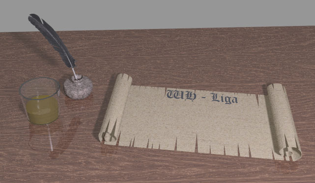

....to say the least. :(
Please, can someone advice me in finding the proper setting for this image.
The content of the glass should be whisky.... But I just cant get the color
right, or the proper "shine-thru". :/
And, besides, my pictures always have like a dull filter. *boo-hoo*
Any hints on what one should remember to avoid this?
This is the setting for the glass. Yep, it's the one from the documentation
atm:
// A simple water glass made with a difference:
#declare MyGlass=
difference
{ cone { <0,0,0>,1,<0,5,0>,1.2 }
  cone { <0,.1,0>,.9,<0,5.1,0>,1.1 }
  material { M_Glass3 }
#declare MyGlassWithWater=
union
{ object { MyGlass }
  intersection
  { cone { <0,.1,0>,.9,<0,5.1,0>,1.1 }
    plane { y,2 }
    scale .999
    pigment { color rgbft <0.3647,0.2862,0.0156,0.5,0.5> }
    normal {ripples 0.5 scale <0.25,0.5,0.25> }
  //  finish {Phong_Glossy}
object {MyGlassWithWater scale <5,2,5> translate <-25,-5.4,9> }
Download 'whligarullraal.jpg' (74 KB)
Preview of image 'whligarullraal.jpg'

Looks to me like the boring grey wall is just reflecting in the table making
it look washed out.  Try making the wall a bit more interesting (maybe some
pattern and some other objects like a doorway, window, picture, light
switch, shelf etc etc).  Have you got assumed_gamma set to 1.0 in your file?
As for the liquid, I am no expert (at whisky or POVing liquids) but it seems
you need to make it much more transparent, and adding photons will make it
look more realistic.  Check you have max trace level set high enough for
light to get all the way through the liquid and glass.
After you get that sorted, I would make the lights a bit brighter, at the
moment there isn't really anything getting near maximum brightness, so not
only does it looked washed out (due to lack of blacks) it also looks
underexposed due to lack of whites.
If you merge a torus onto the rim of your glass it will look much better.

Well, using photons and increasing maxtracelevel turned out to be very
improving. Thanx both of you!!

Your "wisky" is only coloured on it's surface while real wisky is coloured all
the way trough, but not "on" it's surface.
First, make an empty glass.
Now, model it content, make a very little smaller to prevent coincident surfaces.
Give it texture{pigment{rgbt 0.95}finish{reflection{0.1,0.9 fresnel}ambient 0
diffuse 0.1}}
Give it an interior: interior{ior 0.32 dispersion 0.02
fade_color<0.3647,0.2862,0.0156> fade_distance 0.4}// I used your colour
It will give you a content that is almost completely transparent, experiment
with the pigment to fine tune it. A pigment on the surface of a transparent
object give a bubble like effect with no feeling of substance.
Wiskey ior is a little lower than that of water.
The key is fade_color and fade_distance. This give you a better feel of
substance, the final colour is dependent on how long you travel into the
substance. Adjust fade_distance as needed if it's to dark or light.
At the feast of ego everyone leaves hungry.
Put "ambient 0" in your finish.

...or add: default{finish{ambient 0 diffuse 1}} early in the scene.

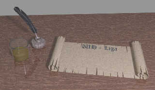

Thanks a lot guys! No matter how much documentation you (I) read, there's
always something that's slippes by unnoticed...
I've reached a satisfactory result, and I went as bold as to post it as a
new topic(!) Thanks again all of ya!
