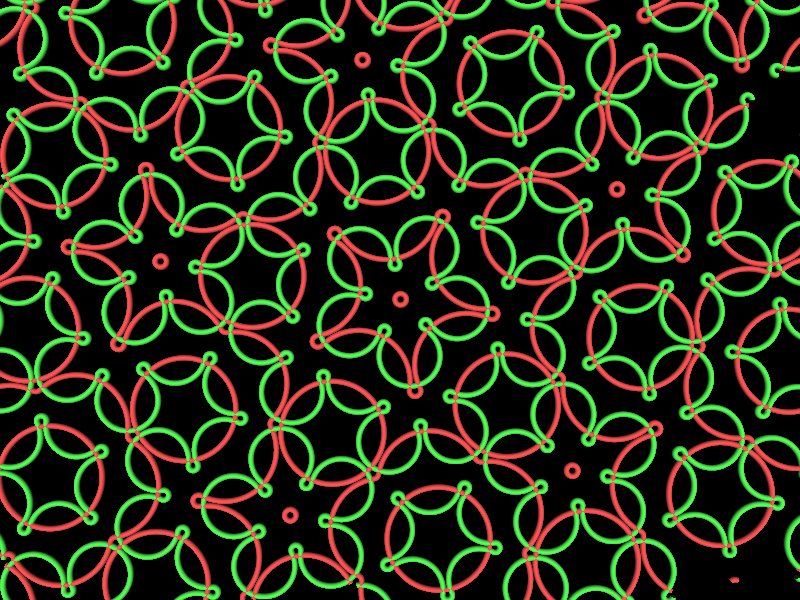

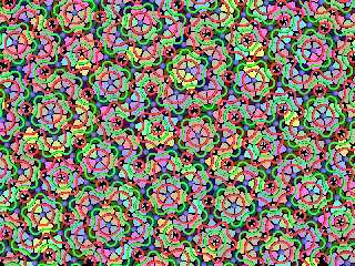

Download 'penrose0.png' (565 KB)
Preview of image 'penrose0.png'

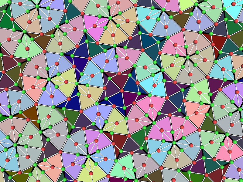

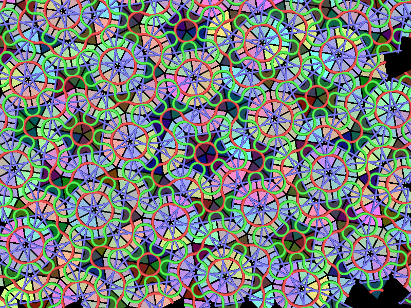

Anyway, here's the image with Kites, Darts, standard curves, and Ammon Bars.
Download 'penrose1.png' (624 KB)
Preview of image 'penrose1.png'

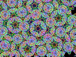

This image has just the curves in kite and dart tiles, but they have been
offset a bit.
Download 'penrose2.png' (385 KB)
Preview of image 'penrose2.png'

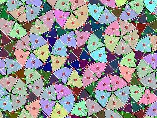

This image has one level of Kites and Darts colored in, and the next level
outlined in white cylinders.  The colored balls are used to force the
proper tiling patterns (instead of the curves in the last image).
Download 'penrose3.png' (326 KB)
Preview of image 'penrose3.png'

"Janet" <par### [at] attnet> wrote:
> Wow! Thanks! This looks wonderful. I love the ones with the curved torus
> shapes - the "Conway lines"?? I will play. Its like having a new toy. It
> looks really clean too :)
Thanks, let me know how the playing goes.  I like the curves too.  Take a
look
at "Pathways" in the 2004 POVcomp.  That kind of image is why I did this.
Now if I only had the artistic eye and talent to get the rest of the way
there!  (Computer Science majors aren't always known for their artistic
abilities. 8^)
The next thing I plan to add is a group of objects to do with edges what the
existing macros do with vertices.  That is, all the ways you can put two
tiles together on a single edge, instead of all the ways you can put tiles
around a single point.  I think that set might help if someone wants to
create a new curve through the tiling.

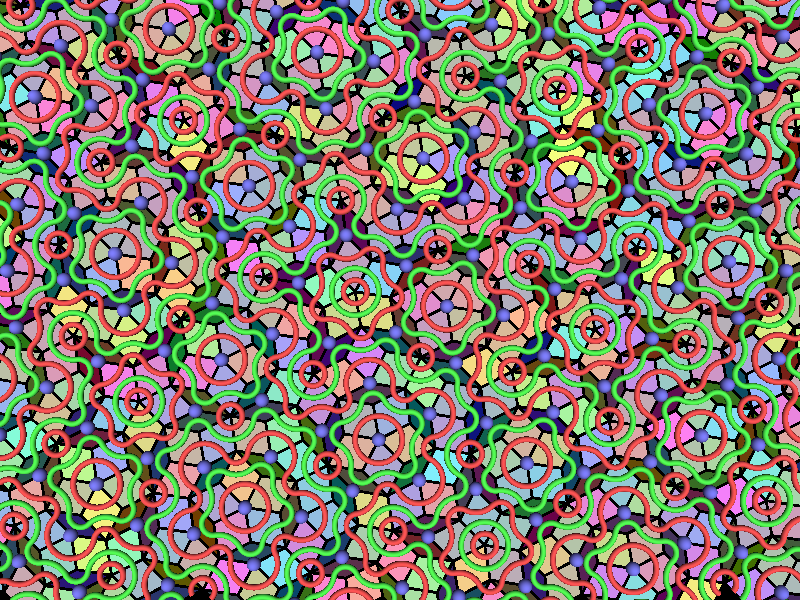

Among other things, Jon Buller saw fit to write:
> Bars.
Magnificent!
Are the bars/lines supposed to be straight? They don't look so...
light_source{9+9*x,1}camera{orthographic look_at(1-y)/4angle 30location
9/4-z*4}light_source{-9*z,1}union{box{.9-z.1+x clipped_by{plane{2+y-4*x
0}}}box{z-y-.1.1+z}box{-.1.1+x}box{.1z-.1}pigment{rgb<.8.2,1>}}//Jellby
From: Jon Buller
Subject: Re: Penrose Tile Macros
Date: 25 Jun 2006 18:35:00
Message: <web.449f0d666376349e2ff3aa640@news.povray.org>
> > Bars.
> Magnificent!
Thank you.
Yes, the blue bars/lines are supposed to be straight, but taking a closer
look, I see the pixeled edges change spacing a bit from one spot to another.
A sure sign that the slope of the line is changing slightly.  Must be either
floating point round off error, or the points where the bars intersect the
tile edges weren't described accurately in the source I coded them from.
Jon

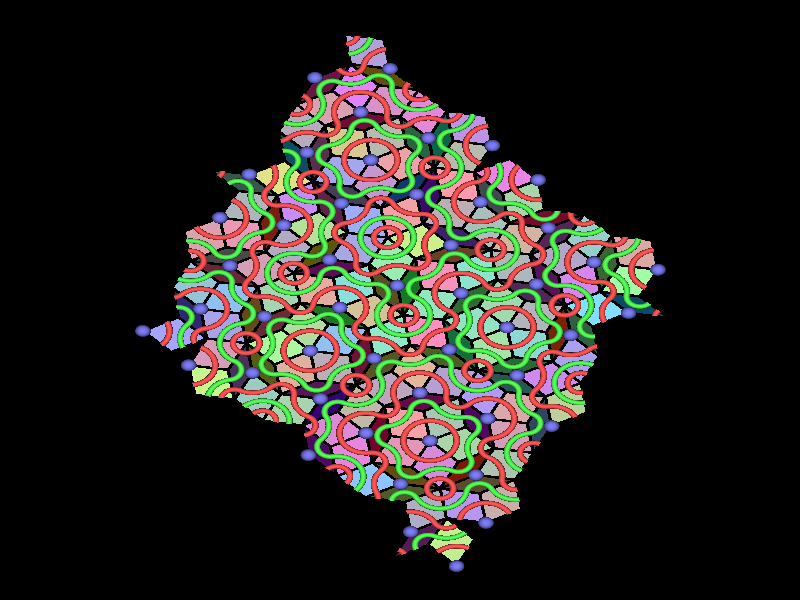

OK, I now see that doing Rhomb tiling is simple without any duplicate
detection. (That is, the inflation doesn't overlap it's neighbors, and it
works without using that init_inflate macro and friends.)
Consider this:
#macro tri (pos, ang, typ, level)
  #if (level < 1)
    PENROSE_triangle (pos, ang, typ)
  #else
    #if (abs(typ) = 18)
      tri (phi * (pos + vrotate (x, (ang - typ) * y)),
           ang + typ * 6, typ,     level - 1)
      tri (phi *  pos + vrotate (x, (ang + typ) * y),
           ang - typ * 6, typ * 3, level - 1)
    #else
      #local new = phi * pos + (phi - 1) * vrotate (x, (ang + typ) * y);
      tri (new, ang,             -typ,     level - 1)
      #local new = new + vrotate (x, (ang - typ) * y);
      tri (new, ang - typ * 8/3,  typ,     level - 1)
      tri (new, ang + typ * 8/3, -typ / 3, level - 1)
    #end
  #end
#end
Call this as the others, pos and ang are the location and orientation of the
triangle, level is how many inflate operations to do.  That typ parameter is
the size and orientation of the triangle.  It takes values of -54, -18, 18,
and 54.  To draw a triangle, draw unit length edges from pos in the
direction of ang + typ and ang - typ (and connect those two points for the
final edge).
It is simple to draw the triangles themselves.  But notice that if you draw
each edge (I'll call them +, -, and o) in a different color, all the
triangles have the same edge type for a shared edge.  Since a Rhomb is just
two 54 triangles that share an "o" edge, and any triangle with an "o" edge
has the neighbor of that edge that is also an "o" edge.  The other
interesting thing is that the other triangle is the negative type of its
neighbor.  So to draw rhombs instead of triangles, just ignore the negative
type triangles(-54 & -18), and treat the +54 triangles as rhombs that have
points of pos, pos+, pos-, and pos+-  (add the + and - direction vectors
together for pos+-)
Starting with a +54 triangle and a -54 triangle sharing "o" edges, and using
the rhomb generation macros from before with all the decorations on, you get
the attached image.  Note that the tri macro does not need that huge array
of true/false values to tell if it has already generated a tile at a
specific location or not, but can still generate a rhomb tiling without any
duplicate objects.
I still haven't figured out how to do Kites & Darts yet, but I think it
might be possible.  In fact, I think it's more possible now than I did when
I wrote that last message.
Download 'penrose.png' (183 KB)
