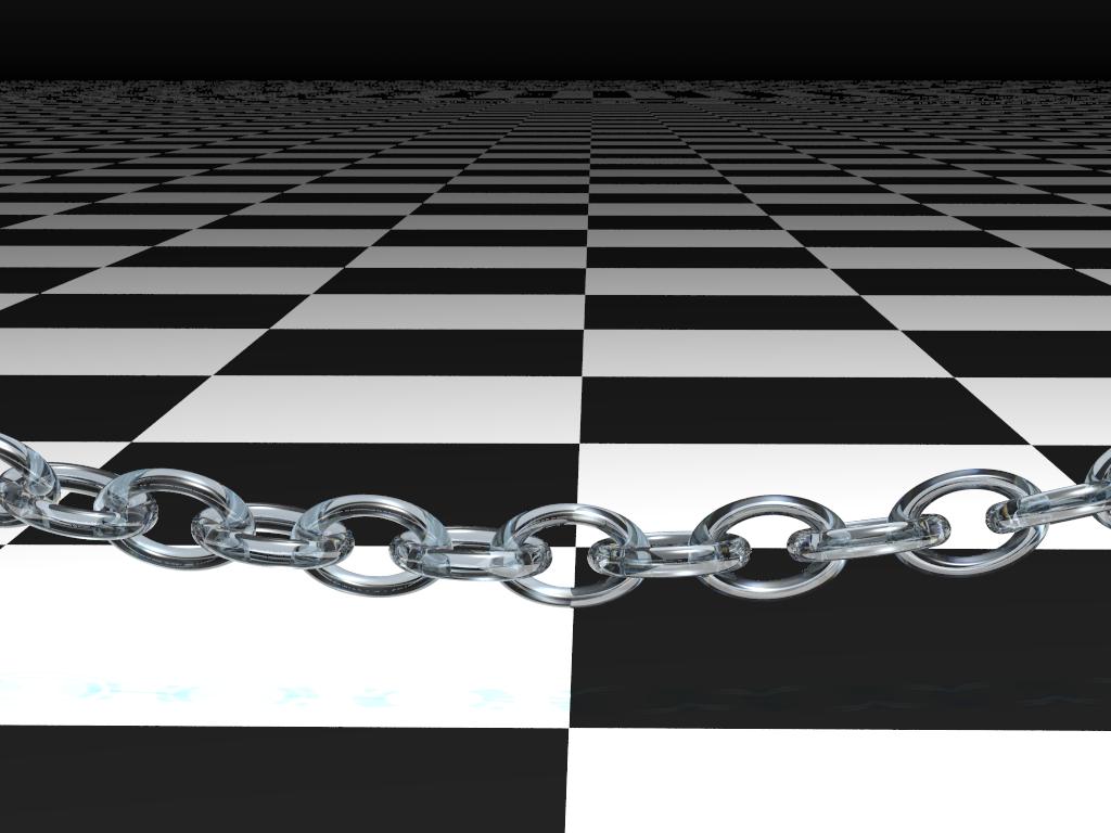

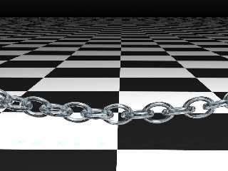

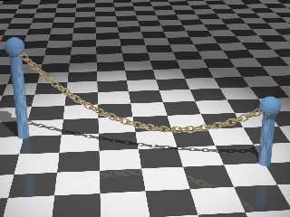

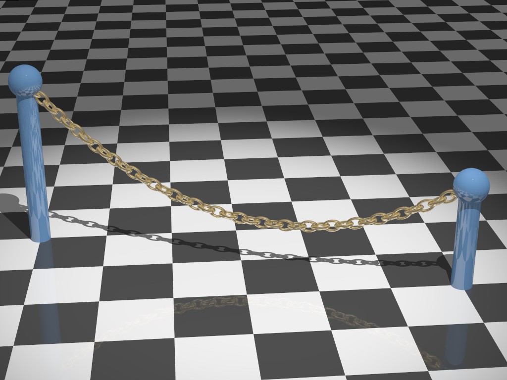

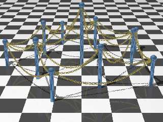

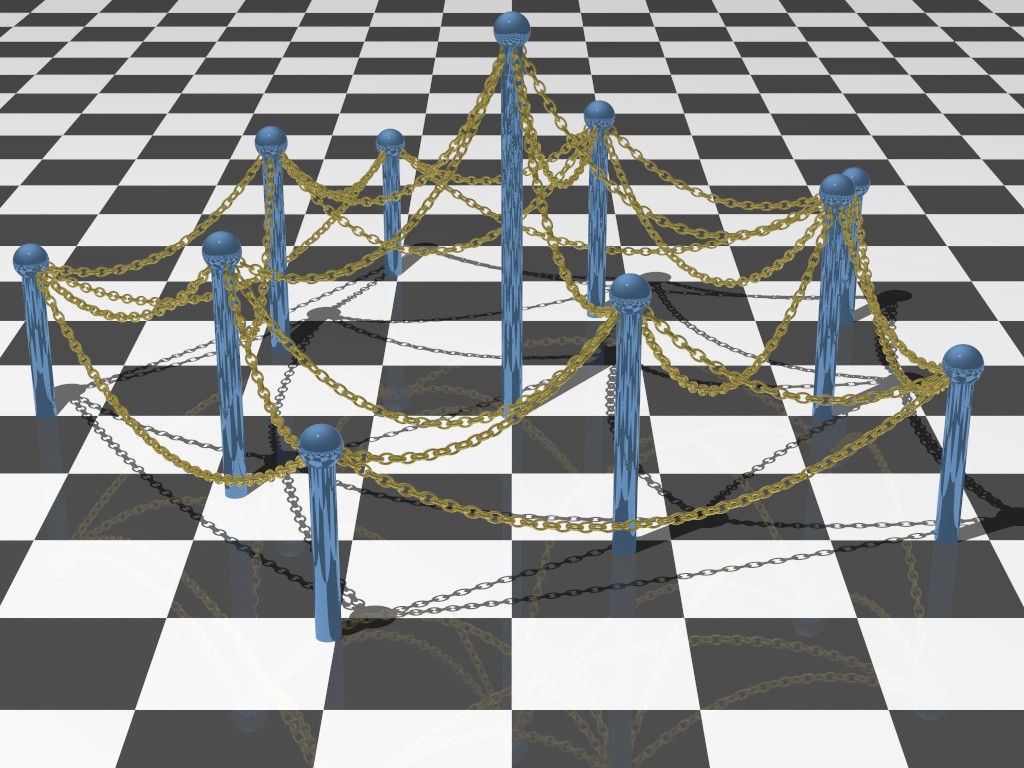

The catenary is the curve formed by a homogeneous chain suspended between
two points in a uniform gravity field. It looks like a parabola, but it's
mathematically quite different. The equation of a parabola is just
 y = a*x*x, a simple quadratic, whereas a catenary is
 y = a*cosh(x/a), a transcendental equation.
I had occasion to look at Chris Colefax's chain building code in "Linc.inc",
after referring a new user to it, and was dismayed to discover that Chris
used quadratics to build his chains. :(
The Chain() macro below constructs a true catenary. This is a preliminary
draft, so there are no docs as yet, sorry. Read the comments for hints. :)
Any questions and comments are most welcome. Have fun!

// Persistence of Vision Ray Tracer Scene Description File
// File: Catenary.pov
// Vers: 3.6
// Desc: Test Catenary include file
// Date: 2005.07.30
// Auth: PM 2Ring
// Catenary parameter calculations thanks to Zdislav V. Kovarik
// See Catenary.inc for details.
// -f -A0.4 +AM2 +R1
// -d +A0.05 +AM2 +R3
#include "finish.inc"
#include "metals.inc"
//Chain making macro
#include "Catenary.inc"
global_settings {
  assumed_gamma 1.0
  max_trace_level 25
//Simple chain macro. Parameters: Start point,End Point. Make sure other
items are declared before calling!
#macro ChainQ(Start, End) Chain(Link, Start, End, Slack, Overlap, Twist)
#end
//Chain terminal post
#macro Terminal(Pos)
union{
  sphere{Pos, PostRad*1.6}
  cylinder{Pos*<1,0,1>, Pos-0.35*PostRad*y, PostRad}
  pigment{rgb <.2, .5, 1>}
  finish{Glossy}
#end
//Chain, with terminal at start
#macro TermChain(Start, End)
  Terminal(Start)
  ChainQ(Start, End)
#end
//Link objects
#declare Torus = torus {.75, .175 scale 0.075*<1, 1, .65> }
#declare Torus1 = object {Torus scale 2 texture{T_Gold_2E} rotate 0*45*x}
//--- The scene -----------------------------------------------------------
#declare Rad = 2.0;               //Scene size control
#declare PostRad= 0.150;          //Post radius
//Chain parameters
#declare Link = Torus1;           //Link object
#declare Slack = 1.12;            //Slackness of the chain. (Length of
chain) / (straight distance between points)
#declare Overlap = 1.65;          //Link overlap
#declare Twist = 0;               //Chain twist (in cycles)
//Points to connect
#declare V1 = < 1.5*Rad, 0.75*Rad, 1>;
#declare V2 = <-1.5*Rad, 1.25*Rad, 3>;
//Do it!
TermChain(V1, V2)
Terminal(V2)
//Simple room with checkered floor
#declare WS = 5*Rad;
box{<-1, -2/WS, -2>, <1, 3, 2> scale WS inverse pigment{gradient y scale
3.001*WS}finish{Shiny}}
box{<-1, -1/WS, -2>, <1, 0, 2> scale WS pigment{checker rgb 1,rgb
....05}finish{Glossy diffuse 0.80}}
camera {
  location <-0.5, 3.5, -5.5> * 0.93 * Rad
  look_at  y*2
  right x*image_width/image_height up y
  direction z
  angle 30
light_source {<1, 9, -3>*Rad rgb 1 spotlight point_at z*2 falloff 16 radius
5 }

From: PM 2Ring
Subject: Re: True catenary

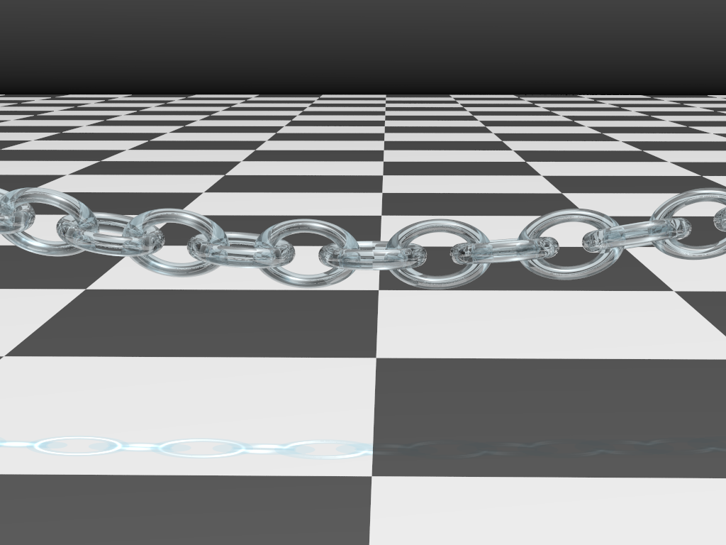

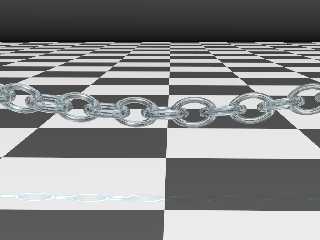

Here's a closeup of a simple glass chain, using the same link as above.
No radiosity, no photons, no dispersion, fake caustics.
Download 'catenarye5k.png' (174 KB)

From: scott
Date: 1 Aug 2005 06:51:13
Message: <42edfea1$1@news.povray.org>
> between two points in a uniform gravity field. It looks like a
> parabola, but it's mathematically quite different. The equation of a
>  parabola is just y = a*x*x, a simple quadratic, whereas a catenary is
> "Linc.inc", after referring a new user to it, and was dismayed to
> discover that Chris used quadratics to build his chains. :(
IIRC the "quadratic" chain assumes even weight distribution in the
horizontal direction, whereas the catenary takes account of the fact that a
chain at a steep angle will be heavier per unit horizontal distance.
Clearly the steeper the chain the more of an "error" the quadratic one has.
How about a comparison between the two for different length chains between
two points?
From: PM 2Ring
Date: 1 Aug 2005 09:30:00
Message: <web.42ee23965de03cff1befe64a0@news.povray.org>
"scott" <sco### [at] spamcom> wrote:
Yes, the parabola is the curve of a suspension bridge with uniform
horizontal load.
> two points?
I've been thinking about doing this, so I'll put something together over the
next day or so. It may be a little bit tricky ensuring both chains are
identical in length... it should be ok if I use very small links, though.
I also want to see the difference between the parabola & catenary with
connection points at unequal heights.
Thanks for your feedback, scott.

Here are a few positioning macros (and an iron link I borrowed from Chris
Colefax's Link.inc). The attached image is from a slightly different view
location & probably using links of a different size.
// Vers: 3.6
// Desc: Catenaries between multiple poles arranged in polygons
// Date: 2005.07.30
// Auth: PM 2Ring
// -f +A0.4 +AM2 +R1
// -d +A0.2 +AM2 +R4
// -d +A0.1 +AM2 +R3
global_settings {
  assumed_gamma 1.0
  max_trace_level 25
//Textures ----------------------------------------
#declare Shiny =
finish{
  phong .35 phong_size 320
  ambient 0.1 diffuse 0.85 reflection 0.15
#declare TChain =
texture{
  //pigment{rgb 1}
  pigment{rgb <1, .8, .15>}
  finish{Shiny metallic
  diffuse 0.25 brilliance 7 reflection {0.55, .65 metallic}
#declare TTerminal =
texture{
  //pigment{rgb 1}
  finish{
    Shiny
    reflection {0.35,.45 metallic} diffuse 0.4 brilliance 5
//Link objects
#declare Torus1 = torus {.75, .175 scale 0.05*<1, 1, .65> texture{TChain}}
//From LinkObjs.inc by Chris Colefax
#declare Iron_Chain =
union {
  torus {.7, .3 clipped_by {box {<-1, -.3, -1>, <0, .3, 1>}} translate -x *
.....6}
.....6 scale <-1, 1, 1>}
  cylinder {-x*.6, x*.6, .3 translate z * .7}
  cylinder {-x*.6, x*.6, .3 translate -z * .7}
  pigment {rgb <.4, .4, .45>} normal {dents .6 scale .3} finish {phong .3
phong_size 10 metallic}
  scale .035
#end
//#macro ChainQ(Start, End)#end  //No Chains!
union{
  texture{TTerminal}
#end
  Terminal(Start)
  ChainQ(Start, End)
#end
//-Positioning
macros--------------------------------------------------------
//Connect all points in PosList with chain. Terminate if not a ring.
#macro MultiChain(PosList)
  #local N=dimension_size(PosList,1);
  #local I=0;
  #while(I<N-1)
    #local Start = PosList[I];
    #local End = PosList[I+1];
    #local I=I+1;
  #end
  #if(vlength(End-PosList[0]))
    Terminal(End)
  #end
#end
//Connect all points in PosList to a centre post
#macro CenterChain(PosList)
  #local I=0;
  #local End = <0, 1.25*Rad, 0>;
  #while(I<N-1)
    ChainQ(Start, End)
    #local I=I+1;
  #end
  Terminal(End)
#end
//Connect all points in PosList0 to Poslist1, like threading shoelaces. No
error checking!
#macro ThreadChain(PosList0, PosList1)
  #local N=dimension_size(PosList0,1);
  #local I=0;
  #while(I<N)
    #local Start = PosList0[I];
    #local End = PosList1[I];
    ChainQ(Start, End)
    #local Start = PosList0[mod(I+1,N)];
    ChainQ(Start, End)
    #local I=I+1;
  #end
#end
// The scene ----------------------------------------
#declare Rad = 2.25;
//Link object
//#declare Link = Iron_Chain;
#declare Slack=1.35;       // Slackness of the chain
#declare Overlap=1.60;     //Link overlap
#declare PostRad=.05;      //Post radius
#declare MI = 5;           //Polygon sides
#declare InRing = array[MI+1];
#declare OutRing = array[MI+1];
#declare I=0;
#declare DT=pi/MI;
#while (I<=MI)
  #declare T = 2 * pi * I/MI;
  #declare InRing[I] = Rad*<cos(T), 0.75, sin(T)>;
  #declare OutRing[I] = 1.5*Rad*<cos(T+DT), .35, sin(T+DT)>;
  #declare I=I+1;
#end
MultiChain(InRing)
#declare Slack = Slack / 1.1;
CenterChain(InRing)
MultiChain(OutRing)
ThreadChain(InRing, OutRing)
#declare WS = 4*Rad;
3.001*WS}}
...05}finish{Shiny}}
camera {
  location <1, 4.5, -10> * 1.25
  look_at  y*0.50
  angle 30
light_source {<-2, 8, -3>*2 rgb 1}
Download 'catenaryd1.jpg' (170 KB)
Preview of image 'catenaryd1.jpg'
From: PM 2Ring
Date: 1 Aug 2005 09:55:00
Message: <web.42ee292d5de03cff1befe64a0@news.povray.org>
"Sebastian H." <van### [at] gmxde> wrote:
> Beautiful.
Thankyou, Sebastian! Now I'll *have* to do one with more realistic glass, or
maybe even diamond. :) I'll have to do it on my machine at work, this old
beast would take days.

From: PM 2Ring
Date: 5 Aug 2005 03:45:01
Message: <web.42f318b55de03cffad93754b0@news.povray.org>
"Ross" <rli### [at] everestkcnet> wrote:
> "PM 2Ring" <nomail@nomail> wrote in message
> news:web.42edf3bf208413009143b5c90@news.povray.org...
> "Linc.inc",
> Cool cool. I think about this occasionally, probably everytime i see a
> cosh()  for some reason. This is the same curve that would describe wires
> between telephone poles, right?
Yes, and catenary arches are very strong, too. Also, a catenary rotated
around the X-axis makes a catenoid, the shape of a soap-film between a pair
of parallel circular loops.
> anyway, neat work. i await the realistic glass render although the fake
> glass looked pretty too :)
Here's a more realistic one, with radiosity & dispersion. I'm doing one now
with photons; I assume it will take all weekend.
Download 'catenaryea1.jpg' (78 KB)
Preview of image 'catenaryea1.jpg'
