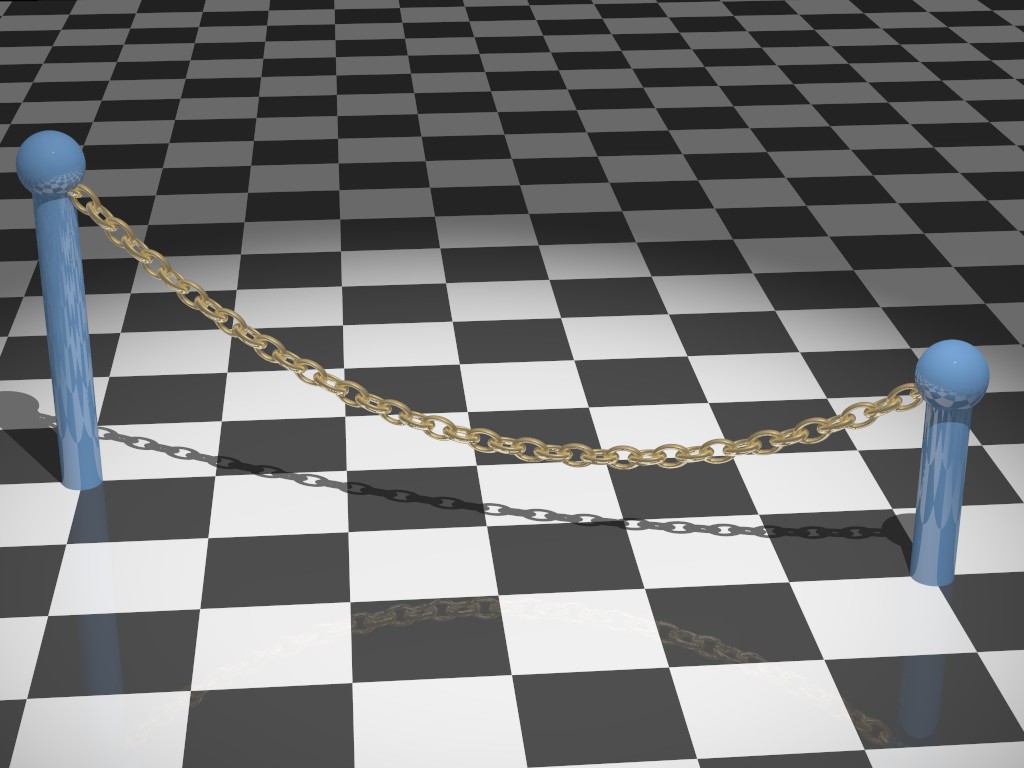

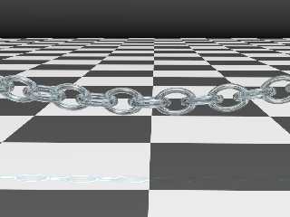

The catenary is the curve formed by a homogeneous chain suspended between
two points in a uniform gravity field. It looks like a parabola, but it's
mathematically quite different. The equation of a parabola is just
 y = a*x*x, a simple quadratic, whereas a catenary is
 y = a*cosh(x/a), a transcendental equation.
I had occasion to look at Chris Colefax's chain building code in "Linc.inc",
after referring a new user to it, and was dismayed to discover that Chris
used quadratics to build his chains. :(
The Chain() macro below constructs a true catenary. This is a preliminary
draft, so there are no docs as yet, sorry. Read the comments for hints. :)
Any questions and comments are most welcome. Have fun!
// Persistence of Vision Ray Tracer Include File
// File: Catenary.inc
// Vers: 3.6
// Desc: Proper catenary chain.
// Date: 2005.07.30
// Auth: PM 2Ring
// Catenary parameter calculations thanks to Zdislav V. Kovarik. See below
#ifndef(Catenary_Inc_Temp)
#declare Catenary_Inc_Temp=version;
#version 3.5;
#ifdef(View_POV_Include_Stack)
    #debug "including Catenary.incn"
#end
// From: kov### [at] mcmailcisMcMasterCA (Zdislav V. Kovarik)
// Subject: Re: Catenary
// Date: 5 Nov 1999 14:33:22 -0500
// Newsgroups: sci.math
// Keywords: fitting a catenary to match a suspended cable
// Upright catenary:  y - y_0 = a * cosh((x - x_0)/a) ,  a > 0.
// The vertex is (x_0, y_0+a).
// The parameter a turns out to be the radius of curvature at the vertex.
// Remark: The radius of curvature at a point above x is
//   a * (cosh((x-x_0)/a)^2.
// Problem: Parameters a, x_0, y_0 to be found so that the catenary arc
passes
// through (x_1, y_1), (x_2, y_2) and has length L between these points
// (provided L > sqrt((x_2 - x_1)^2 + (y_2 - y_1)^2) )
// The equations to be solved are (after some symmetrizing manipulation
// of the arclength integral)
//   y_1 - y_0 = a * cosh ((x_1 - x_0)/a)
//   y_2 - y_0 = a * cosh ((x_2 - x_0)/a)
//   2*a * cosh((x_1 + x_2 - 2*x_0)/(2*a)) * sinh((x_2 - x_1)/(2*a)) = L
// and it can be reduced to solving for one unknown at a time.
// First, we introduce an auxiliary unknown z which is to satisfy
//   sinh(z) / z = sqrt(L^2 - (y_2 - y_1)^2) / abs(x_2 - x_1)  ,   z > 0
// (the only transcendental non-elementary equation)
// and then the unknowns pop out:
//     a = abs(x_2 - x_1) / (2*z)
//   x_0 = (1/2)*(x_1 + x_2 - a * ln ((L + (y_2 - y_1)) / (L - (y_2 - y_1)))
//   y_0 =  (y_1 + y_2)/2 - (L/2) * coth(z).
//Find B such that A=sinh(B)/B. Named in parallel to sinc()
#macro asinch(A)
  #local B = sqrt(6*max(1e-4,A-1));   //1st approx, from sinh(B) = B +
B^3/3! + ...
  #local B = asinh(A*B);              //2nd approx, from sinh(B) = A*B
  #local I = 0;
  #while(I<8)                         //Newton's method
    #local S = sinh(B);
    #local C = B * cosh(B);
    #local M = (A*B + C - 2*S) / (C - S);
    #local B = B * M;
    #local I = I + 1;
    #if(abs(M-1)<1e-12)               //bailout
      #local I=8;
    #end
  #end
  B                                   //return value
#end
//Find width of an object's bounding box
#macro BBWidth(A) (max_extent(A) - min_extent(A)).x #end
//Make a catenary. Parameters: Link object, Start point,End Point,
//Slackness of the chain >1, Link overlap, Extra twist on whole cable
#macro Chain(Link, StartA, EndA, Slack, Overlap, Twist)
  //Temporarily translate to origin & work in XY plane
  #local End = EndA - StartA;
  #local TH = degrees(atan2(End.z, End.x));
  #local End = vrotate(End, y*TH);              //Rotate to positive x-axis
  //Find required chain length and number of links
  #local Len = vlength(End) * Slack;            //Basic chain length
  #local LL = BBWidth(Link) / Overlap;          //Link Length adjusted for
link overlap
  #local Steps = 2*floor(.5*(.5+Len/LL));       //Round up to an even
integer number of links
  #local Len = Steps * LL;                      //Adjusted chain length
  //Find vertex of catenary that connects <0,0,0> & End, with length Len.
  #local P = sqrt(Len*Len - End.y*End.y) / End.x;
  #local Q = asinch(P);
  #local A = End.x / (2*Q);                     //Catenary curvature
parameter.
  #local X = A * ln((Len + End.y) / (Len - End.y));
  #local Y = Len/tanh(Q);
  #local V = (End - <X, Y, 0>)*.5;              //Vertex
  #local S1 = A*sinh(V.x/A);                    //Arclength at vertex
  //Step evenly along catenary parametrized by arclength.
  union {
    #local I=1;
    #while (I<Steps)
      #local S = LL * I - S1;                   //Arclength from Vertex
      #local M = S / A;                         //Slope of tangent
      #local X = asinh(M);
      #local Y = sqrt(1 + M*M);
      object{
        Link
        rotate (90*mod(I+1,2) + Twist*360*(I-1)/(Steps-2))*x
        rotate z*degrees(atan(M))               //Rotate parallel to tangent
        translate V + A*<X, Y, 0>
      #local I=I+1;
    #end
    //Transform back
    rotate -y*TH
    translate StartA
#end
#version Catenary_Inc_Temp;
#end
// Persistence of Vision Ray Tracer Scene Description File
// File: Catenary.pov
// Vers: 3.6
// Desc: Test Catenary include file
// Date: 2005.07.30
// Auth: PM 2Ring
// See Catenary.inc for details.
// -f -A0.4 +AM2 +R1
// -d +A0.05 +AM2 +R3
#include "finish.inc"
#include "metals.inc"
//Chain making macro
#include "Catenary.inc"
global_settings {
  assumed_gamma 1.0
  max_trace_level 25
//Simple chain macro. Parameters: Start point,End Point. Make sure other
items are declared before calling!
#macro ChainQ(Start, End) Chain(Link, Start, End, Slack, Overlap, Twist)
#end
//Chain terminal post
#macro Terminal(Pos)
union{
  sphere{Pos, PostRad*1.6}
  cylinder{Pos*<1,0,1>, Pos-0.35*PostRad*y, PostRad}
  pigment{rgb <.2, .5, 1>}
  finish{Glossy}
#end
//Chain, with terminal at start
#macro TermChain(Start, End)
  Terminal(Start)
  ChainQ(Start, End)
#end
//Link objects
#declare Torus = torus {.75, .175 scale 0.075*<1, 1, .65> }
#declare Torus1 = object {Torus scale 2 texture{T_Gold_2E} rotate 0*45*x}
//--- The scene -----------------------------------------------------------
#declare Rad = 2.0;               //Scene size control
#declare PostRad= 0.150;          //Post radius
//Chain parameters
#declare Link = Torus1;           //Link object
#declare Slack = 1.12;            //Slackness of the chain. (Length of
chain) / (straight distance between points)
#declare Overlap = 1.65;          //Link overlap
#declare Twist = 0;               //Chain twist (in cycles)
//Points to connect
#declare V1 = < 1.5*Rad, 0.75*Rad, 1>;
#declare V2 = <-1.5*Rad, 1.25*Rad, 3>;
//Do it!
TermChain(V1, V2)
Terminal(V2)
//Simple room with checkered floor
#declare WS = 5*Rad;
box{<-1, -2/WS, -2>, <1, 3, 2> scale WS inverse pigment{gradient y scale
3.001*WS}finish{Shiny}}
box{<-1, -1/WS, -2>, <1, 0, 2> scale WS pigment{checker rgb 1,rgb
....05}finish{Glossy diffuse 0.80}}
camera {
  location <-0.5, 3.5, -5.5> * 0.93 * Rad
  look_at  y*2
  right x*image_width/image_height up y
  direction z
  angle 30
light_source {<1, 9, -3>*Rad rgb 1 spotlight point_at z*2 falloff 16 radius
5 }
Download 'catenaryf2.jpg' (100 KB)
Preview of image 'catenaryf2.jpg'

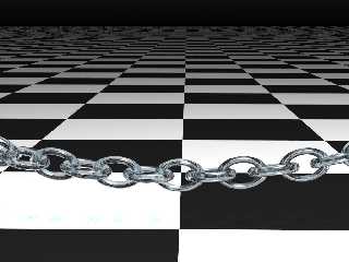

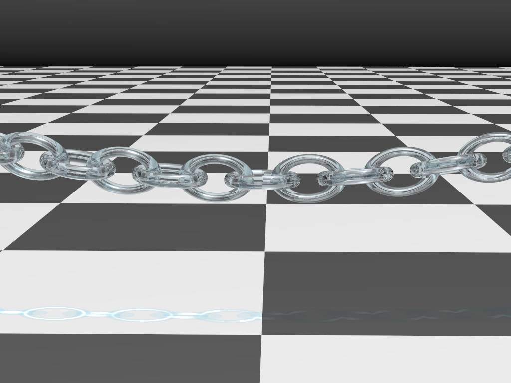

Here's a closeup of a simple glass chain, using the same link as above.
No radiosity, no photons, no dispersion, fake caustics.
Download 'catenarye5k.png' (174 KB)
Preview of image 'catenarye5k.png'
From: scott
Subject: Re: True catenary
Date: 1 Aug 2005 06:51:13
Message: <42edfea1$1@news.povray.org>
> between two points in a uniform gravity field. It looks like a
> parabola, but it's mathematically quite different. The equation of a
>  parabola is just y = a*x*x, a simple quadratic, whereas a catenary is
> "Linc.inc", after referring a new user to it, and was dismayed to
> discover that Chris used quadratics to build his chains. :(
IIRC the "quadratic" chain assumes even weight distribution in the
horizontal direction, whereas the catenary takes account of the fact that a
chain at a steep angle will be heavier per unit horizontal distance.
Clearly the steeper the chain the more of an "error" the quadratic one has.
How about a comparison between the two for different length chains between
two points?

Yes, the parabola is the curve of a suspension bridge with uniform
horizontal load.
> two points?
I've been thinking about doing this, so I'll put something together over the
next day or so. It may be a little bit tricky ensuring both chains are
identical in length... it should be ok if I use very small links, though.
I also want to see the difference between the parabola & catenary with
connection points at unequal heights.
Thanks for your feedback, scott.
Beautiful.
From: PM 2Ring
Date: 1 Aug 2005 09:50:00
Message: <web.42ee24d35de03cff1befe64a0@news.povray.org>

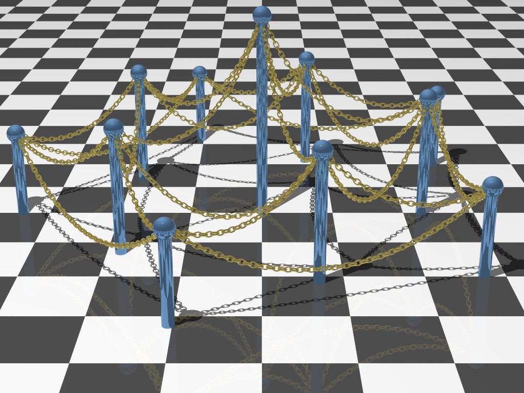

Here are a few positioning macros (and an iron link I borrowed from Chris
Colefax's Link.inc). The attached image is from a slightly different view
location & probably using links of a different size.
// Vers: 3.6
// Desc: Catenaries between multiple poles arranged in polygons
// Date: 2005.07.30
// Auth: PM 2Ring
// -f +A0.4 +AM2 +R1
// -d +A0.2 +AM2 +R4
// -d +A0.1 +AM2 +R3
global_settings {
  assumed_gamma 1.0
  max_trace_level 25
//Textures ----------------------------------------
#declare Shiny =
finish{
  phong .35 phong_size 320
  ambient 0.1 diffuse 0.85 reflection 0.15
#declare TChain =
texture{
  //pigment{rgb 1}
  pigment{rgb <1, .8, .15>}
  finish{Shiny metallic
  diffuse 0.25 brilliance 7 reflection {0.55, .65 metallic}
#declare TTerminal =
texture{
  //pigment{rgb 1}
  finish{
    Shiny
    reflection {0.35,.45 metallic} diffuse 0.4 brilliance 5
//Link objects
#declare Torus1 = torus {.75, .175 scale 0.05*<1, 1, .65> texture{TChain}}
//From LinkObjs.inc by Chris Colefax
#declare Iron_Chain =
union {
  torus {.7, .3 clipped_by {box {<-1, -.3, -1>, <0, .3, 1>}} translate -x *
.....6}
.....6 scale <-1, 1, 1>}
  cylinder {-x*.6, x*.6, .3 translate z * .7}
  cylinder {-x*.6, x*.6, .3 translate -z * .7}
  pigment {rgb <.4, .4, .45>} normal {dents .6 scale .3} finish {phong .3
phong_size 10 metallic}
  scale .035
#end
//#macro ChainQ(Start, End)#end  //No Chains!
union{
  texture{TTerminal}
#end
  Terminal(Start)
  ChainQ(Start, End)
#end
//-Positioning
macros--------------------------------------------------------
//Connect all points in PosList with chain. Terminate if not a ring.
#macro MultiChain(PosList)
  #local N=dimension_size(PosList,1);
  #local I=0;
  #while(I<N-1)
    #local Start = PosList[I];
    #local End = PosList[I+1];
    #local I=I+1;
  #end
  #if(vlength(End-PosList[0]))
    Terminal(End)
  #end
#end
//Connect all points in PosList to a centre post
#macro CenterChain(PosList)
  #local I=0;
  #local End = <0, 1.25*Rad, 0>;
  #while(I<N-1)
    ChainQ(Start, End)
    #local I=I+1;
  #end
  Terminal(End)
#end
//Connect all points in PosList0 to Poslist1, like threading shoelaces. No
error checking!
#macro ThreadChain(PosList0, PosList1)
  #local N=dimension_size(PosList0,1);
  #local I=0;
  #while(I<N)
    #local Start = PosList0[I];
    #local End = PosList1[I];
    ChainQ(Start, End)
    #local Start = PosList0[mod(I+1,N)];
    ChainQ(Start, End)
    #local I=I+1;
  #end
#end
// The scene ----------------------------------------
#declare Rad = 2.25;
//Link object
//#declare Link = Iron_Chain;
#declare Slack=1.35;       // Slackness of the chain
#declare Overlap=1.60;     //Link overlap
#declare PostRad=.05;      //Post radius
#declare MI = 5;           //Polygon sides
#declare InRing = array[MI+1];
#declare OutRing = array[MI+1];
#declare I=0;
#declare DT=pi/MI;
#while (I<=MI)
  #declare T = 2 * pi * I/MI;
  #declare InRing[I] = Rad*<cos(T), 0.75, sin(T)>;
  #declare OutRing[I] = 1.5*Rad*<cos(T+DT), .35, sin(T+DT)>;
  #declare I=I+1;
#end
MultiChain(InRing)
#declare Slack = Slack / 1.1;
CenterChain(InRing)
MultiChain(OutRing)
ThreadChain(InRing, OutRing)
#declare WS = 4*Rad;
3.001*WS}}
...05}finish{Shiny}}
camera {
  location <1, 4.5, -10> * 1.25
  look_at  y*0.50
  angle 30
light_source {<-2, 8, -3>*2 rgb 1}
Download 'catenaryd1.jpg' (170 KB)

From: PM 2Ring
Date: 1 Aug 2005 09:55:00
Message: <web.42ee292d5de03cff1befe64a0@news.povray.org>
"Sebastian H." <van### [at] gmxde> wrote:
> Beautiful.
Thankyou, Sebastian! Now I'll *have* to do one with more realistic glass, or
maybe even diamond. :) I'll have to do it on my machine at work, this old
beast would take days.

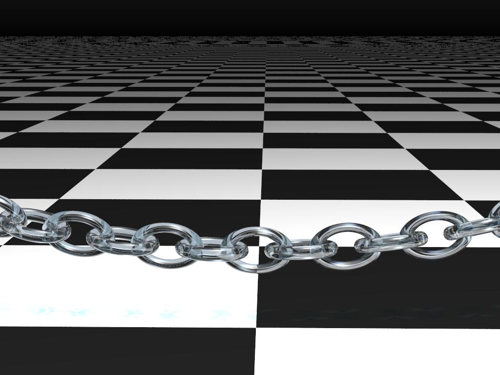

Yes, and catenary arches are very strong, too. Also, a catenary rotated
around the X-axis makes a catenoid, the shape of a soap-film between a pair
of parallel circular loops.
> anyway, neat work. i await the realistic glass render although the fake
> glass looked pretty too :)
Here's a more realistic one, with radiosity & dispersion. I'm doing one now
with photons; I assume it will take all weekend.
Download 'catenaryea1.jpg' (78 KB)
Preview of image 'catenaryea1.jpg'
