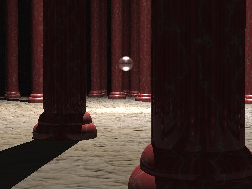

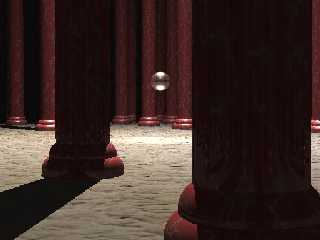

this is my first image, and i want some feedback.
for any WOT fans out there, this is the Stone of Tear, and i will eventually
replace the crystal sphere with a crystal sword.
for anyone else, i just want feedback in general.
Download 'tear.jpg' (36 KB)
Preview of image 'tear.jpg'

First of all: It would be more polite to say "I'd like some feedback"
instead of "I want some feedback". No demands here, please. :-)
Regarding the image itself: the textures, aside the crystal sphere, a really
flat. If the columns should be made of marble or such, I'd suggest some
specular in the finish, and perhaps some reflection, this also applies to
the floor, which is *really* grainy. Either you're using a very small scaled
texture, or the light has some issues, maybe coincident surfaces or such?
A nice beginners image, but normally, a first image on the newsgroups is a
RSOCP-Variant: "Reflective Sphere on Checkered Plane". You'll find hundreds,
if not thousands variations on that on the newsgroups. Once that "test" is
passed, you're free to post. ;-)

Maybe add one or two dim lights with the "shadowless" keyword. Lighting is
very difficult with POV. (For me, anyway...) Also, a spotlight might look
good on your crystal sword, and you'll definitely want to use photons.
Dave
From: Josh
Subject: Re: columned hall w/ crystal sphere
Date: 6 Sep 2004 05:20:28
Message: <413c2bdc$1@news.povray.org>
Good start.
Use an area light to soften the shadows.

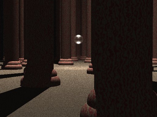

ok, i fixed the problems set forth in the original reply, and i think the
overall effect is really a lot better.
for the grainy, i multiplied the stone texture for the floor by a factor of
1000.
i also made the columns redder (what i always imagined in the books, and i
removed the innermost ring of columns (seemed a little crowded to me)
the sphere(soon to be sword) is, in fact lit by 3 spotlights.  two of which
are something like 150 above the center and one is only 50.
aside from a simple "global_settings {ambient_light 1 }", there is no other
light in the image.
Download 'tear2.jpg' (29 KB)
Preview of image 'tear2.jpg'
other
> light in the image.
Actually, that is just the default setting, IIRC. It's use is for the
ambient-settings in the finishes of the object's texturing. Objects that
aren't directly lit by any actual lightsource would just appear black, and
many a beginner's images would end up being pits of darkness with few
lighted spots. To simulate a very crude ambient lighting, ambient thus
lights up all surfaces, disregarding the actual amount of light or shadow
they get. I hope my phrasing wasn't too complicated, but you can always look
for "ambient" in the documentation.

no, thats ok.
i just assumed that the default ambient setting was 0.
my mistake
