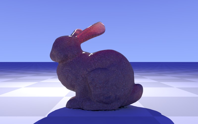

This is what sslt looks like in the Granite_21 macro (beta 1.7). Works
well and/but slow (took >5 hours).
However.
A granite would not look like this. This is more like a granite-textured
kind of pottery. What is missing is the internal structure of minerals,
especially in the ears. I am pondering the problem and think into the
direction of a media, or maybe, a special kind of isosurface (I am
thinking of my rings of Saturn in 2017), or again, a rand_in_object fill
with small particles.
Download 'granite_21_sslt_test.jpg' (43 KB)
Preview of image 'granite_21_sslt_test.jpg'
Wow this looks extremely promising. I think you are on the verge of a major
accomplishment!
I visited a local granite supply store again recently to look more carefully at
real granite. If I may make a humble suggestion relative to the current phase of
your project based on what I saw it would be this: The samples that I observed
that demonstrated SSLT only seemed to have SSLT properties in the veins, or
perhaps certain types of crystals but not others. The same was true of the
"sparkly" and/or iridescent elements. Perchance that condition was unique to the
granite samples that the business happened to have in stock at that time. I have
no idea whether or not a larger set of samples would reveal that that is a
universal rule.
Also, I noticed that some granite is like the Dakota Red as far as scale, for
example a 1" x 1" piece is all you need in order to know what the pattern looks
like. There were some samples with a much larger scale (although the individual
crystals were probably similar in size) and by that I mean that you would need a
much larger piece in order to get an idea of what the pattern looked like. In
some cases a 3- or 4-square-foot or even larger piece would be necessary.
I promise I'm not trying to complicate your project, I'm just mentioning what I
saw.
Kind regards,
Dave Blandston
Suggested motto: "With POV-Ray anything is possible, but nothing is easy"

Op 4-7-2021 om 10:41 schreef Dave Blandston:
> accomplishment!
He he! We are getting there, slowly indeed. ;-)
> universal rule >
Yes, you are absolutely right. The point is indeed that only some of the
minerals composing the rocks are transparent/-lucent. Quartz and
calcite, which form most of the veins, but also some of the more
colourful minerals of the plagioclase class (the pink or grey ones).
Others are perfectly opaque. So, getting this in a (3D) sslt scheme is a
challenge indeed. I have been experimenting with additional filter
values in the vein's colour maps but that is difficult and highly
controversial at the moment.
The 'larvikite' which you showed in another post, the one with those
iridescent minerals, is a special case of 'monzonite'
https://en.wikipedia.org/wiki/Larvikite . It resides at the fringe of
the granite field. It would be a challenge in its own right of course.
Sam Benge has done some perfect modelling of jaspers which would come
close, but I would prefer to concentrate on the 'classic' granites which
are already given enough trouble by themselves ;-).
I can tell that, at the moment, I have five different granites ready,
based on Daniel Mecklenburg's original colour maps: Dakota Red, North
In due time, I shall post them. My philosophy at the moment is that - as
those originals are commercial names and products, possibly not even
'real' granites but also gneisses or other metamorphic rocks - I
transform them to my own understanding into my own 'real' granites,
keeping the name, but differing quite possibly from the original stuff.
With a little utility provided by Bald Eagle, this has been made much
easier now and will be made much easier also for the users themselves
who want to design their own granites (which is all the fun of course).
Yes. I /think/ that the user will be able to play with those pattern
changes and pattern scales, using the provided pigment_pattern mask
arrays, and variations arrays. They are very powerful and subtle means
to model the granite one wants. In fact, each granite can be modelled
into almost an infinity of different variations with only very little
changes to the arrays. I need to expand part of the future documentation
to cover this particularly fascinating aspect of the macro.
I am not finished to be surprised by my own macro indeed. ;-)
> saw.
And rightfully thanked you are. These comments help to hone my own
understanding of the whole process indeed.
Yeah - it's the old "POV-Ray renders _surfaces_ not volumes" problem/trap that i
fall into from time to time.
> and think into the direction of a media,
I think that might lead to an unintentional detour: the pursuit of a PhD in
media
> or maybe, a special kind of isosurface (I am thinking of my rings of Saturn in
2017),
That has potential, as if it were done right, you'd have a lot of separate
surfaces, but then you'd have spaces in between - no idea if that would be
problematic or not.  You'd also have to match up the texture with the isosurface
domains.
> or again, a rand_in_object fill with small particles.
That would be super tricky and take for-ever.
Exposure of the set of points for crackle to SDL, allowing for "one-pass"
placement of "particles" would be what we'd need, and I can still see that as
being "slow" - but probably acceptable to achieve such a difficult effect.
Sam Benge used Voro++, and I'm wondering if maybe there might be an external
library that could generate a Voronoi subdivision of a volume.  Though I don't
like that idea very much.
I've taken several looks at the source code for generating the crackle pattern
over the years, and it's long, somewhat complicated, and would be a project on
its own to convert to SDL.
I'm in favor of the isosurface idea, as it seems to be the fastest, most
reliable, and most direct approach.
> media
2017),
> domains.
I'll ponder a bit more. I have couple of other things/ideas to address
presently.
> RL has me running around doing non-POV-Ray stuff (Damn you, RL!) so I just have
> less time than usual...   :(
Yeah... Often not possible to avoid.
> media
Using SSLT and a scattering/absorbing media that match the texture could
help, but probably not in all cases. That would be the quicker to parse,
and probably also the faster to render.
Subject: Re: SSLT with the Granite_21_beta1.7 macro
Date: 6 Jul 2021 02:18:44
Message: <60e3f5c4$1@news.povray.org>
Op 05/07/2021 om 20:51 schreef Alain Martel:
>> problem/trap that i
>> PhD in
>> media
Thanks for that Alain. I agree and it would probably have my preference.
I seem to remember I did some testing along that line in some distant
past (or even universe)... Shall have to revisit my nooks and crannies
somehow. <sigh>

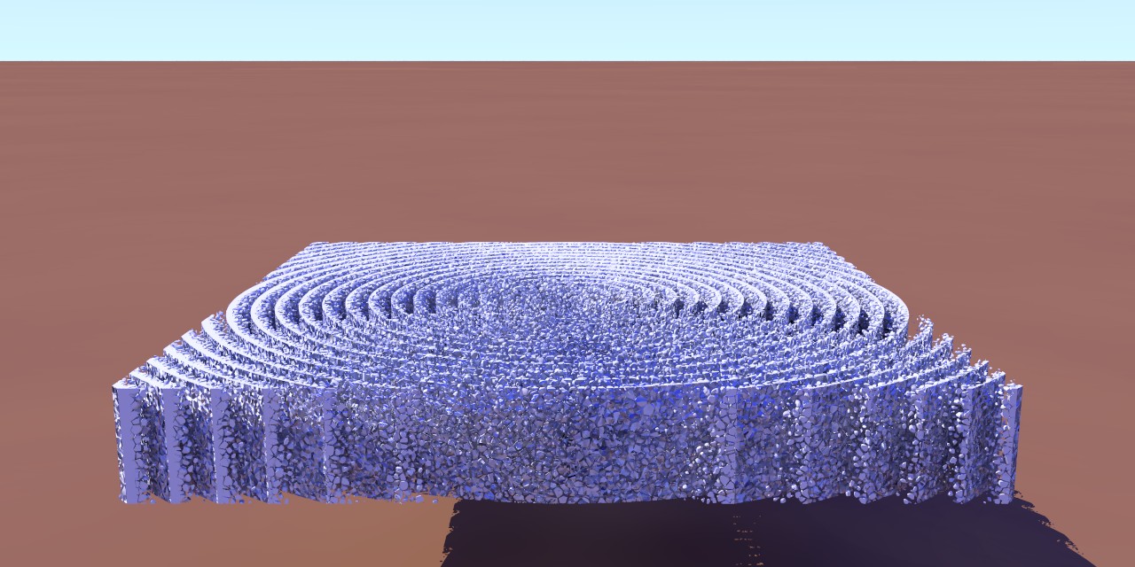

In terms of isosurfaces, I was thinking about something like this.
Download 'isosurface_functions_test-onion_01.jpg' (164 KB)
Preview of image 'isosurface_functions_test-onion_01.jpg'
