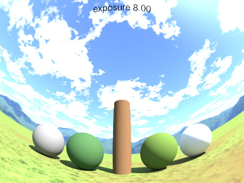

I was curious about how Norbert Kern's light & shadows lighting
environment compares to my 4th prefab render rig's outdoor setting, so I
wrote a couple of scenes to illustrate them.
Image nkern-light+shadows2.jpg uses Norbert's lighting setup, including
his sky, his radiosity setting, and the finish he posted.  The colors
used were:
   Gray sphere:          srgb 0.5
   Green sphere:         CHSV2RGB (<115, 0.65, 0.08>) / 0.6
   Post:                 CHSV2RGB (<23, 0.75, 0.12>) / 0.6
   Yellow-green sphere:  CHSV2RGB (<92, 0.8, 0.12>) / 0.6
   White sphere:         srgb 1
   Brown square:         CHSV2RGB (<23, 0.75, 0.12>) / 0.6
   Green square:         CHSV2RGB (<91, 0.80, 0.18>) / 0.6
I had previously derived the greens and the brown from photographs I
took of grass, leaves, and soil.  I calibrated the colors against 96%
white paper, decreasing the assumed paper luminance very slightly due to
its age.
The rc3-nkern-ltshad-e*-2.jpg images used my 4th prefab render rig.  The
following colors were used, with the diffuse finish values applied
directly to the objects:
   Gray sphere:          srgb 0.5                      diffuse 0.6
   Green sphere:         CHSV2RGB (<115, 0.65, 0.08>)  diffuse 1
   Post:                 CHSV2RGB (<23, 0.75, 0.12>)   diffuse 1
   Yellow-green sphere:  CHSV2RGB (<92, 0.8, 0.12>)    diffuse 1
   White sphere:         srgb 1                        diffuse 0.6
I used these radiosity settings:
   radiosity
   { count 200
     error_bound 0.5
     normal on
     Radiosity_Pretrace (0.8, 2) // posted in p.b.s-f
     recursion_limit 2
In addition, the render rig automatically supplies radiosity { media on
}, because the sky is fog based.
The lighting is not so straightforward, since the render rig creates its
own black box environment, but since I wrote it, I can give some
specifics.  The dirt and grass have these colors with diffuse 1:
   Dirt:   CHSV2RGB (<23, 0.75, 0.12>)
   Grass:  CHSV2RGB (<91, 0.80, 0.18>)
The rig uses rgb <1.038, 0.989, 0.956> for the direct sunlight.  The
sky, disregarding the clouds, contributes about 1/8 the luminance of the
direct sun; this is the best amount I could determine for a Sun at 45°.
(I positioned the Sun at Norbert's 47°, but I haven't gone through the
trouble of programming dynamic sky colors into my render rig, and the 2°
shouldn't make that much difference.)  I did not take aerosols into
account, and I presumed that my sources were measured at low turbidity.
And if you know me, you don't need to ask about the assumed_gamma.
The exposure figure is a multiplier for the sunlight and sky colors.
Since all renders used radiosity with POV-Ray 3.7, any ambient settings
were moot.
As you can see, my sky is considerably lighter than Norbert's, resulting
in lower contrast.  However, Norbert's scene is in a heavily forested
area, which naturally lends itself to dark shadows.  When I look
outside, my instinct tells me that the sky should be lighter than I have
made it, but for the time being, I am trusting scientifically measured
numbers over my non-linear vision.  It should be noted that since blue
is a low luminosity color, that 1/8 figure is lower than the flux ratio.
Download 'nkern-light+shadows2.jpg' (35 KB) Download 'rc3-nkern-ltshad-e1-2.jpg' (51 KB) Download 'rc3-nkern-ltshad-e2-2.jpg' (60 KB) Download 'rc3-nkern-ltshad-e4-2.jpg' (69 KB) Download 'rc3-nkern-ltshad-e8-2.jpg' (66 KB)
Preview of image 'nkern-light+shadows2.jpg'
Preview of image 'rc3-nkern-ltshad-e1-2.jpg'
Preview of image 'rc3-nkern-ltshad-e2-2.jpg'
Preview of image 'rc3-nkern-ltshad-e4-2.jpg'
Preview of image 'rc3-nkern-ltshad-e8-2.jpg'

I like your fourth image with exposure 4.0. It looks like a good summer sky
setting.

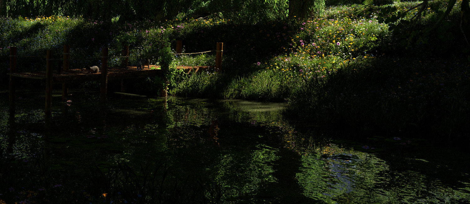

My settings for L&S aren't suitable for naturalistic images.
If I would start from scratch, there would be much more shadows and stronger
lights. Of course then I would increase the sky brightness values too - a bit.
Most textures were tweaked to increase the hue values. So the image is green in
general with blueish shadows. Flowers and animals introduce some colorful spots.

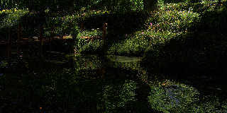

The impression I wanted to generate is something like a glade, with much
stronger contrasts than in reality - like in the part render from a different
perspective.
My personal standard set for sky and light is rather simple -
#declare lights = <-80000,50000,-50000>;
light_source {
        lights,
        color srgb <2.42,2.23,1.87>
sky_sphere {
        pigment {
                function {max (min (y, 1), 0)}
                color_map {
                        [0        srgb <212,221,239>/255]
                        [0.1029   srgb <219,229,244>/255]
                        [0.1512   srgb <233,241,250>/255]
                        [0.1949   srgb <223,239,252>/255]
                        [0.2444   srgb <201,227,252>/255]
                        [0.2921   srgb <180,213,250>/255]
                        [0.3732   srgb <144,180,239>/255]
                        [0.4255   srgb <137,172,235>/255]
                        [0.7067   srgb <97,126,198>/255]
                        [0.774    srgb <92,119,190>/255]
                        [0.8275   srgb <88,114,185>/255]
                        [0.885    srgb <85,111,180>/255]
                        [0.9425   srgb <82,107,175>/255]
                        [1        srgb <79,103,170>/255]
I got the sky values from a photograph and the light values are very old - in
fact I derived them from radiosity newsgroups discussions back in 2000 or 2001
(rgb <1,0.87,0.57>*7 IIRC).
This differs very much from your value - I should take a look in your render
rig...
Norbert

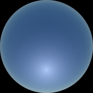

From: Cousin Ricky
Subject: Re: Light & shadows vs. my render rig
Date: 1 May 2020 12:03:24
Message: <5eac484c$1@news.povray.org>
On 2020-05-01 1:12 AM (-4), Norbert Kern wrote:
> I will test your settings - and I've a question - what is the suncolor value at
These are my results, with the direct sunlight normalized to luminance 1
at whitepoint D65:
   rgb <1.301, 0.954, 0.569> (D65)
   rgb <1.106, 0.979, 0.788> (D50)
Note that my calculation doesn't take the Earth's curvature into account
when calculating air mass.  I estimate that it will return horizon
calculus textbooks for 35+ years ago in order to deal with the
atmosphere's density gradient.  I do not know how low the Sun would have
to go before my accuracy suffers.
For completeness, my average sky color is:
   rgb <0.129, 0.208, 0.350> (D65)
   rgb <0.110, 0.213, 0.485> (D50)
Getting from an average sky color to an actual sky is the hardest part.
The sky is lighter towards the horizon, and this adds to the illusion
that the sky is really a light blue.  Just applying the average sky
color as a constant background makes for too dark a sky against the
foreground objects, lending a sense of gloom to the image.  For example,
the fog color I had to use.  To complicate matters even further, the sky
is considerably lighter in the direction of the Sun.  So far, I have
maintained the specified average illuminance only through trial and error.
Attached is output from Scott's sky simulator, which was based on a
SIGGRAPH paper, via Stellarium.  The arguments were ssSunPos2 altitude
Download 'skysim_test-20200501.jpg' (12 KB)
Preview of image 'skysim_test-20200501.jpg'
