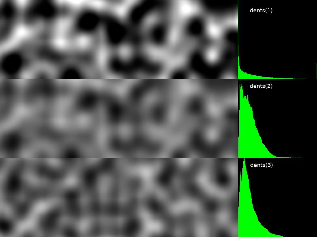

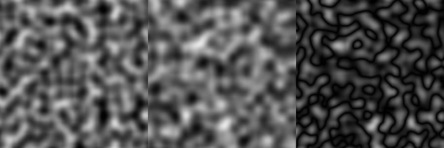

Today, with something like dents, we can be working up a dents based
pattern planning some eventual functional customization - fading the
center portion to 1.0 or whatever. We start with:
#declare Pigm00 = pigment {
     dents  // The render is quicker starting with the pattern dents.
//  function { f_dents(x,y,z)*f_fade(x,y,z) }
     noise_generator 3   // Get the scene's setting - or 2 in demo.
     scale 1/6
In the attached dents_to_f_dents_patNoise3.png the dents / ng(3) is
shown on the left. The function { f_dents...} ng(3), but really (2) is
shown on the middle. And yeah, I think the difference "pattern" between
the two noise generators on the right might be a useful pattern itself...
Not all patterns were updated noise gen 1 to 2.
Patterns like granite were adjusted on the change from noise generator
Skinner form 1 to 2 so they more or less look similar with both. The
dents and f_dents was not one of these and the form 1 version is quite
different.
Aside: I've not run across any pattern making 2 vs Perlin(3) pattern
commonality adjustments.
For many years I wrongly assumed pattern distributions were somewhat
normalized in the 0-1 range so 0-1 maps could more or less be reasonably
switched between patterns. It's not always so. Pattern distributions
differ quite a lot and understanding this is important when best using
them. Be aware of each pattern's value distribution.
To this end I've been thinking about additional pattern related
documentation; The form it might take. See attached
dentsPatternDistDoc.png image for an idea on how this could be done. The
distribution show in green is the linear value distribution for the
dents pattern.
Bill P.
> dents pattern.
I'm still interested in this, especially from a design and implementation
stance.

From: William F Pokorny
Subject: Re: Patterns / functions. Obscure details. Noise etc.

On 4/8/20 2:23 PM, Bald Eagle wrote:
>> dents pattern.
> stance.
> While creating new documentation is a good idea, it's extremely arduous to craft
> language of sufficient breadth and specificity to communicate something as
> complex as a 3D pattern function, especially with all the modifiers.
> We all know that a render if worth 1000 lines of docs, so maybe the step
> preceding any writing would be to illustrate the intent of the documentation
> with scene files/renders/animations that show ranges, variations, and best
> practices.
