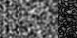

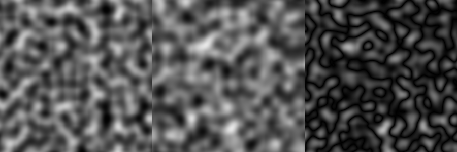

#declare Pigm00 = pigment {
     dents  // The render is quicker starting with the pattern dents.
//  function { f_dents(x,y,z)*f_fade(x,y,z) }
     noise_generator 3   // Get the scene's setting - or 2 in demo.
     scale 1/6
In the attached dents_to_f_dents_patNoise3.png the dents / ng(3) is
shown on the left. The function { f_dents...} ng(3), but really (2) is
shown on the middle. And yeah, I think the difference "pattern" between
the two noise generators on the right might be a useful pattern itself...
Not all patterns were updated noise gen 1 to 2.
Patterns like granite were adjusted on the change from noise generator
Skinner form 1 to 2 so they more or less look similar with both. The
dents and f_dents was not one of these and the form 1 version is quite
different.

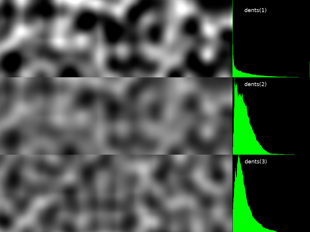

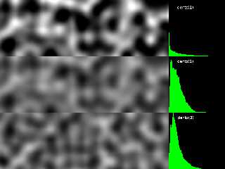

To this end I've been thinking about additional pattern related
documentation; The form it might take. See attached
dentsPatternDistDoc.png image for an idea on how this could be done. The
distribution show in green is the linear value distribution for the
dents pattern.

Download 'dentspatterndistdoc.png' (177 KB) Download 'dents_to_f_dents_patnoise3.png' (120 KB)
Preview of image 'dentspatterndistdoc.png'
Preview of image 'dents_to_f_dents_patnoise3.png'
