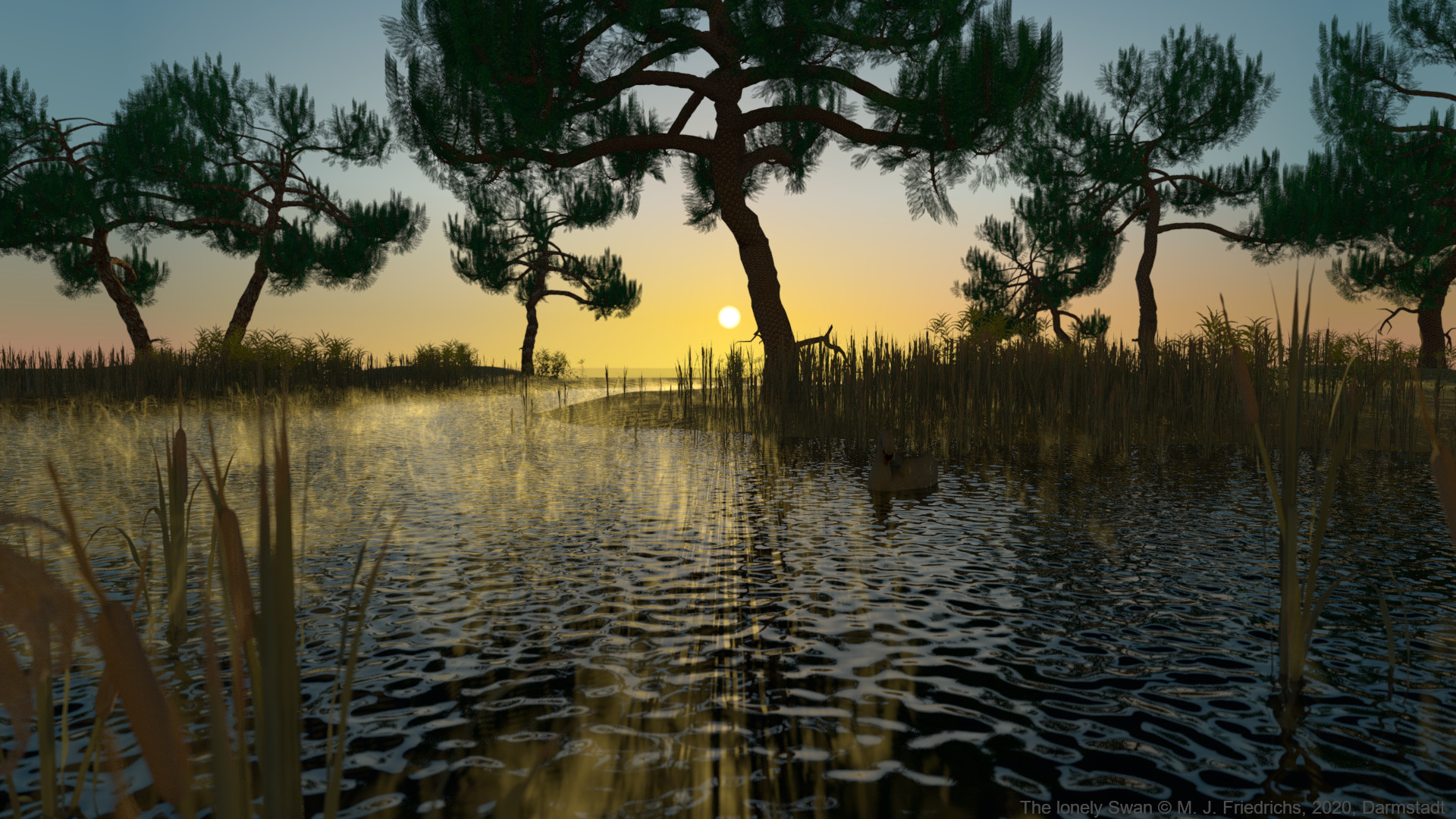

I am beginning to wonder if I understand your problem correctly. It is
the reflection of the Sun's disk on the water surface, isn't it? If so,
this is solved very nicely imo by the finish block of the water and the
finish block only. Jaime uses the following code for his (sea) water
surface:
   finish { // borrowed from Christoph Hormann
     diffuse 0.5
     reflection {
       0.0, 1.0
       fresnel on
       falloff 1
     conserve_energy
     specular 0.8
     roughness 0.0035
The use of this results in the image attached. My earlier suggestion
about Tom York's diffuse modulation works well on opaque surfaces. I
realise now that it would be difficult to implement correctly on a water
surface.
I am sorry if I confused you with information not entirely up to the point.

Hi Thomas,
if you look at the photography from the wikipedia you will notice a very
small area of white reflections from the sun from the horizon to the
middle of the reflections at the sea. But I overlooked that in my image
I have a very different angle (sun and camera are at a very lower level)
between sun and camera. If I lift the camera in this scene from y=1 to
y=10 POV displayed the white reflections at the sea. In my setting they
coinside to happen at the land area. Sorry that I led you on a wrong
track. But many thanks anyway.
Best regards
Michael

Hi to the crowd,
here is the final image of my approach to model steam fog. Having lost
all the code from my first postings here, the image developed into
another direction, but I like it better now. May be it can need a little
bit higher amount of dof, but I will not change this so far. Not to hide
some flaws of the Xfrog trees but for the general mood of the image.
In fact, I have no idea if the images of a sunrise are very different
from the images of a sundown. But if I prefer a certain region of this
planet where this scene could be located and where I observed a similiar
scene several years ago, than it must be a sundown because it was a look
to the west. Close to the atlantic ocean a little bit north to the Dune
of Pilat, France. 1985, I rode a bicycle (crafted by myself and not an
engine) from Paris to Orleans, and then along the Loire and to Bordeaux
finally. I remember similiar scences from this journey.
Since swans like to order their feathers with their beaks, I posed the
swan in wings slightly. It was an unrigged free model I found at
https://free3d.com/3d-model/mute-swan-v1--619725.html
The author used the pseudonym "`printable\_models"'.
All plants were modelled with the trial version of Xfrog. If you work
through their tutorials you can create very realistic plants, but there
are still some flaws (obviously repeated textures exp. leafs).
In this image I used the Goldenrod-tutorial by Xfrog but placed scans
from a rotten one I found in a park nearby as textures. The cattails
(Typha latifolia) and trees (Pinus pinaster, the maritime or cluster
pine) I modelled with Xfrog without much help from them. The lower part
of the stem of the pines I modelled after their tree tutorial.
To have a little bit more light in the foreground I misused radiosity by
putting a great gray wall (colour White/2) 20 units (meters) behind the
camera to have some diffuse reflections against the sun. A white wall
was a little bit to bright IMO.
A very important point was to turn off the media interaction within the
radiosity block. In my first image here - the lost approach from last
year - it was turned on and And asked for a second light source. One
ever learns, and Ands question let to the solutionn of this riddle finally.
Render took 12 days, 17 hours and 25 minutes at an Intel Core i9@3.6 Ghz
using all 16 Threats.
Best regards
Michael
Download '20201020_thelonelyswan.jpg' (658 KB)
Preview of image '20201020_thelonelyswan.jpg'
From: Alain Martel
Subject: Re: Steam Fog: First WIP
Date: 20 Oct 2020 14:39:00
Message: <5f8f2ec4$1@news.povray.org>
Le 2020-10-20 à 13:05, MichaelJF a écrit :
> Am 22.02.2019 um 20:04 schrieb MichaelJF:
>> Hi to the crowd,
>> this image has still a lot of flaws (sun colour and reflections, the
>> swan model itself, textures of the cattails) and may be limitations to
>> media by POV. media seems to be handling color_maps or density_maps
>> different than pigment or texture having no interpolation between the
>> map entries but shap edges. This is what I derived in a first attempt.
>> Rendering time was a little bit longer (3 weeks).
>> Best regards
>> Michael
> Hi to the crowd,
Sun rise tend to have a clearer sky and more ground fog.
Sun set tend to not have any fog, but dirtier sky with more smoke and
air borne dust.
This is definitely a Sun rise.
From: MichaelJF
Date: 20 Oct 2020 15:25:13
Message: <5f8f3999$1@news.povray.org>
Am 20.10.2020 um 20:38 schrieb Alain Martel:
>>> Hi to the crowd,
>>> to media by POV. media seems to be handling color_maps or
>>> density_maps different than pigment or texture having no
>>> interpolation between the map entries but shap edges. This is what I
>>> derived in a first attempt. Rendering time was a little bit longer (3
>>> weeks).
>>> Best regards
>>> Michael
>> Hi to the crowd,
>> similiar scene several years ago, than it must be a sundown because it
>> was a look to the west. Close to the atlantic ocean a little bit north
>> to the Dune of Pilat, France. 1985, I rode a bicycle (crafted by
>> myself and not an engine) from Paris to Orleans, and then along the
>> Loire and to Bordeaux finally. I remember similiar scences from this
>> journey.
> air borne dust.
Thanks and yes, I observed this kind of fog in the morning at the
moselle first.
Best regards
Michael
Date: 21 Oct 2020 02:36:03
Message: <5f8fd6d3@news.povray.org>
Op 20/10/2020 om 19:05 schreef MichaelJF:
>> Hi to the crowd,
>> Best regards
>> Michael
> Hi to the crowd,
> Best regards
> Michael
Good work sir. I like the mood (Sunrise indeed, as Alain already wrote;
It is mainly a question of environmental temperature differences at
start or end of day, I guess)
I very often use a grey wall behind the camera, in addition to
radiosity, especially for these kind of scenes. An old photographer's trick?
The media on/off is something I have also been struggling with. It very
much depends on the kind of output one wants to achieve (in addition to
the quite different render time). I generally prefer the 'off' state.
From: Paolo Gibellini
Date: 21 Oct 2020 03:23:46
Message: <5f8fe202$1@news.povray.org>
MichaelJF wrote on 20/10/2020 19:05:
> Best regards
> Michael
Almost two weeks but well spent: it's an idyllic scene!
Paolo
