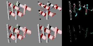

In continuing to look at media I returned to a 'blob-media' issue Gail
Shaw originally posted back in 2005. The bright spots at the very edge
are indeed caused by the 'intersection depth < small_tolerance' or
missed intersection issue as Slime guessed at the time.
However, the sturm result Gail showed never made any sense unless sturm
is broken for blobs. Gail's original belief something changed 3.5 to 3.6
was correct. Optimizations were done involving bounding and polynomial
reformulation for 3.6 which occasionally inhibit 4th to 3rd order
reduction(1). The bright spots not on the edge happen where
Solve_Polynomial passes the original 4th order blob equation to
polysolve and we get bad roots back.
(1) - Happens mostly with transparency.
In the lower left in the attached image I hacked the code to prevent
order reduction with blobs. Surprised to find it looks like blobs only
work as formulated due order reduction - even in v3.5.
All got me digging again into the solver code. Since v1.0 there has been
a regula_falsa function called once the rule of signs stuff has
determined a sub-interval contains a single root. The regula_falsa is
buggy once polynomial order is >= 4 given how many of our polynomials
are formulated - the evaluated values can be very small.
I've coded up a branch modifying the regula_falsa function so it sanity
checks the root found is a real root - within some tolerance - otherwise
it invalidates the root and tosses control back to the interval
bisection code.
Branch fixes this blob issue, the lathe issue #335 from last fall and
many remaining #147 (sphere_sweep) solver issues - except one b_spline /
orthogonal camera case. The patch also fixes or makes better many of the
accuracy issues I have in hand, however, I have too still some scenes
with 'accuracy' issues to dig through. The work is tedious and I need a
break - so putting out the fix I have.
A branch of master with the code update is available at:
https://github.com/wfpokorny/povray/tree/fix/polynomialsolverAccuracy
for those compiling their own POV-Ray versions. I plan to create a pull
request once I've looked at some of the remaining accuracy issues.
Aside: The regula_falsa function isn't strictly needed for root finding,
but the solver runs faster with it than not.
Bill P.

I've run down another type of solver issues related to our sor object.
In this case the problem is with the sor polynomial set up often not
crossing through 0.0 which is a requirement for the sturm / polysolve
methods.
The ray / sor set up sometimes creates sets of coefficients which are
are all positive or negative which sturm / polysolve sees as meaning
there are no roots to find. The fix is to perturb the direction vector
by +EPSILON during the set up which is in my testing enough to get the
crossing 0.0 criteria always.
I started with a sor scene shown in the top row of the attached image
which Severi Salminen posted in 2004. v381 shown on the left and the fix
on the right.
(The remaining three rows show differences at 4x the real magnitude.)
The second row is our shipped sor1 sample scene which doesn't use sturm
at all. I expected no difference, but the 'sturm off', solve_cubic()
function is also failing to find roots on reflected rays which I didn't
previously notice. The +EPSILON change perturbs these noisy solution
regions.
The third row is the same sor1 scene, but with sturm turned on for all
sor objects meaning polysolve gets used. The difference on the right of
row 3 shows how a noisy original solution is cleaned up with the fix.
The last row shows the updated code's solve_cubic solution vs the 'sturm
on' / polysolve solution.  Note that 'sturm on' is needed for clean
roots & a clean sor1.pov image.
Aside: Yes, it's looking like continued rays whether transmitted or
reflected tend to be harder for the solvers to handle. This echoes back
to early lemon issues with noise when the texture had a reflective
component. Also true errors in continued rays are often harder to see
given the contributions are mixed with any ambient or diffuse components.
I've more solver accuracy issues to run down, but I've updated the
branch at:
with this sor polynomial set up fix for those interested.
Bill P.

I've continued to work on the polysolve 'sturm' solver in recent weeks
and another set of updates is available at:
A couple quick notes followed at the bottom by more detailed change and
performance information. With respect especially to sphere_sweeps these
changes fix a number of bad or slightly bad root issues, but do not fix
missing root issues as shown in the attached image.
Another recent revelation has to do with the previous observation
continued rays seem to be more difficult for the sturm solver. There are
two major reasons for this.
One. The regula falsi method, while usually performing better than
bisection and guaranteeing a solution on proper set up, can - with
certain equations - be very, very slow to converge. Our transmitted,
internally reflected and self shadowing test rays all tend to create
polynomials which are a struggle for the regula_falsa() code.
Two. The polysolve code was always set up to jump to regula_falsa() once
it was known only one root existed on a 'ray' interval. The ray types
mentioned previously start with only one root as do rays with respect to
some surfaces. In these situations we do the work to set up the sturm
chain, use it to verify there is just one root - and immediately hand
often difficult to solve equations to regula_falsa() with the original
0.0 to MAX_DISTANCE interval. In these cases we are really using the
regula falsi method.
The changes below re-work things enough so as to be able to eliminate
the previously added sanity check at the end of regula_falsa(). Other
updates in the works.
Bill P.

To better demonstrate attaching two images. In both the left column is
what the current master renders. The remaining columns to the right are
rendered with a float128 version of polysolve to better drive home the
point it our primary need isn't better overall accuracy, but more
accurate root isolation.
In the latheQuadratic.png image the top row is the point set from last
falls lathe issue used in a quadratic spline. The top row is a
perspective camera but zoomed way out and using a camera angle of 2. The
bottom row is the same input except with an orthographic camera set
up(1). In the middle column is what the current patched branch renders
using the SMALL_ENOUGH 1e-10 value. The value has been set so as to
behave well for the orthographic case, but this causes issues for the
perspective case. In the right column SMALL_ENOUGH has been set to
float128's minimum value of 1e-33. This orthographic case falls apart
showing the underlying ill-formed for sign change isolation problem -
while the perspective camera case is OK.
In the sphere_sweeps.png image showing the same progression(2) in
columns 1-3 but in column 4 we dial in a higher SMALL_ENOUGH value which
prunes off just the right about of the sturm chain for the root
isolation to work well.
I'm busy with real life for a while starting later today, but I think we
likely have a path to cleaner renders in these fringe cases given our
sturm chain based method.
We're working in a ray tracer and it is the ray's dx,dy,dz going to zero
which primarily causes the ill-formed for sign base root isolation
issue. We'll need to detect problem directions in the object's code and
create some calculation(3) which we'd pass all the way into the modp()
pruning. Possible I think.
Bill P.
(1) - It's not just the orthographic camera which tends to pull out the
worst case solver issues. Shadow rays with cylindrical and parallel
lights too. There are too the occasional rays which line up orthogonally
in one or compound dimensions.
(2) - Except running with jitter off. Our AA implementations are grid
based which unfortunately tends to line up with the compound (diagonal
type) missing root issues. Thinking something like a Halton sequence
based AA never keeping the center pixel might really help in these cases
by getting the samples more often off the problem ray / surface
grid-axis alignments.
(3) - Perhaps coupled with some ability for users to apply a multiplier
from the SDL?
Download 'lathequadratic.png' (17 KB) Download 'sphere_sweeps.png' (63 KB)
Preview of image 'lathequadratic.png'
Preview of image 'sphere_sweeps.png'

shape.
The blobs were a different story. Many rays are being re-directed to
sturm / polysolve for no benefit given the current solve_quartic code.
To oblivion with that code you all say!
I thought the same, but remembered we have known blob accuracy issues in
https://github.com/POV-Ray/povray/issues/187, maybe half a dozen related
problem scenes in my test space. Plus to support the subsurface feature
Chrisoph added this bit of code in blob.cpp to avoid visible seams:
   DBL depthTolerance = (ray.IsSubsurfaceRay()? 0 : DEPTH_TOLERANCE);
I've been running with DEPTH_TOLERANCE at 1e-4 for a long time in my
personal version of POV-Ray which fixes all the blob accuracy issues
except for the subsurface one.
Given difficult_coeffs() is almost exclusively active with blobs,
updated blob.cpp to run with accuracy addressing the issues in the
previous paragraph. With this update in place, we do occasionally see
cases where the bump into to sturm / polysolve method is necessary.
However, the automatic difficult_coeffs() method doesn't currently catch
all of the fringe case rays.
It could be adjusted so as to push more solve_quartic rays into sturm /
polysolve, but it's aleady the case most difficult-coefficient rays are
unnecessarily run in sturm / polysolve when solve_quartic would work
just fine. The right thing to do is let users decide when to use 'sturm'
and this set of commit dumps the difficult_coeffs() code.
Examples.
The attached image is a scene originally created to explore default
texturing related to negative blobs, but it demonstrates nicely the
issues described above.
In the top row we have on the left the image rendered with the blob
accuracy unmodified and all the difficult_coeffs() code running as it
does today. In the middle image the 'if difficult_coeffs()' test has
been hard coded to return no roots. On the right the difference image
shows all the rays running in the sturm / polysolve method which all run
fine - and faster given the blob set up - with solve_quartic().
In the second row we are running with the new more accurate blob.cpp.
Further, the blobs in the scene have been changed to have a threshold of
0.001 instead of 0.1 - values this low are not common because you don't
get much blobbing.
The first column of the second row was rendered with a version of
POV-Ray compiled to always force the use of solve_quartic(). The middle
column restores the 'if difficult_coeffs()' test and internal swap to
sturm / polysolve. It does help as shown in column 3. However column 2
shows the already too aggressive use of sturm / polysolve with blobs is
not enough to automatically 'fix' all the solve_quartic issues. Running
with sturm is clean in all cases.
Aside: The potentials as glows image I did sometime back had what I
thought were media related speckles. I applied very aggressive and
expensive AA to hide them as I usually do with media. Turns out using
sturm would have been the better choice. I wanted no blobbing for the
blob cylinders and used a threshold of 1e-5. It was a case of outrunning
the effectiveness of the 'if difficult_coeffs() patch' with existing
blob accuracy, but I didn't realize it at the time.
Updates at:
Performance and specific commit details below.
Bill P.
Performance info:
------------ /usr/bin/time povray -j -wt1 -fn -p -d -c lemonSturm.pov
0)  master    30.22user 0.04system 0:30.89elapsed
10) 0f6afcc   14.77user 0.02system 0:15.36elapsed  -51.13%
11) 0f9509b   14.77user 0.01system 0:15.36elapsed
12) c590c0e   15.08user 0.01system 0:15.71elapsed   +2.10%
13) 4ab17df   14.88user 0.02system 0:15.51elapsed   -1.33%  -50.76%
14) 78e664c   --- NA ---
15) 5d8cedc   --- NA ---
16) 21387e2   --- NA ---
---- povray subsurface.pov -p +wt2 -j -d -c -fn
master  sturm on       540.89user 0.06system 4:31.15elapsed
21387e2 sturm on       347.29user 0.07system 2:54.42elapsed  -35.79%
master  sturm off      286.99user 0.06system 2:24.28elapsed
21387e2 sturm off      278.54user 0.05system 2:20.12elapsed   -2.94%
If blob container needs sturm.  278.54 -> 347.29  +24.68%
11) Changing polysolve visible_roots and numchanges zero test to <=0.
Depending upon value used for reducing and trimming the sturm chain
equations in modp, the sphere_sweep b_spline functions can return
negative root counts when there are no roots.
12) Adding sanity test of upper bound Cauchy method result.
In practice have occasionally found roots slightly above upper bound.
Perhaps related to how sturm chain is tweaked during pruning. Sort it later.
13) Removing pointless operations in polysolve and Solve_Polynomial.
visible_roots() passed a couple integer pointers which it set prior to
return but the values were never used in polysolve itself.
When fourth order equations seen a test call to difficult_coeffs() was
made which if true would set sturm true - even when sturm was already true.
14) Updating blob accuracy so better synchronized with other shapes.
Fix for GitHub issue #187
Returned minimum intersection depths now set to MIN_ISECT_DEPTH.
Internal determine_influences() intersect_<sub-element> functions using
 >0.0 as was already the subsurface feature. Anything more opens up gaps
or jumps where the sub-element density influences are added too late or
dropped too earlier. The change does create ray equations slighly more
difficult to solve which was likely the reason for the original,
largish, v1.0 1e-2 value. The sturm / polysolve solver is sometimes
necessary over solve_quartic().
15) Removing difficult_coeffs() and related code in Solve_Polynomial().
Code not completely effective where sturm / polysolve needed and very
costly in most scenes with 4th order equations due use of sturm over
solve_quartic() where solver_quartic works fine and is much faster.
16) Reversing change to sor.cpp as unneeded with updated polysolve().
Not verified, but suspect bump made in commit 3f2e1a9 to get sign change
was previously needed where regula_falsa() handed single root problem
with 0 to MAX_DISTANCE range. In any case, the patch is no longer needed
with updated polysolve() code.
Download 'storydifficultcoeff.png' (110 KB)
Preview of image 'storydifficultcoeff.png'
