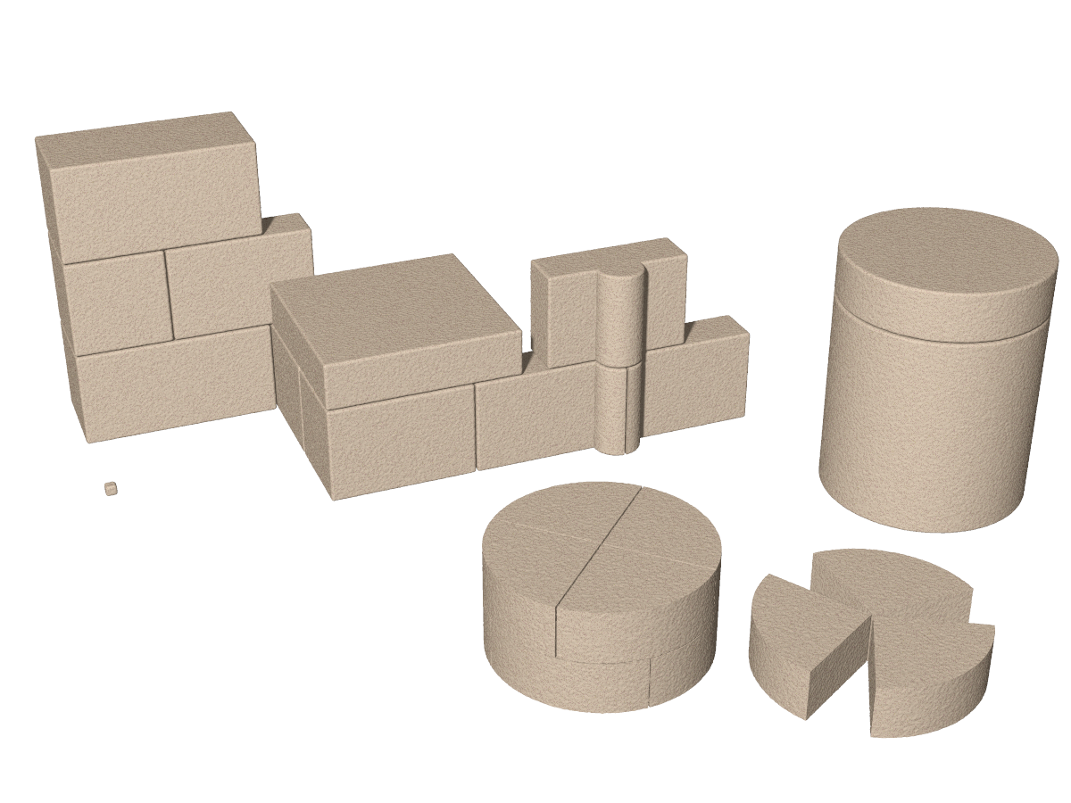

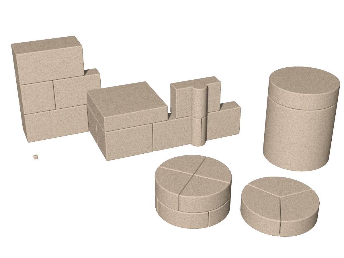

I have macros for rounded_box, rounded_cylinder, and
rounded_cylinder_section, for both CSG and isosurface.
I need help with the rounded_cylinder_section, isosurface.
I only need from >0 to 180 degrees sections
(I know this has no rounding yet)
How do I make my second cut at an angle?  Hints?
isosurface{
  function {
   max(
    sqrt(pow(x,2)+pow(z,2))-Radius+Block_gap,
    abs(y-Height/2)-Height/2+Block_gap,  // cylinder height
    abs(z-Radius/2)-Radius/2+Block_gap,  // my reference edge
    abs(x-Radius/2)-Radius/2+Block_gap   // wrong except for 90 degrees
   +Block_surface_iso_noise(x,y,z)
  contained_by { box { <-Radius,0,-Radius>, <Radius,Height,Radius> } }
The bottom right of the second image wants to be 120 degrees each.
Stephen S
Download 'stone_blocks_csg.png' (733 KB) Download 'stone_blocks_isosurface.png' (776 KB)
Preview of image 'stone_blocks_csg.png'
Preview of image 'stone_blocks_isosurface.png'

From: StephenS
Subject: Re: Rounded block section, isosurface equivalent
Date: 6 Sep 2016 21:56:41
Message: <57cf73d9@news.povray.org>
And now rounded_cylinder_arc_section.
Except there's no rounding. Large radius, small radius, flat surface is
more math than I can remember.
I might only need the large/small radius to match. I should be able to
figure that out.
This is for CSG.
Stephen S
