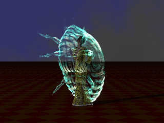

On another thread I was discussing the book Dahlgren with Thomas.
This is my first attempt at making a light projector. It projects a 3D
image of a large insect around who is wearing it.
I used a df3 density file that I made from a Poser model of a scarab.
Then put it in a emitting media container.
Comments welcome.
Regards
     Stephen
Download 'a02g5_0000.jpg' (152 KB)
Preview of image 'a02g5_0000.jpg'

That is how I imagined it to be. Well done indeed.

Yup, very good work.
I cant comment much though, because I rarely mess with the tricky lights and
material stuff. /A

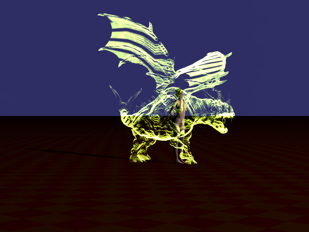

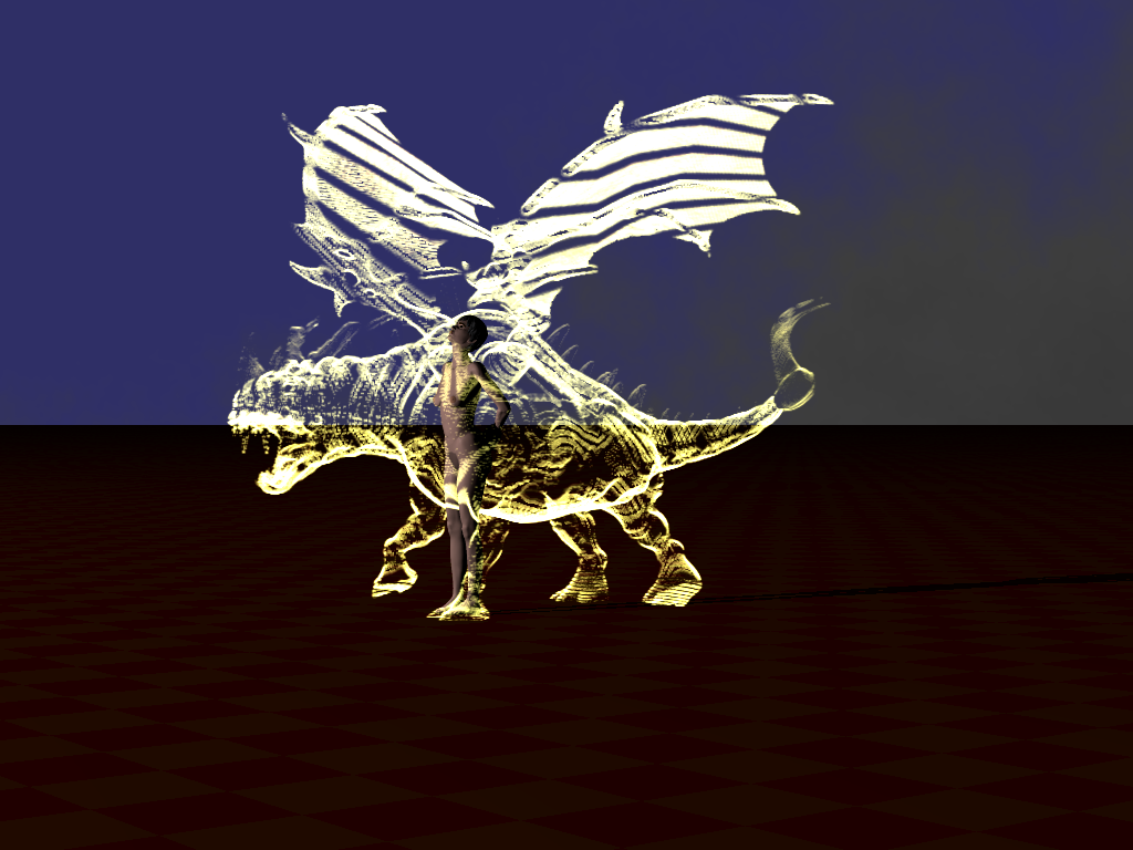

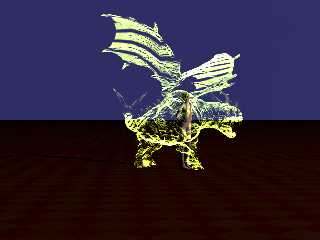

From: Stephen
Subject: Re: A Dahlgren Projector.
Date: 2 Aug 2016 15:34:24
Message: <57a0f5c0@news.povray.org>
On 7/30/2016 10:57 AM, Stephen wrote:
> Thanks, I am quite pleased how it turned out.
I'm not so pleased with the Dragon Lady.
This is the best I could do with this model. I can't get rid of the
stripes. :(
Two days, 19 df3s and umpteen gigabytes later.
But then the books said.
"They were, he realized, as eye-unsettling as pictures on a
three-dimensional postcard—with the same striatums hanging, like a
screen, just before, or was it just behind them."
Regards
     Stephen
Download 'b01a01_0000.png' (267 KB) Download 'b01a01_a2_0000.png' (353 KB)
Preview of image 'b01a01_0000.png'
Preview of image 'b01a01_a2_0000.png'
Date: 3 Aug 2016 02:51:53
Message: <57a19489$1@news.povray.org>
> stripes. :(
I am a bit puzzled by the stripes and not sure what might generate them.
I suppose you have tried subdividing the model further before generating
the df3? It has been a while since I did this exercise...
On the other hand, the book is clear indeed about this so it is acceptable.
From: Stephen
Date: 3 Aug 2016 06:52:07
Message: <57a1ccd7$1@news.povray.org>
There are two types. One caused by the sectioning of the model. The
others look like gaps.
No I've not. The obj file itself is 12k in size and has 78000 vertexes
and 144500 faces.
I am rendering the TGAs at 512 by 512 with 512 slices. I will try
reducing the number if slices to see if that makes any difference.
It is irritating that PovRay takes about 14 seconds to do a save.
For 1975 when the book was published. I would like to do better if I can.
I have a couple of other dragons I can try but they are all thin.
Regards
     Stephen

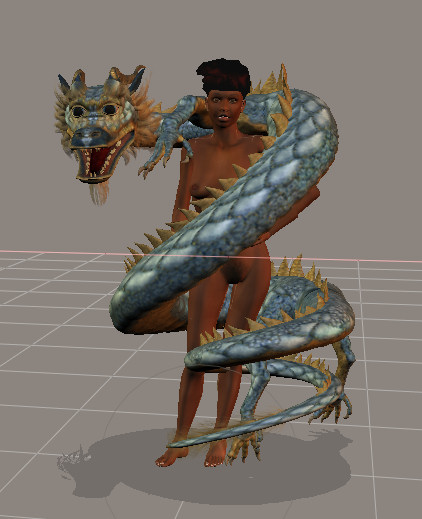

We will need to check compatibility of the media.
I have everything in one big file. (That is how B3D works.) When I am
satisfied it's as good as I can get it I will split it into include files.
I am posing a Chinese Dragon to see how that behaves.
Regards
     Stephen
Download 'd_lady.jpg' (55 KB)
